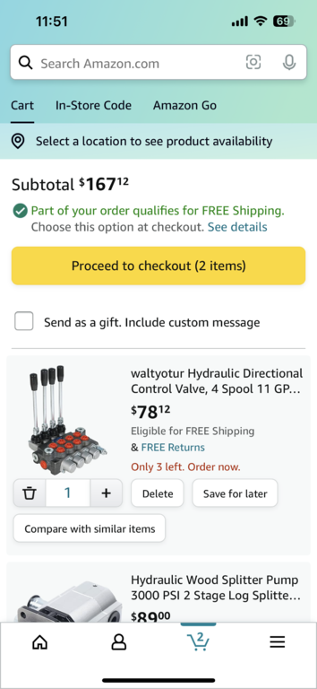

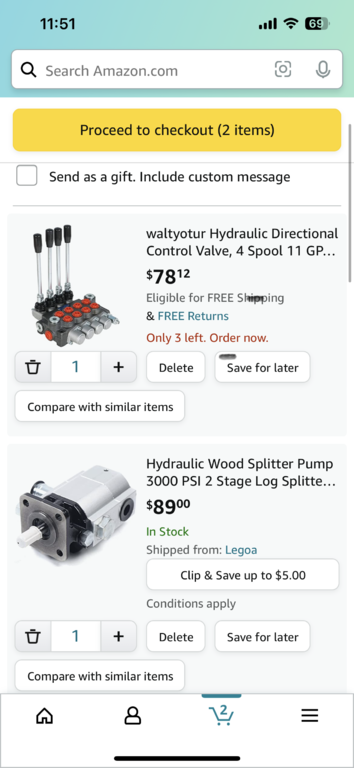

ilovemy1974b80 28 #1 Posted April 12, 2023 I would like to add a hydraulic pump and spool these are the ones I was looking at would they work together 1 Share this post Link to post Share on other sites
RED-Z06 2,718 #2 Posted April 12, 2023 Whats the pump flow rate, what's the goal as far as the implement... Share this post Link to post Share on other sites
kpinnc 18,740 #3 Posted April 12, 2023 Also another thing to think about: if you're thinking of using on a Wheel Horse, be sure the pump is rated for side loads. Most pumps these days are designed to run direct drive with a lovejoy connector, and don't have bearing support on the main shaft. They will wear and fail quickly if they aren't made to stand up to belt drive. 2 1 Share this post Link to post Share on other sites
ilovemy1974b80 28 #4 Posted April 12, 2023 Ok the pump is a 13 gpm do you have any recommendations for a pump that would run a loader and a 3pt 1 Share this post Link to post Share on other sites
Pullstart 70,676 #5 Posted April 12, 2023 Do you plan to build the loader and three point? If so, it would be a great idea to research what others have used, how, why, etc. GPM is great. Pressure is great. Cylinder sizes you choose may vary in what needs to be delivered, etc. The bigger the cylinder in diameter, the more lifting power they typically have but require more flow. 2 Share this post Link to post Share on other sites
RED-Z06 2,718 #6 Posted April 12, 2023 A deere 4X5 series ran a loader, the hydraulic pump was rated at 4.6gpm @ 1100psi. 1 Share this post Link to post Share on other sites

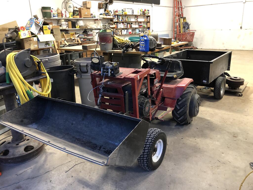

ilovemy1974b80 28 #13 Posted April 12, 2023 This is what I have right now and as long as I’m moving I can kinda steer 1 Share this post Link to post Share on other sites

wallfish 20,219 #15 Posted April 13, 2023 Like everything else, pumps are getting expensive. This was probably about $120 when I built the hoe but $250 now. https://www.northerntool.com/products/concentric-high-pressure-hydraulic-gear-pump-0-517-cu-in-model-g1232c5a300n00-10567 Can you post some pics of that setup from behind the bucket? Money might be better spent on a hydro tractor to put it on A 2 stage pump, like for a log splitter, will pump fast on the first stage until the load is on then 2nd stage has the power so probably not a good idea because you won't have much control when it's moving to fast without a load. I guess you could restrict the flow to slow that down 1 Share this post Link to post Share on other sites
