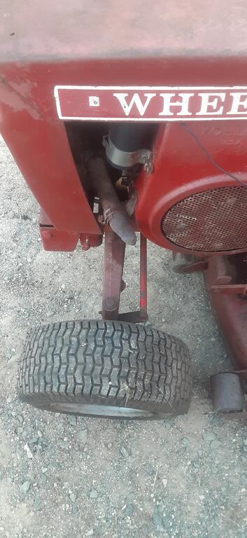

Oldskool 6,679 #56 Posted April 13, 2023 Not getting alot done but making headway just the same. The tierod ends have been peened in to take up the slop. Now I'm rolling AND steering. My next big hurdle is to get it to turn over using the key switch. Haven't found the power loss yet. I have run jumper wires, cleaned the points and had it kick and start with a squirter and no carb. 3 Share this post Link to post Share on other sites

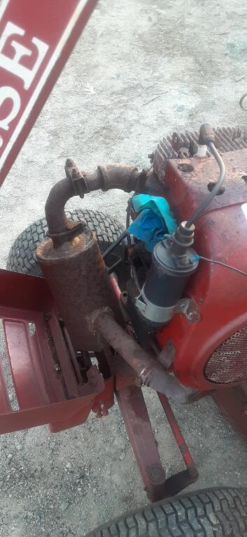

Oldskool 6,679 #57 Posted April 13, 2023 Also curious if this is the original routing for the Nelson muffler. 1 Share this post Link to post Share on other sites
ebinmaine 81,288 #58 Posted April 14, 2023 1 hour ago, Oldskool said: Also curious if this is the original routing for the Nelson muffler. Mike measure the outer diameter of the can on that muffler. Looks a little bit big ((??)) See if it's over 3" or under. Should be under. No it's not routed quite right. Should be no connection to the engine near the outlet end. If it's the larger muffler it won't set quite right in there and will burn the paint. I have a smaller one I'd send up but you'll need to touch up the inlet. It's otherwise solid. 1 Share this post Link to post Share on other sites
Oldskool 6,679 #59 Posted April 14, 2023 7 minutes ago, ebinmaine said: Mike measure the outer diameter of the can on that muffler. Looks a little bit big ((??)) See if it's over 3" or under. Should be under. No it's not routed quite right. Should be no connection to the engine near the outlet end. If it's the larger muffler it won't set quite right in there and will burn the paint. I have a smaller one I'd send up but you'll need to touch up the inlet. It's otherwise solid. I'm thinking it seems a bit bigger then 3in. I didn't think it should have been mounted to the flywheel housing. Any pics of an original mounting position? Share this post Link to post Share on other sites
ebinmaine 81,288 #60 Posted April 14, 2023 8 minutes ago, Oldskool said: I'm thinking it seems a bit bigger then 3in. I didn't think it should have been mounted to the flywheel housing. Any pics of an original mounting position? None of my 3 with a Kohler have it in place anymore. One's a stack. One's a side mount Gravely style. The other has no engine in it but it too was wrong. It's a VERY popular conversion to install the later style muffler off a 78 or 80 up on the older tractors. Maybe the older ones were NLA? Maybe just bad play. Dunno. Some folks use em and they seem ok. I've had several go through our shop and ALL had the paint burned on the hood near it. Share this post Link to post Share on other sites
ebinmaine 81,288 #61 Posted April 14, 2023 15 minutes ago, Oldskool said: I'm thinking it seems a bit bigger then 3in. I didn't think it should have been mounted to the flywheel housing. Any pics of an original mounting position? Here a link to my C160 Tecumsehorse thread. It shows a vague side pic. Best I got here. 1 Share this post Link to post Share on other sites
Oldskool 6,679 #62 Posted April 14, 2023 @ebinmaine I see what you mean. I'll check it out tomorrow after work. Thanks 1 Share this post Link to post Share on other sites
ebinmaine 81,288 #63 Posted April 14, 2023 7 hours ago, Oldskool said: @ebinmaine I see what you mean. I'll check it out tomorrow after work. Thanks I can comparison pics after work. Show you the physical difference. 1 Share this post Link to post Share on other sites
Oldskool 6,679 #64 Posted April 14, 2023 1 hour ago, ebinmaine said: I can comparison pics after work. Show you the physical difference. I couldn't wait till after work to measure mine. Mine is 4in. 1 Share this post Link to post Share on other sites
ebinmaine 81,288 #65 Posted April 14, 2023 12 minutes ago, Oldskool said: I couldn't wait till after work to measure mine. Mine is 4in. Yeah that's definitely the larger of the two. I know they fit black hoods and maybe black fronts too. 1 Share this post Link to post Share on other sites

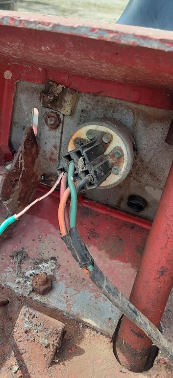

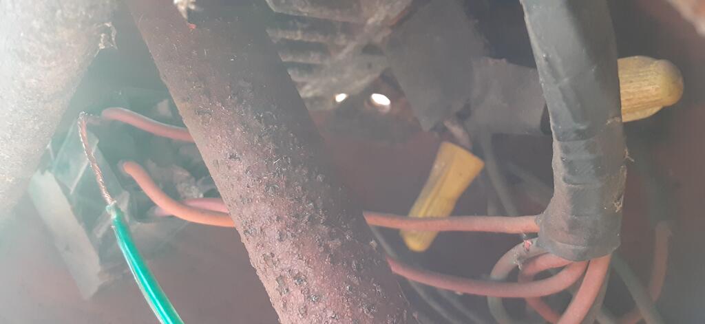

Oldskool 6,679 #68 Posted April 15, 2023 Ok guys. I've been cleaning and testing most of the electrical components. The starter works The switch seems to work. Solenoid excites by jumper wire. Coil and points fire. I'm thinking I'm having a safety switch issue. The seat is unplugged. The clutch switch wires are cut off and it's rusted. The pto is disengaged but the switch is plugged in. I'm not sure where to go next. 1 Share this post Link to post Share on other sites
ebinmaine 81,288 #69 Posted April 15, 2023 Now's the time to simplify your thinking process. Get your test light out. Start at the ignition switch. Look for power IN. If good time the switch and using the diagram Trina sent look for power OUT at the appropriate terminal (s). The wire that feeds the solenoid has to go through the safety switches first of course. I can't tell you what order because my tractors have no safeties. Follow the wire that's labeled S at the back of the ignition switch. Whatever switch that goes to see if it has power at THAT switch going IN. If not it's a broken wire. If yes see if you can see where it comes OUT of that switch. Repeat. Repeat. 1 Share this post Link to post Share on other sites
Oldskool 6,679 #70 Posted April 15, 2023 Oh I've been test and conductivitying lol. I think I found to issue now. If I run a jumper from the red wire on the switch to the red wire on the pto stitch it turns over and I have fire. Does that red wire run to anything else first that I'm not seeing? Is there a fuse hidden somewhere? Share this post Link to post Share on other sites
ebinmaine 81,288 #71 Posted April 15, 2023 I don't believe there's a fuse. @953 nut can you confirm? Mike can you physically trace that red wire from ignition switch to PTO to what used to be the clutch switch? I do realize there is a fair amount of wire in a covering or taped. 1 1 Share this post Link to post Share on other sites
Oldskool 6,679 #72 Posted April 15, 2023 1 hour ago, ebinmaine said: I don't believe there's a fuse. @953 nut can you confirm? Mike can you physically trace that red wire from ignition switch to PTO to what used to be the clutch switch? I do realize there is a fair amount of wire in a covering or taped. I chased it around. I did not see anything for a fuse. Alot of wire in a little space. I replaced that wire. I think I'm good to go. Next is the fuel system and trying to free up the brake pedal. 1 1 Share this post Link to post Share on other sites
ebinmaine 81,288 #73 Posted April 15, 2023 27 minutes ago, Oldskool said: I chased it around. I did not see anything for a fuse. Alot of wire in a little space. I replaced that wire. I think I'm good to go. Next is the fuel system and trying to free up the brake pedal. Progress !! 1 1 Share this post Link to post Share on other sites
