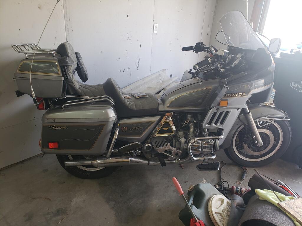

squonk 48,209 #34 Posted April 8, 2023 I haven't ridden since 2014 when I had knee and ticker issues. but my ride was an 83 Honda Goldwing 1100 Aspencade. We used to go down to Pa and hit the Wellsboro diner for a piece of pie and coffee then cruise Rt. 6 and Stop at Larry's Harley Davidson. The sales people would come running out and want to know who had the GW so they could try to sell him a bike. I used to laugh at them until they ran back into there cubbie holes! I don't have any pics anymore but it was identical to this one. 4 Share this post Link to post Share on other sites
wallfish 20,653 #35 Posted April 8, 2023 Since we flew off topic here's the tractor parts scooter (shameless plug to post another pic) 1 4 2 1 Share this post Link to post Share on other sites
HyperPete 939 #36 Posted April 8, 2023 (edited) 1 hour ago, squonk said: I haven't ridden since 2014 when I had knee and ticker issues. but my ride was an 83 Honda Goldwing 1100 Aspencade. We used to go down to Pa and hit the Wellsboro diner for a piece of pie and coffee then cruise Rt. 6 and Stop at Larry's Harley Davidson. The sales people would come running out and want to know who had the GW so they could try to sell him a bike. I used to laugh at them until they ran back into there cubbie holes! I don't have any pics anymore but it was identical to this one. I *JUST* sold my '83 Aspencade - same 2 tone gray as well. Edited April 8, 2023 by Pete D 1 Share this post Link to post Share on other sites

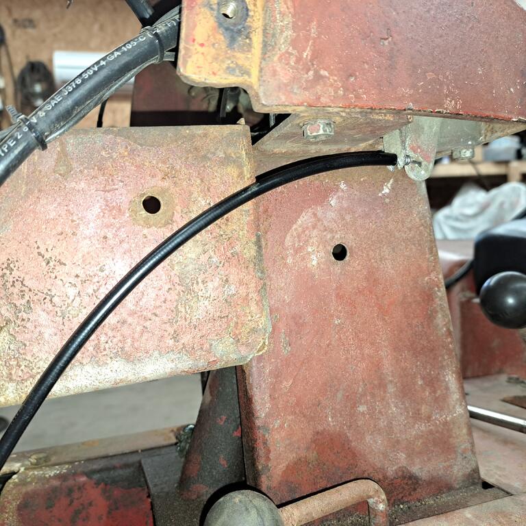

HyperPete 939 #37 Posted April 8, 2023 (edited) I lightly power washed the tractor and began eval & repairs today. Inoperative choke is, as expected, a cable. I tried to find one today with no luck. (Even a universal will work.) Monday I'll go to my local Toro dealer and see if they can find something close, or I'll buy a universal cable. There are bolts and screws missing EVERYWHERE. The headlight plastic lens is broken and part of it is missing. It doesn't look like the trans filter has been changed in years, but the fluid looks new. Oil looks new. I replaced the battery with a U1, (and read the thread about a something NF or a BCI21 being the correct sized battery for the large tray.) I'll wedge it with some wood and live with it. Replaced most of the fuel line and filter, but I can't get the hose clamps off the hose under the dash. Maybe tomorrow. Pulled out the fuel filter marked "Russian Federation" and replaced it with a Stens I had for my Cub Cadet I added ethanol free gas with Techron fuel system cleaner to make sure the carb is clean. I guess I should at least drop the carb bowl to inspect & clean it; I see no need to clean or rebuild the carb. Needs a paper air filter element; can someone help me with a part# for a compatable filter so I can order one online? Thanks in advance. I need to grease everything & change the fluids and the (wix) filter. Ordered a new sparkplug. Need to replace the ignition wire, got zapped when my hand was close. I want to clean all the hydraulic pistons and ensure the surrounding areas are clean so I can watch for leaks. I'm not about to power wash anywhere near the seals. There was a little hydraulic fluid near the controls, I cleaned that area so I can watch for the leak. Still need to diagnose a locked up (off) parking brake and adjust the brake. The hydro jumps if I don't ease slowly into forward or reverse. I presume that's another adjustment. More to read. Previous owner mounted some LED driving lights and I want to clean up that installation. LF tire leaks and needs a tube. The underside is still very greasy, I have to figure out how I want to clean that up. It will be a working machine, so I don't need everything perfect, just functional, adjusted, and assembled properly. Edited April 8, 2023 by Pete D 1 Share this post Link to post Share on other sites
WHX?? 58,294 #38 Posted April 8, 2023 You should be able to rebuild that choke cable. For sure if the cable is pinched in a notched clamp at the lever. You will need these tho. Sheath and inner wire. A Z bend pliers might be handy too. 2 Share this post Link to post Share on other sites
HyperPete 939 #39 Posted April 8, 2023 The sheath is completely rubbed through to the inner wire creating 2 pieces of sheath. It's done. Share this post Link to post Share on other sites
WHX?? 58,294 #40 Posted April 8, 2023 Yep the stuff I listed above comes in big rolls, enough to do 30 tractors and if it were mine I would offer to send you some. Maybe if @Achto ain't lookin. Sheath has a inner core of nylon and slicker than cat crap on linoleum. Best operating choke or throttle I have seen. 3 1 Share this post Link to post Share on other sites
HyperPete 939 #41 Posted April 8, 2023 (edited) Sounds like good stuff, far better than what I'll likely end up with. I've never heard of z bend pliers - small engine specialty I'll bet. I'll Google theM. EDIT: More than I want to spend for the few times I'll use them. A couple of needle nose pliers work for me. Something like this should work for a replacement choke cable, or maybe I will rob one from one of the mowers I am going to flip. https://www.ebay.com/itm/28491945927 Edited April 9, 2023 by Pete D 1 Share this post Link to post Share on other sites
