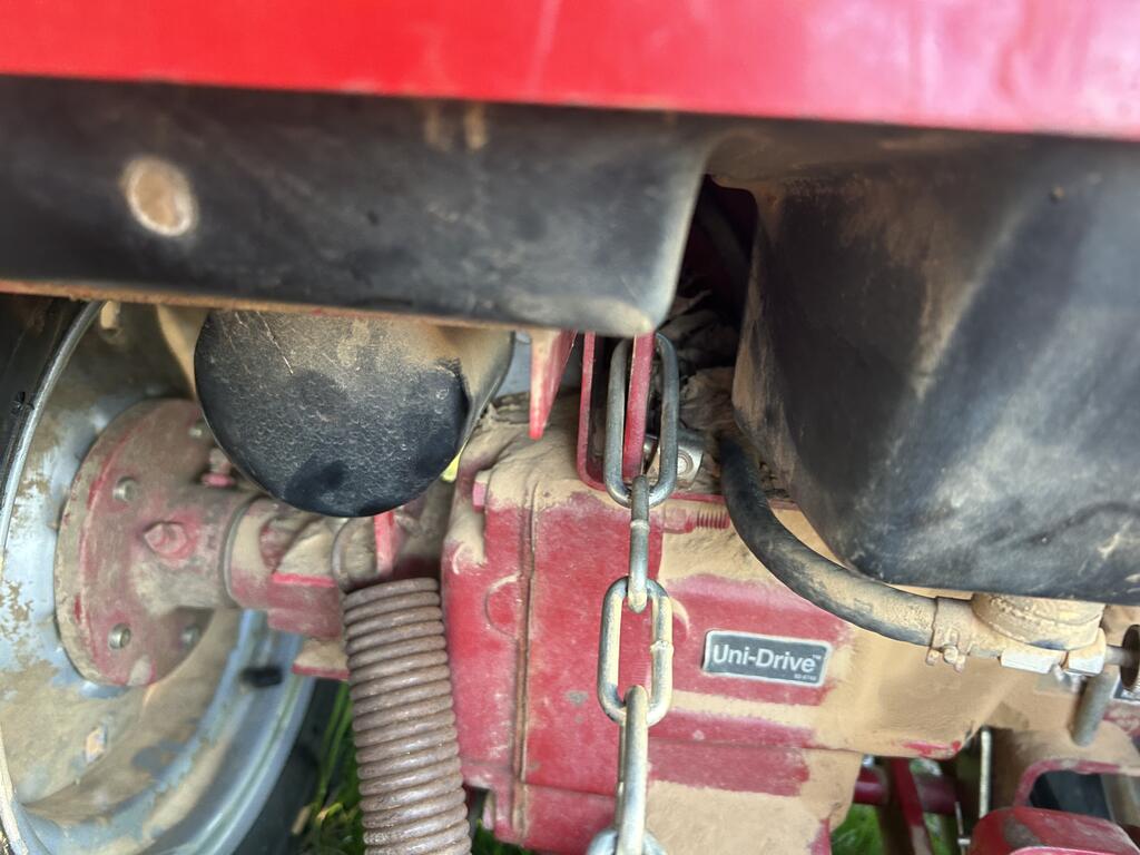

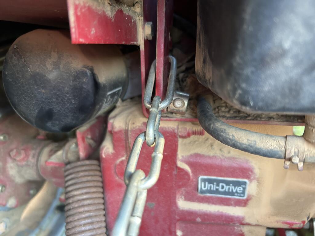

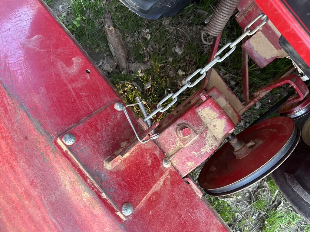

2acrefarm 9 #15 Posted April 11, 2023 Attached are pictures. Again ask away or offer what you can. I know the tiller worked before and it did lift and go down…., 1 Share this post Link to post Share on other sites

c-series don 11,941 #18 Posted April 11, 2023 Up underneath the middle of the tractor there’s a cable that runs to the rear of the tractor. I can see one end of it in your picture. With the tractor running and the brake on actuate the lift lever and you should see the rockshaft underneath the tractor moving. That’s what the cable should be attached to. Share this post Link to post Share on other sites
Rick3478 454 #19 Posted April 11, 2023 That hitch pin attaching the chain to the tiller isn't the way to do that. You should have a yoke there. And you may need to shorten up a link or two on the chain. But another thing occurred to me that may or may not be relevant - you didn't by any chance leave the mower lift arm on the tractor, did you? If that's pulled up tight against the bottom of the tractor, it won't let the lift move any farther. Tryin' to think inside and outside the box. Share this post Link to post Share on other sites

2acrefarm 9 #21 Posted April 15, 2023 Got it working.Combination of things. Chain was in the wrong slot on the shaft. Chain was probably not the correct length. Thanks fellas, I love this tractor….. 2 Share this post Link to post Share on other sites
