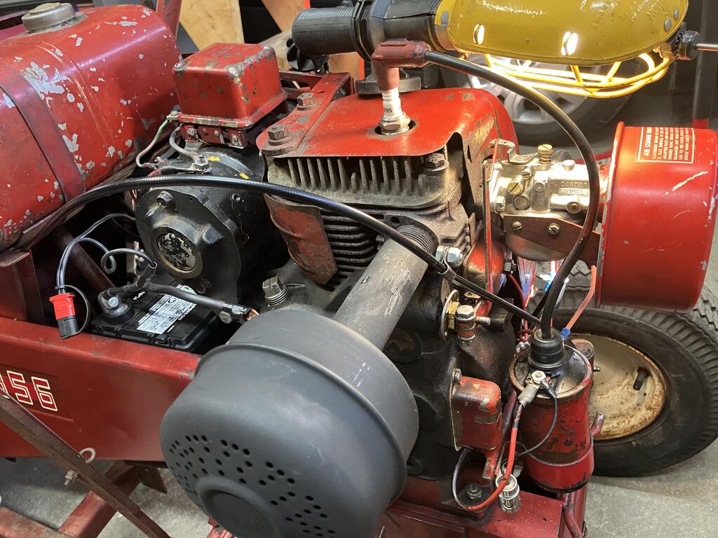

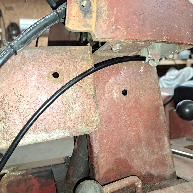

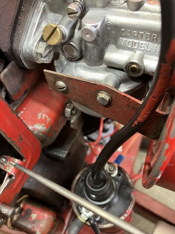

Retired Wrencher 6,772 #21 Posted March 3, 2025 I started changing out the old yesterday, and in with the new. Will finish up today. I drilled a small hole on the Governor arm for better action on cable.. 2 Share this post Link to post Share on other sites
WHX?? 57,278 #22 Posted March 3, 2025 Something don't look right on that second Pic Wrencher. Unless you don't have it cut to length yet? On eights I found a spring with the link wire gov to throttle helps smooth things out. 1 1 Share this post Link to post Share on other sites
Retired Wrencher 6,772 #23 Posted March 4, 2025 On 3/3/2025 at 8:06 AM, WHX?? said: Something don't look right on that second Pic Wrencher. Unless you don't have it cut to length yet? On eights I found a spring with the link wire gov to throttle helps smooth things out. Just showing the gentle ark. For smooth function. 1 Share this post Link to post Share on other sites
