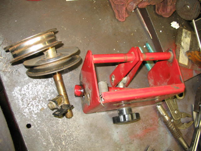

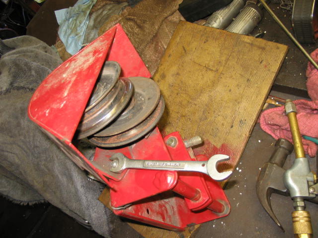

dhag 3 #1 Posted March 30, 2023 etpdSnosor410igu3h3u31h5989h3a3563g45u9a97fu4gh2m9ai50t63it0 · I was given the item on the right by my neighbor who just purchased a 520H. It looks like I'm missing two parts that I think I can fabricate myself, but I need some help. Can anyone provide the measurement between the blue arrows? I'm assuming the yellow X piece is held on by a short carriage bolt where the blue circle is. Is this also supported by the nut at the end of the pulley shaft? I'm not sure if the bottom left picture is the right part for this. I picked it up on ebay just incase. I appreciate all the help I can get. Thank you. All reactions: 44 8 Like Comment Send Share this post Link to post Share on other sites

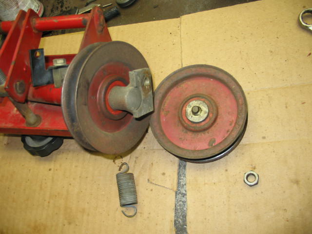

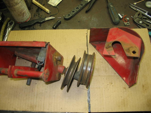

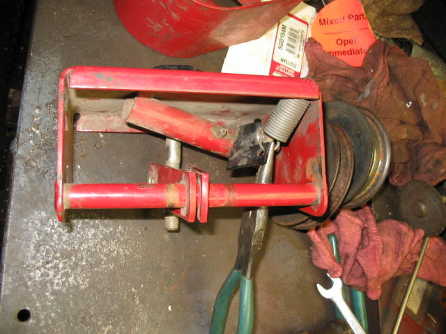

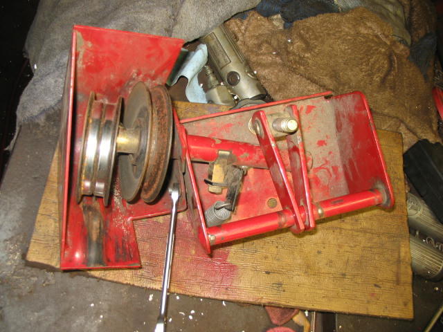

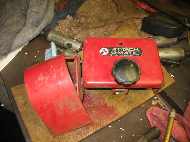

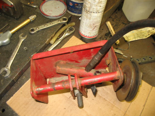

daveoman1966 3,884 #2 Posted March 30, 2023 Do these pics help? 1 Share this post Link to post Share on other sites
peter lena 10,103 #3 Posted March 30, 2023 @dhag would also be a prefect time to re grease those pulleys , original bearing grease was not correct for heat / stress , if you have the wide rubber side shields on those , small fine putty knife will carefully remove them , wipe out existing grease ,flush with carb cleaner, repack to same amount with lucas red or marine grease , those bearings will spin quietly with ease @daveoman1966 pictures really help out , done all of mine , dot that difficult , lubricate the adjustment threading , pete 1 Share this post Link to post Share on other sites
dhag 3 #4 Posted March 30, 2023 1 hour ago, daveoman1966 said: Do these pics help? 1 Share this post Link to post Share on other sites
dhag 3 #5 Posted March 30, 2023 These are perfect!! Thank you. I couldn't find a picture of the back side. Just what I needed. Great excuse to buy a spot welder. Share this post Link to post Share on other sites
