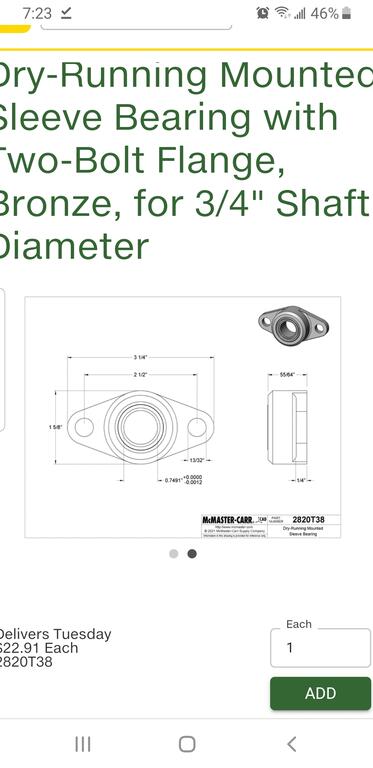

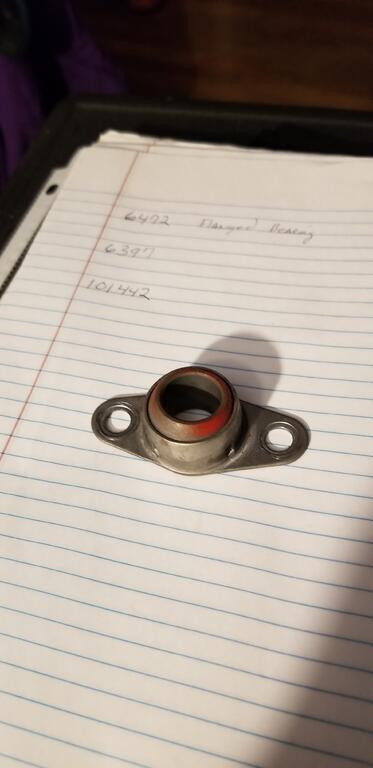

gt14rider 1,283 #1 Posted March 25, 2023 Hi all, has anyone ever tried to use a flanged bearing on end of fan gear. Is it worth the trouble to change it. Share this post Link to post Share on other sites
Lee1977 7,807 #2 Posted March 26, 2023 The one in you picture looks good if it turns free a new one won't be any better. Share this post Link to post Share on other sites
ebinmaine 81,047 #3 Posted March 26, 2023 11 hours ago, gt14rider said: . Is it worth the trouble to change it. Is that one loose or grinding? Share this post Link to post Share on other sites

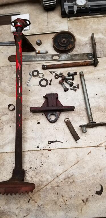

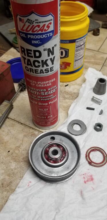

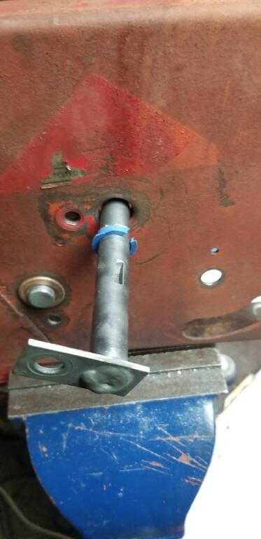

gt14rider 1,283 #4 Posted March 26, 2023 Its loose, cleaned in ultrasonic cleaner, I just want to tighten things up. Maybe some Lucus red sticky grease will smooth things out. Put brass bushings in the steering support. Will be making 7/16" tie rods. 1 2 Share this post Link to post Share on other sites
ebinmaine 81,047 #5 Posted March 26, 2023 6 minutes ago, gt14rider said: loose If it's loose, I'd replace it while you're there. Now's the time. 3 Share this post Link to post Share on other sites
peter lena 10,103 #6 Posted March 26, 2023 @gt14rider thats the time to do a detail refit , that idler pulley in your picture can also be re/ greased with lucas red grease . do that to every related lever / linkage area . go from a dragging / stiff movement start to smooth and easy . you are right there . my steering links are also heim joints , as well as clutch rod ends . pto lever rod end , no one told me you can't do that , so I did it . pete 1 Share this post Link to post Share on other sites
gt14rider 1,283 #7 Posted March 26, 2023 Pete,Way ahead of you. Also have brass bushings for cross shaft linkage and motion control. (Pics later) 1 1 Share this post Link to post Share on other sites

peter lena 10,103 #10 Posted March 26, 2023 @gt14rider good for you , that simple lubrication detailing is amazingly different from existing set up . once I started doing that , it has become baseline standard for rotational movement , linkage , lever areas .pete Share this post Link to post Share on other sites

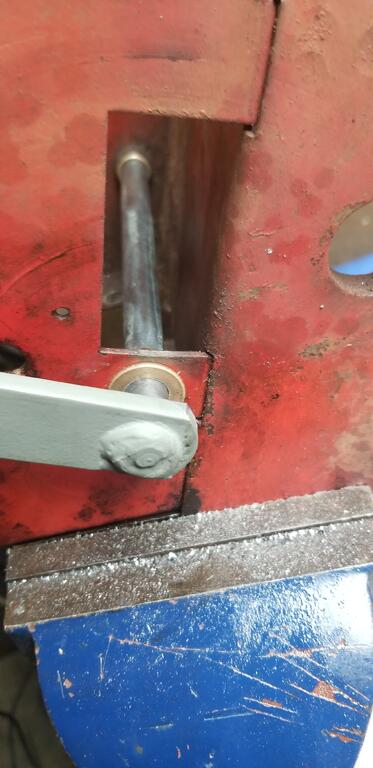

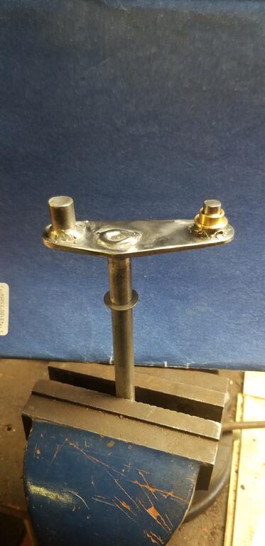

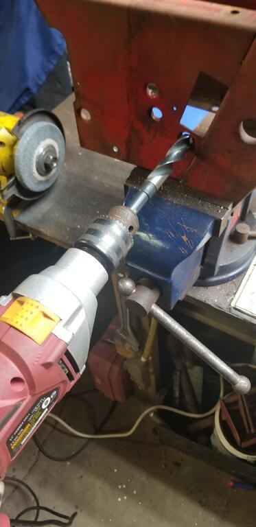

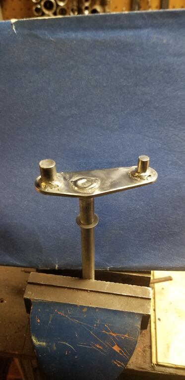

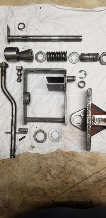

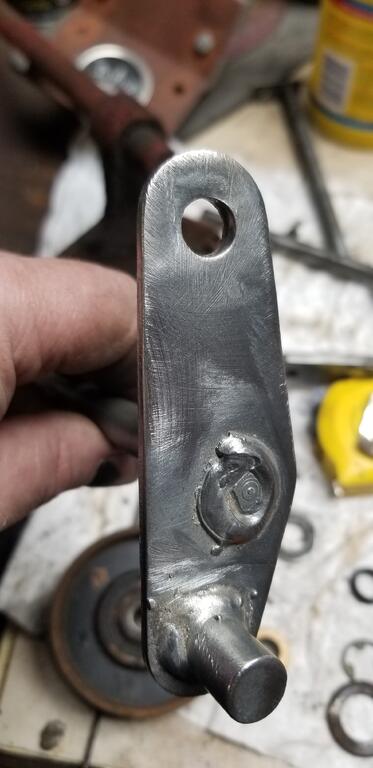

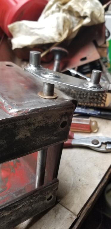

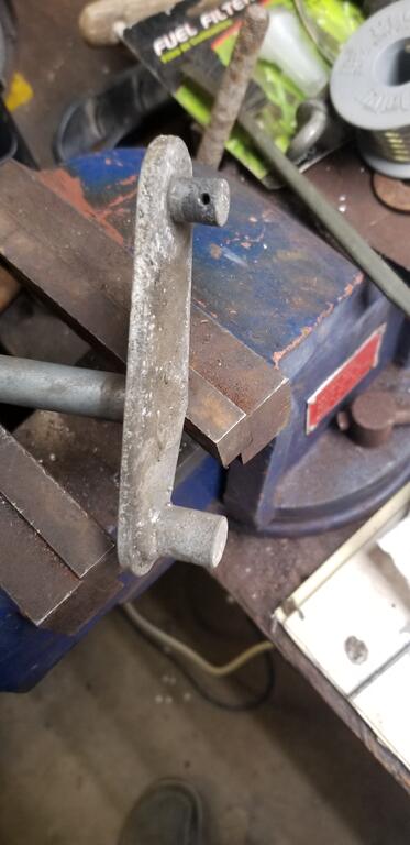

gt14rider 1,283 #11 Posted March 26, 2023 Got some bushing done. Idler pully shaft and parking brake shaft both got 1/2" bronze bushings and motion control shaft got one grommet. Repaired parking brake linkage pin and bushing for lever. Not lubed till its painted Pete 2 Share this post Link to post Share on other sites
Blasterdad 3,168 #12 Posted March 26, 2023 Been a while since I seen a motion control rod that the tab wasn't broken off or cracked, nice job cleaning everything up... Share this post Link to post Share on other sites
peter lena 10,103 #13 Posted March 26, 2023 @gt14rider nice detailing on that , the solidity of build and lubrication match , will make it work like a bank door . pete Share this post Link to post Share on other sites
