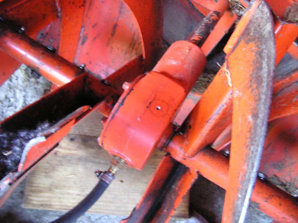

ri702bill 13,189 #3 Posted March 24, 2023 Seems to be a sealed system. The gear pump generates heat in use, will cause a pressure buildup inside. The seals take it to a point and then leak. Did you see my post last year about the persistant leak in the summer my old Ariens SnoThro gearbox had - same thing. I pulled the fill plug in August - woosh - the gearbox WAS pressurized!! I introduced 5 PSI of air in the fill, drilled a tiny hole in the upper casting - no drill chips inside.... Bought a strip of 20mm diameter Goretex Self stick Patches - cleaned the area, applied one. Used it this year for the one and only storm we had - no issues, no leaks then, no leaks after last August when I refilled it..... used something very similar at work..... 1 1 Share this post Link to post Share on other sites
