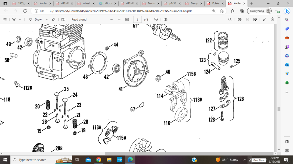

953 nut 70,325 #5 Posted March 19, 2023 (edited) Your ignition points are located near the base of the engine below the exhaust pipe. There is a cover over then to keep the points dry and clean. None of the eight HP K181 engines used by Wheel Horse on the 855 were magneto ignition from the factory so you probably have a replacement engine. After nearly seven decades and previous owner repairs that shouldn't be a big surprise. The condenser is behind the flywheel, see item 114 on the attached Illustrated Parts List. Be sure your ignition points are opening and closing and that they don't have any reading to ground when open. There is a wire from your ignition switch that will ground the points when the switch is OFF. Be sure that the wire going to the points from the switch is not grounded with the switch in run. Edited March 19, 2023 by 953 nut fat finger 2 Share this post Link to post Share on other sites
REETKID22 14 #6 Posted March 20, 2023 33 minutes ago, 953 nut said: Your ignition points are located near the base of the engine below the exhaust pipe. There is a cover over then to keep the points dry and clean. None of the eight HP K181 engines used by Wheel Horse on the 855 were magneto ignition from the factory so you probably have a replacement engine. After nearly seven decades and previous owner repairs that shouldn't be a big surprise. The condenser is behind the flywheel, see item 114 on the attached Illustrated Parts List. Be sure your ignition points are opening and closing and that they don't have any reading to ground when open. There is a wire from your ignition switch that will ground the points when the switch is OFF. Be sure that the wire going to the points from the switch is not grounded with the switch in run. the engine is a replacement engine, i don't think i have a ground wire for my key switch/magneto because there is a little button on the points cover to kill the engine. im gonna file the points tomorrow and set the gap again. i will also check for ground at the points where the magneto connects. 4 Share this post Link to post Share on other sites
