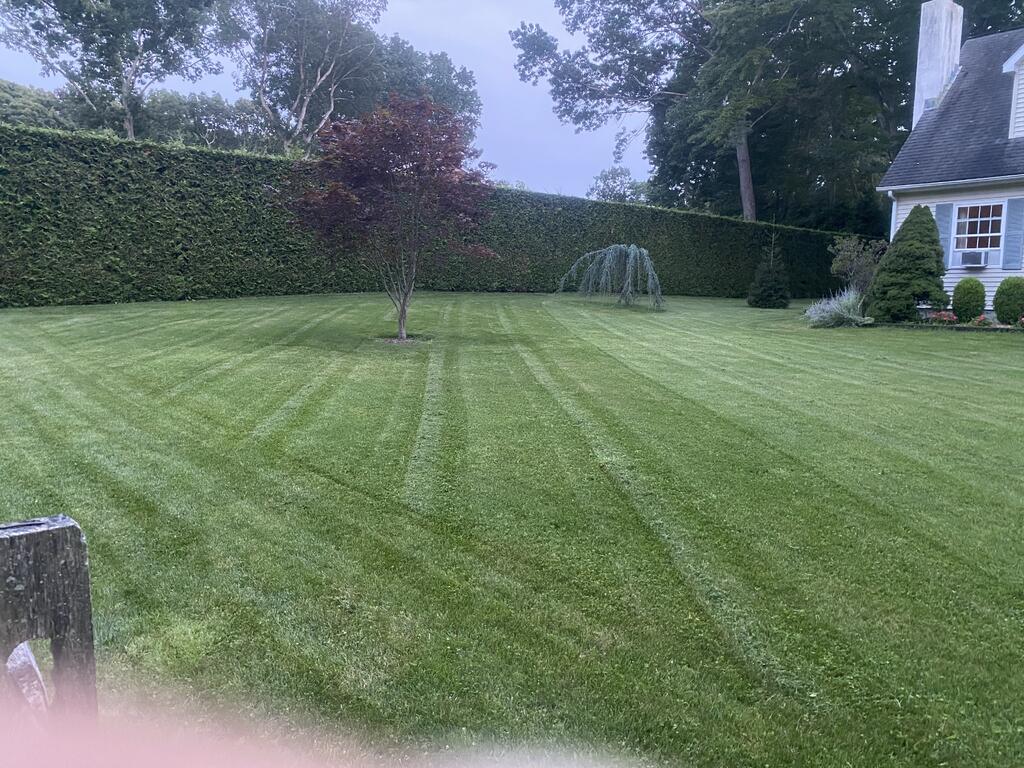

c-series don 11,494 #5 Posted March 14, 2023 @kpinnc That would be me! It turns about 95% before the wheels rub the deck as you can see in the picture. It really not an issue though as my yard is mostly wide open. I must say that the 60” deck does a nice job! Taking it on and off in the spring and fall is not that fun though! 3 3 Share this post Link to post Share on other sites

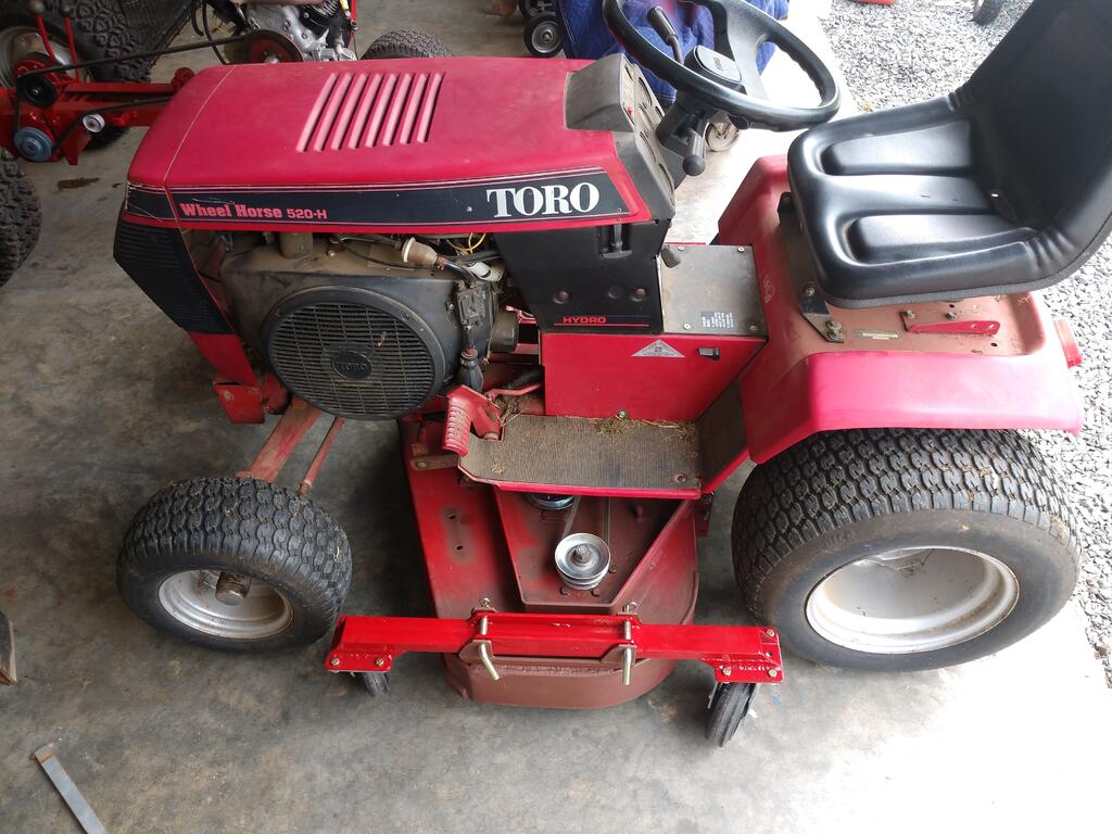

kpinnc 17,297 #8 Posted March 14, 2023 (edited) 8 hours ago, cleat said: It is too bad that Wheel Horse designers did not put on some kind of swiveling wheel design for moving the deck sideways under the tractor or make a way to safely drive up and over the deck. It does help considerably... See below. That's a 48 from an Exmark, but well over 200lbs. 8 hours ago, cleat said: My 520HC came that way. It actually steers fairly easy and would be quicker steering for mowing. Good looking setup you have there don. Do you have any issues with the mule drive ? My 60" deck uses a different one. My 520-H has the swept axle without reduction steering. It's not bad at all so long as the front tires are properly inflated. Can't speak for Don, but my standard mule drive works fine compared to the one that came with the 60 deck. The belt tracks better on the pulleys. I have used the correct one, but I don't see the (adverised) benefit. Maybe I'm doing something wrong, but I've mowed with both and they both work. Edited March 14, 2023 by kpinnc 1 Share this post Link to post Share on other sites
