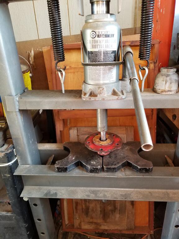

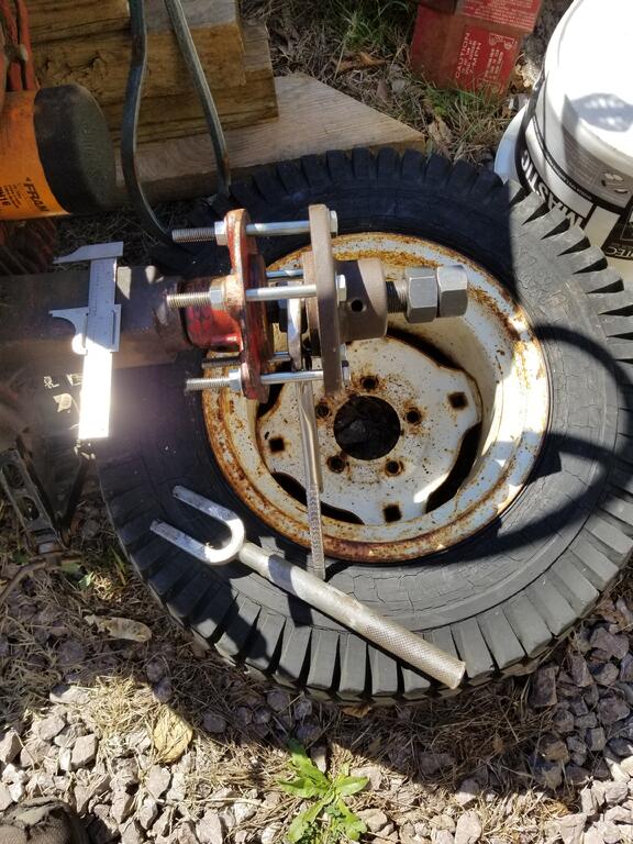

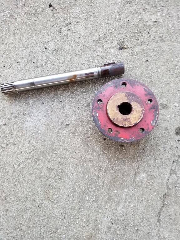

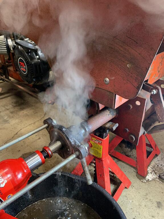

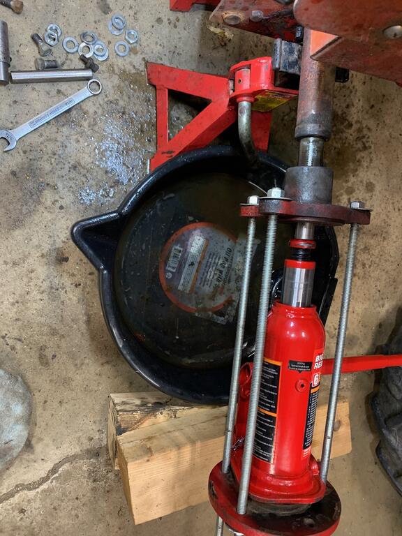

cafoose 3,459 #1 Posted March 8, 2023 The first hub I pulled came right off. The axle key way is worn to twice the width I was soaking the other hub for a week in Kroil and Liquid Wrench. It still wouldn't budge using the @daveoman1966 method. I used my caliper to make sure the five bolts were the same distance between both hubs to help avoid distortion, ensure even pulling, and minimize breakage. I used a 1-14 threaded rod with two nuts locked together on the end. It still wouldn't budge. I pulled the rear and disassembled it and removed the snap ring and pinion gear from the other end. Then I took it to the 20 ton press and heard a loud pop and it moved I continued to put pressure on it several times and heard a few more loud pops and then success It came off I did have to file down the end of the axle a little because of pulling so hard the splines right behind the snap ring were raised a little too much for the axle to slide out Not sure if I did it or someone else tried to remove it in the past. Now I need to try to rebuild my first hydro using the download from @daveoman1966 and also replace or repair the other axle. The original problem was it was driving fine then all at once it wouldn't move forward or backwards. 6 8 Share this post Link to post Share on other sites

953 nut 60,644 #9 Posted March 8, 2023 8 hours ago, cafoose said: pulled the rear and disassembled it and removed the snap ring and pinion gear from the other end. Then I took it to the 20 ton press and heard a loud pop and it moved I continued to put pressure on it several times and heard a few more loud pops and then success It came off Heat helps but even that won't do the job some times. I had to do the same as you with splitting the transaxle and pulling the axle/hub assembly but my 20 ton HF press wouldn't get the job done even after it was red hot while under pressure. Ended up taking it to the local machine shop's 100 ton press. The loud pop we heard there was the hub cracking along the keyway. They had to "V" notch the hub and weld it but all is well. 6 Share this post Link to post Share on other sites

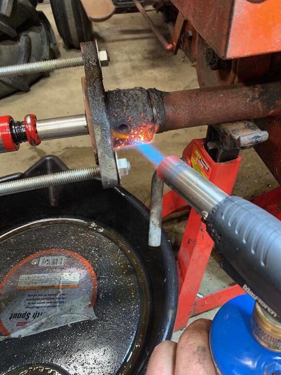

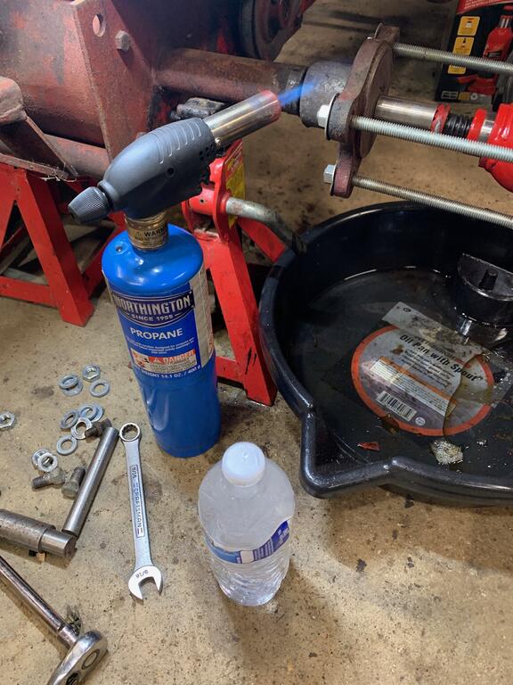

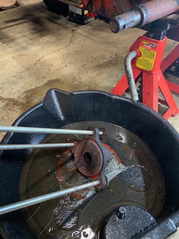

Andy N. 2,419 #14 Posted March 8, 2023 I recently replaced the axle seals on my 1960 Suburban and used threaded rod with a spare hub at the other end and a 6 ton jack in between. I'm not sure if these had ever been changed before and the hubs were definitely rusted on. I used the heat/quench method and was tapping around the radius of the hub with a hammer while heating. It took some patience and work, but both eventually came free. And you bet they went back on with anti seize on the axle. 5 3 Share this post Link to post Share on other sites
