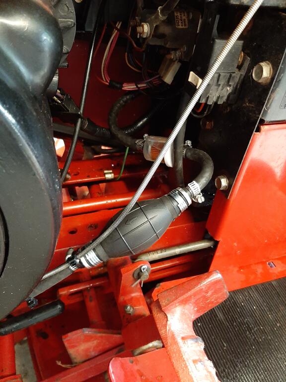

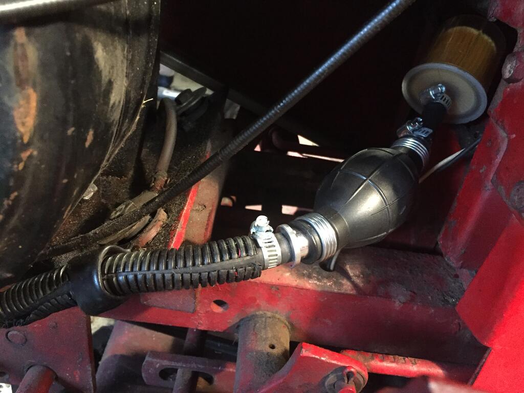

SylvanLakeWH 32,141 #2 Posted March 6, 2023 I've used a marine primer bulb for years... works like a charm... 4 Share this post Link to post Share on other sites
rjhutson 7 #3 Posted March 6, 2023 Thanks for the pic and info. How many times do you pump the bulb to start up? 2 Share this post Link to post Share on other sites
SylvanLakeWH 32,141 #4 Posted March 6, 2023 (edited) 3 minutes ago, rjhutson said: Thanks for the pic and info. How many times do you pump the bulb to start up? Couple quick pumps do the trick... @peter lena also uses some check valves that keep the gas in the line... perhaps he can post some info and a pic or two... Edited March 6, 2023 by SylvanLakeWH Share this post Link to post Share on other sites
rjhutson 7 #5 Posted March 6, 2023 12 minutes ago, SylvanLakeWH said: Couple quick pumps do the trick... @peter lena also uses some check valves that keep the gas in the line... perhaps he can post some info and a pic or two... Thanks 1 Share this post Link to post Share on other sites
SylvanLakeWH 32,141 #6 Posted March 6, 2023 Check out post 5 in this thread... has link to check valves... Share this post Link to post Share on other sites

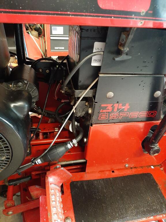

peter lena 10,015 #7 Posted March 6, 2023 @rjhutson note 4 th picture down , showing check valve just under carb , vertically from fuel pump , fuel being held by valve , have this set up on 3 horses , 5/16 . aluminum check valve on line , you are looking at held fuel stage . arrow on valve facing up to carb . works consistently , pete 1 Share this post Link to post Share on other sites
peter lena 10,015 #8 Posted March 7, 2023 @rjhutson evil energy fuel check valve 5/16" , ebay , like clear fuel line with the dark green squeeze clamps . tiny smear of dielectric grease , on valve nipple , makes for snug hose make up . then add green clamp . no leaks , works good , pete 1 Share this post Link to post Share on other sites
Bill D 3,101 #9 Posted March 7, 2023 10 hours ago, SylvanLakeWH said: I've used a marine primer bulb for years... works like a charm... I don't know if that's a recent picture, but the fitting is coming out of the primer bulb. You may want to put a different clamp on it before you have a fire. 2 1 Share this post Link to post Share on other sites
SylvanLakeWH 32,141 #10 Posted March 7, 2023 4 hours ago, Bill D said: I don't know if that's a recent picture, but the fitting is coming out of the primer bulb. You may want to put a different clamp on it before you have a fire. Yes thx. Good eye! Old pic. Fixed moons ago...!!! 1 Share this post Link to post Share on other sites
