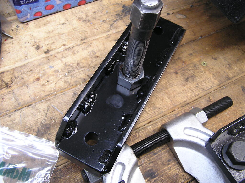

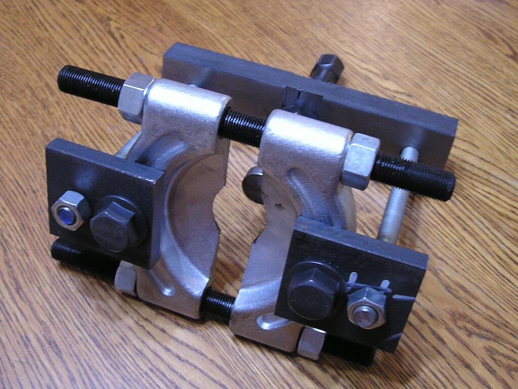

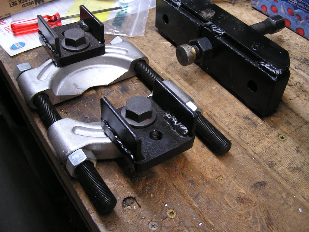

ri702bill 13,399 #3 Posted March 6, 2023 Depends on the hub material. Machined steel - maybe. Cast iron - nope. Better to pull from the rear, not the flange. Did mine a few years back... HF bearing Seperator, old Snap on Puller screw, threaded rod. 2 2 Share this post Link to post Share on other sites

SylvanLakeWH 32,932 #5 Posted March 6, 2023 Here's a bunch... 2 1 Share this post Link to post Share on other sites

953 nut 70,665 #8 Posted March 7, 2023 I have one that is modeled after @meadowfield's with an 8 ton jack that works great. As @squonk posted the greater number of threads will give added strength. However, if you screw the 7/16 rod into the hub to be removed and then thread it into the hub that is a part of your puller I think you will find that a bit tedious. Doing it five times will probably have to seek psychiatric help. 4 hours ago, ri702bill said: Someone here on the Forun did exactly what you are describing - hope they chime in. Not all bottle jacks work well (or at all) when placed on their sides.... if you already have one in mind - try it... The pump needs to be kept low relative to the jack body. 1 1 Share this post Link to post Share on other sites
squonk 48,429 #9 Posted March 7, 2023 5 minutes ago, 953 nut said: I have one that is modeled after @meadowfield's with an 8 ton jack that works great. As @squonk posted the greater number of threads will give added strength. However, if you screw the 7/16 rod into the hub to be removed and then thread it into the hub that is a part of your puller I think you will find that a bit tedious. Doing it five times will probably have to seek psychiatric help. The pump needs to be kept low relative to the jack body. You could use 7/16" fine studs so you put them on the hub first to make the job a little less cumbersome. 1 Share this post Link to post Share on other sites

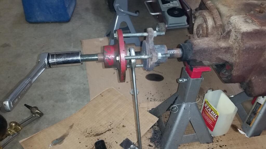

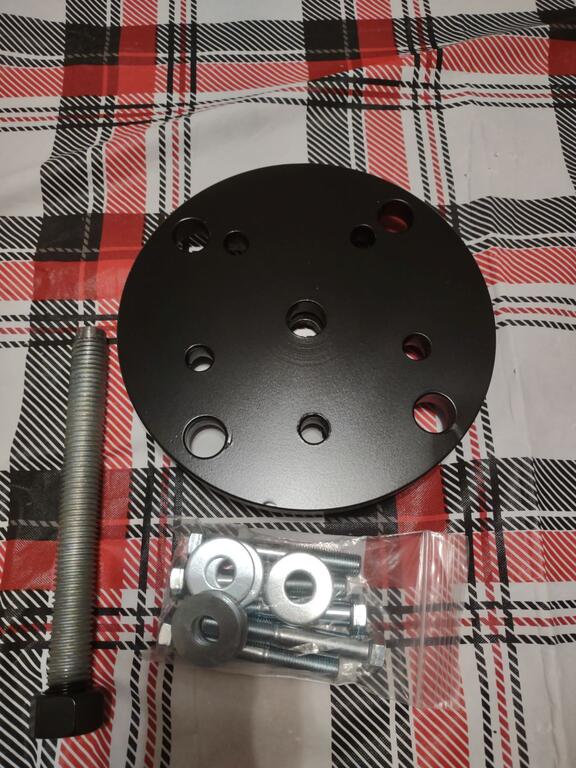

Achto 32,964 #11 Posted March 7, 2023 I've always had good luck with my home made puller. The bolts are just threaded into hub with no nuts behind them. As you can see in the first pic, it took A LOT of pressure to get this hub off. This hub fought me the entire way. Took some sweating & colorful language but I finally won with no damage to the hub, axle or the puller. Center push bolt is 3/4-10 1 9 1 Share this post Link to post Share on other sites

peter lena 10,127 #14 Posted March 7, 2023 @Achto nice job on that , when you use strength / against strength , like KROIL IN / ON THE AREA , days out ,also on any screw threading point , that first solid attempt on removal will tell how you are doing . been there , pete 3 Share this post Link to post Share on other sites
Achto 32,964 #15 Posted March 7, 2023 6 minutes ago, peter lena said: KROIL IN / ON THE AREA , days out ,also on any screw threading point Soaked the hub with Sea Foam Deep Creep once a day for about a week. Always put a little 30wt on the threads of the pusher bolt for the puller. 4 Share this post Link to post Share on other sites

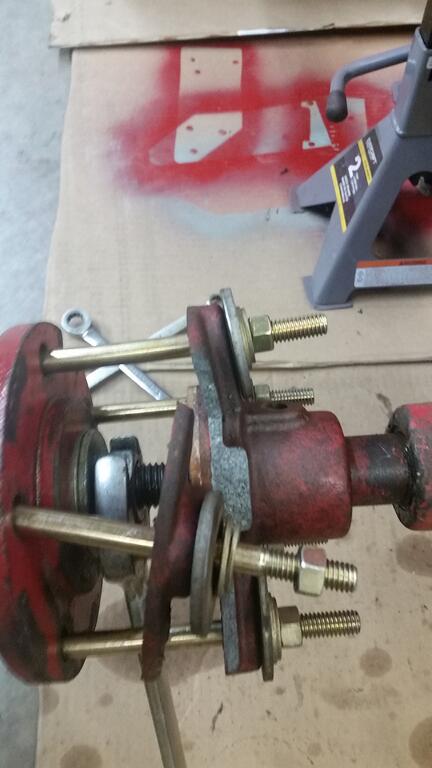

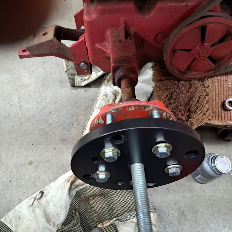

WHX?? 58,388 #19 Posted March 7, 2023 (edited) Pretty much did the same thing as @Achto. He put this set together for xmas gor me. Fought all the way and did Bill's penetrant in the set screw which it did take it but axle was dry. This was the weaker style star hub. Torque all bolts to the same for even pressure. BTW EB other flavors did work better than PB Blaster. I don't have a big breaker bar put an air impact got it moving. Edited March 7, 2023 by WHX?? 2 3 Share this post Link to post Share on other sites
Tonytoro416 1,396 #20 Posted March 7, 2023 1 minute ago, WHX?? said: Pretty much did the same thing as @Achto. He put this set together for xmas gor me. Fought all the way and did Bill's penetrant in the set screw which it did take it but axle was dry. This was the weaker style star hub. Torque all bolts to the same for even pressure. BTW EB other flavors did work better than PB Blaster. Can verify for a fact Dans puller works 3 1 Share this post Link to post Share on other sites

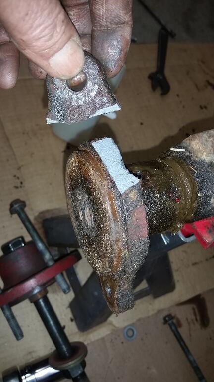

WHX?? 58,388 #21 Posted March 7, 2023 (edited) This one used bolts and nuts which didn't have even pressure on it. Much easier to do with thread in bolts. This one got cut off ... tranny split and other side went to the H press. Another fail. From here on out three holers get a bearing collar on the back side. I'm sold on thread in. Edited March 7, 2023 by WHX?? 3 1 Share this post Link to post Share on other sites
ri702bill 13,399 #22 Posted March 7, 2023 5 minutes ago, WHX?? said: This one used bolts and nuts which didn't have even pressure on it. Much easier to do with thread in bolts. This one got cut off ... tranny split and other side went to the H press. The infamous "Star" hub.... WH's version of the short fuse, the hair trigger and the "delete all" command.... 2 1 Share this post Link to post Share on other sites
WHX?? 58,388 #23 Posted March 7, 2023 9 minutes ago, ri702bill said: The infamous "Star" hub.... WH's version of the short fuse, the hair trigger and the "delete all" command.... Unfortunately as a mid sixties fan the bulk of my tractors have them. 1 1 1 Share this post Link to post Share on other sites
