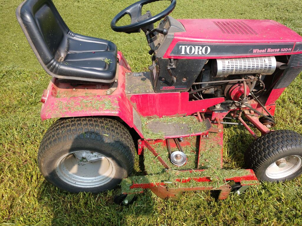

Gary S Minnesota 62 #1 Posted March 2, 2023 I know this topic has been covered but I can’t seem to find the old threads. As I recall there are two issues when mowing with Onan hydros. I understand grass accumulation can occur quickly in the flywheel screen and then move to the rear cylinder cooling fins causing overheat problems on the rear cylinder. I also read that the rear discharge unit tends to throw grass clipping at the Hydro fan unit possible causing over heating issues with the pump? Also recall that some add a piece of vinyl baseboard molding to the RD deck to deflect the clippings away from the hydro unit? I recently picked up a 1995 520H which came with the rear discharge deck. I also have a an extra 48” side discharge deck that I use on my 314-8 tractor. I think I will be mowing with the 520H unit this summer and am curious which style deck you guys recommend I use and why? Thanks, Gary in Minnesota 1 Share this post Link to post Share on other sites

kpinnc 18,969 #3 Posted March 2, 2023 1 hour ago, Blasterdad said: Both are okay, just blow of the tractor, deck, & engine after mowing, ( I use my leaf blower ) Most problems arise from neglect, owners never doing it. I have 520 H parts tractor that the PO killed by NEVER cleaning it, it was packed full of grass, dirt & crud. Absolutely correct. I use a leaf blower at minimum to clear clippings from everywhere I can reach. Bath works better, but you don't want to ever spray a hot engine. Leaf blower works in a pinch. I also have an Eaton from a 520-H that had packed in clippings when I got it. It's now scrap metal as far as I'm concerned. But- to answer your question: I'd use the 48SD on the 520-H. The wider wheelbase makes getting up close to obstacles very difficult with a 42. Use the rear discharge on the 314-8. Not to mention the additional horses from the Onan make the 48 a better mower. 3 Share this post Link to post Share on other sites

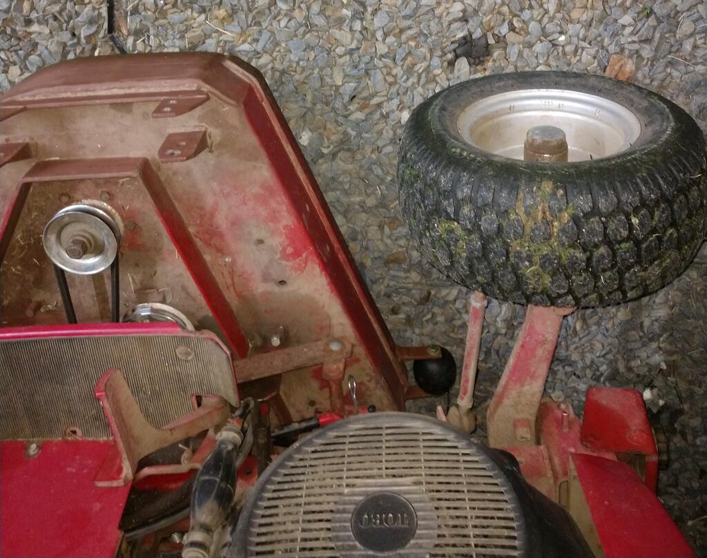

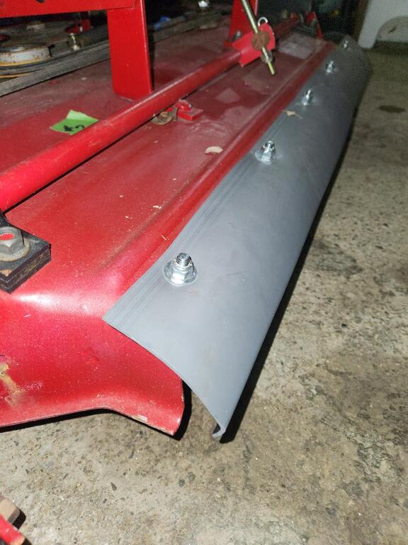

Brockport Bill 2,478 #7 Posted March 2, 2023 ditto the prior suggestions to switch the mowers - - in addition to previous suggestions, clean underneath of the decks to avoid rot - - and common sense don't mow wet grass -- i use putty knife after every mowing to clean/scrape bottom of shell, plus power pressure wash every 3-4-5 mowings as needed - besides stopping shell rot the cleaner the bottom of shell the better quality cut and better discharge of clippings ---------- also if you have pulley/belt covers use leaf blower to blow out clippings from under the covers - - that will certainly cause rot thru on top of deck over time if not cleaned - here is photo of the R.D. vinyl strip i attached of base wall/cabinate vinyl - use hex carriage bolts with rounded heads underneath to avoid catching clippings 2 3 Share this post Link to post Share on other sites

JR Pedersen 18 #14 Posted August 7, 2025 On 3/2/2023 at 1:59 AM, Brockport Bill said: ditto the prior suggestions to switch the mowers - - in addition to previous suggestions, clean underneath of the decks to avoid rot - - and common sense don't mow wet grass -- i use putty knife after every mowing to clean/scrape bottom of shell, plus power pressure wash every 3-4-5 mowings as needed - besides stopping shell rot the cleaner the bottom of shell the better quality cut and better discharge of clippings ---------- also if you have pulley/belt covers use leaf blower to blow out clippings from under the covers - - that will certainly cause rot thru on top of deck over time if not cleaned - here is photo of the R.D. vinyl strip i attached of base wall/cabinate vinyl - use hex carriage bolts with rounded heads underneath to avoid catching clippings Thanks for this idea - bought a piece last night and installed in less than 20 minutes (measure, check measure, triple check measure)!!! 1 Share this post Link to post Share on other sites
