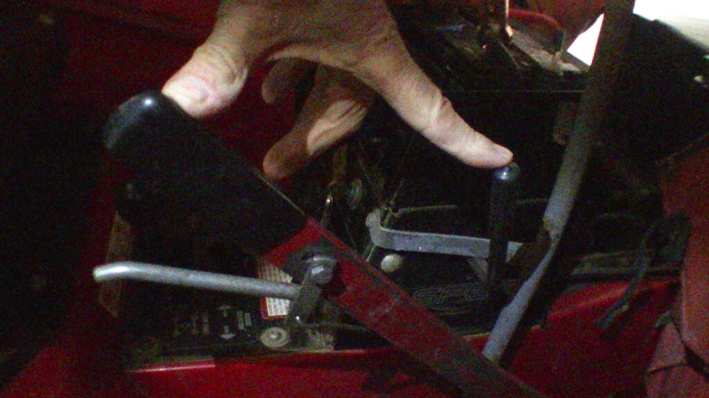

Leland 16 #1 Posted March 1, 2023 I have a 312-8 and I have a plow on it and also a snow cab. problem is the lever when angle all the way to one way is outside the cab because on the right side there isn't any extension of the cab like there is on the otherside for the lift. There is a zipper at the point where the angle lever is but I do no not want to have the lever outside. So I installed a short metal bracket to shorten the rod and now the handle is all inside. Problem is the handle rubes on the shaft for the brake. So I cut away part of the handle to make room for the shaft and I do not think I can cut anymore or it may break. Has anybody modified this situation. I may be able to cut more away and then weld a piece onto where the little that would be left as for some reason it is cut away on the top at that point. I thought about trying to istall a power angle on that but that would be a lttle costly. 1 Share this post Link to post Share on other sites

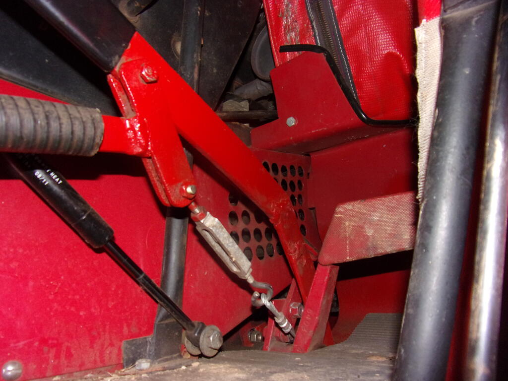

Ed Kennell 46,051 #2 Posted March 1, 2023 I altered mine to get it inside the cab on my 520H. I sawed a vee in the lever about 3/4 of the way thru at several key places, then bent the lever to the shape I needed. After I had the shape I needed, I welded the vees and added a plate on the side of each vee. I used a cable guided by several small eye bolts to operate the angle locking pin. 4 2 Share this post Link to post Share on other sites

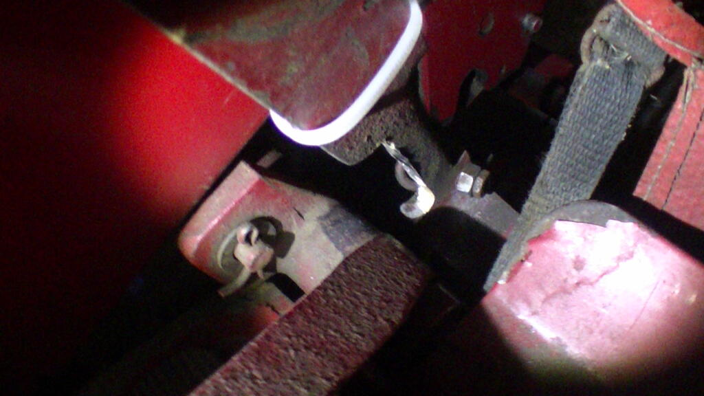

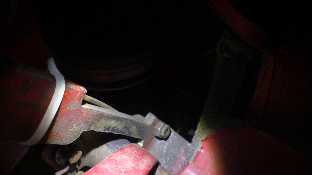

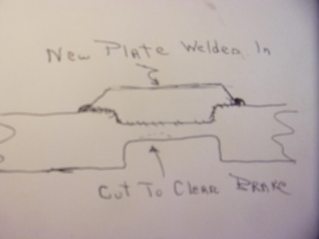

Leland 16 #3 Posted March 2, 2023 (edited) 15 hours ago, Ed Kennell said: I altered mine to get it inside the cab on my 520H. I sawed a vee in the lever about 3/4 of the way thru at several key places, then bent the lever to the shape I needed. After I had the shape I needed, I welded the vees and added a plate on the side of each vee. I used a cable guided by several small eye bolts to operate the angle locking pin. ok that is an idea as with mine up high it is a little to much in the way of my leg and also the lever for the power take off. But you see where yours at the lever is almost or maybe touching the brake rod. that is what mine does and when I hit the brake it does not want to return till I raise the blade. I notched the rod there = see pics. and the one cloosets to the rod appears to miss it but for some reason when hit brake it rubs it and holds the pedal down a little untill I backup and raise the plow. Kind of hard for me to get a good picture like you did with the cab on . I also had to bend the lever 2 places 1 to the side and then higher the other way to miss the power take off lever. I also had to move the eye bolt that holds the cable to release the plow to angle it. I may have to weld a plate on where it is notched and then notch it more to make it work . I do like your idea of having it down like you did that eliminates the problem at the power take off lever and my leg. Edited March 2, 2023 by Leland 1 Share this post Link to post Share on other sites
Ed Kennell 46,051 #4 Posted March 2, 2023 15 minutes ago, Leland said: I may have to weld a plate on where it is notched and then notch it more to make it work Yeah, it appears the factory notch is on the wrong side for your application. I would make a plate that fills in the the factory notch, then grind to clear the brake. 1 Share this post Link to post Share on other sites

Ed Kennell 46,051 #6 Posted March 2, 2023 1 hour ago, ebinmaine said: What did you use for a cable? I use garage door cables. They have a swaged loop in one end and I use a cable clamp on the end I cut to size. I also use these cables for rear lifts. 1 Share this post Link to post Share on other sites

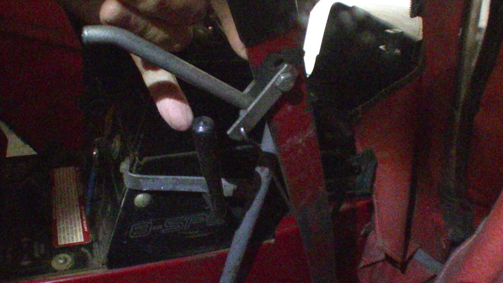

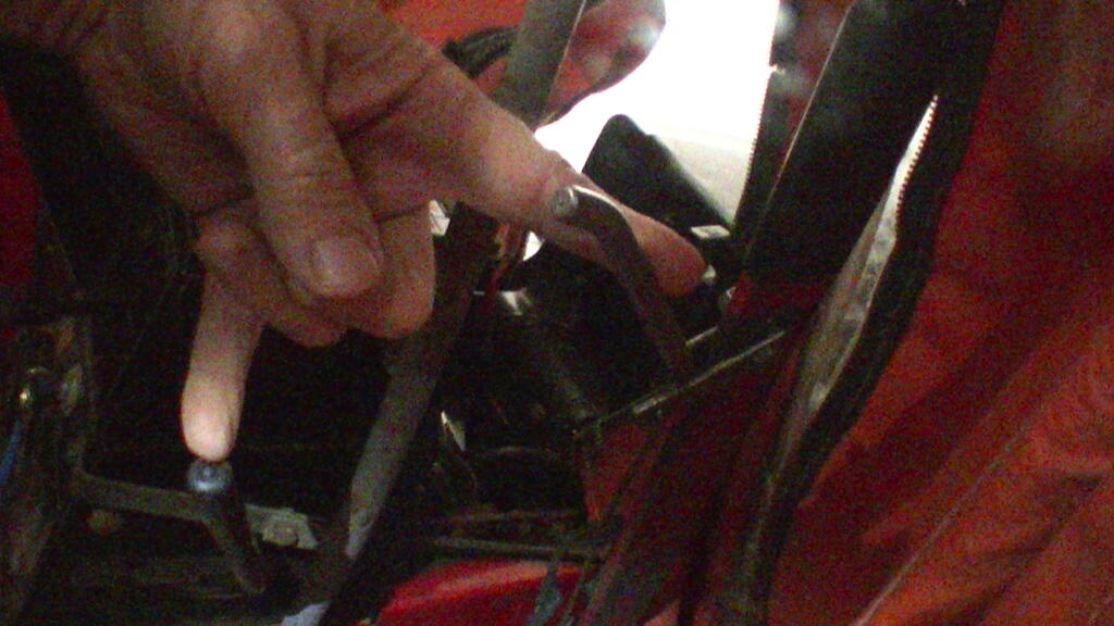

Leland 16 #9 Posted March 2, 2023 (edited) Well the power angle does sound like be a little to much to get into as I have had power angle on a truck and never thought to much about the pressure. I think if I do anything be like was suggested to weld in a piece and the cut out the lever some more . I wondered why the cut out was on the top as there isn't anthing there for it to apply to. It is only a little problem when angled the 1 way as the 1 picture shows that and I cannot understand why when angled the problem way that it even hits . I may even cut the lever so when it is angled it is below the power take off. on the pics. but that may be a little difficut to move but I do like the first guys the way he cut it and it is on the floor you might say. The pics. showing the the fingers / thumb shows where the handle and the power take off lever is. The left angle = top one as it is below the power take off lever is the problem one. Center one is to the right angle and lever is all the way to cab and other one close to the power take off is straight. There is one other option = never plow to the left. Ha Ha Edited March 2, 2023 by Leland 1 Share this post Link to post Share on other sites

Ed Kennell 46,051 #11 Posted March 2, 2023 43 minutes ago, ebinmaine said: So you're eliminating the triangular pivot to run a solid piece of cable from top of handle to the pull point for the pin? Eyelets to hold the cable? No eric, I still use the solid wire and triangle pivot at the bottom. Really no reason to change that since it's a straight line. The cable works to follow the bends in the upper lever. Yes, I use small eyelets as guides for the cable and also add a small turnbuckle at the top to fine tune the cable length. 1 Share this post Link to post Share on other sites
