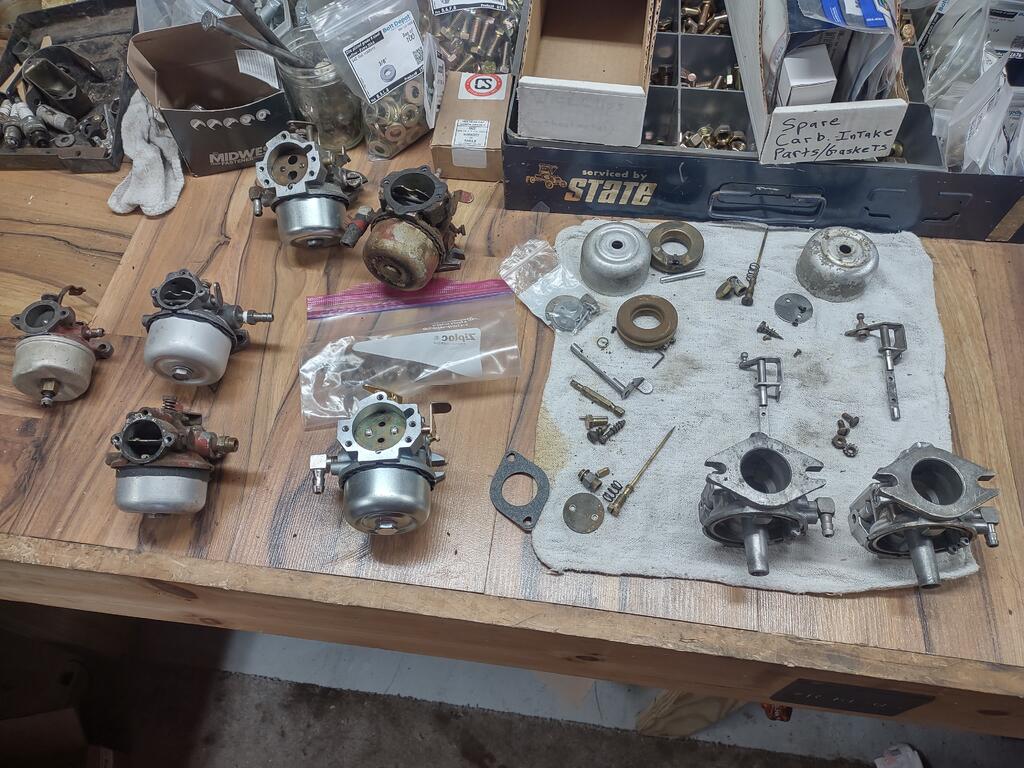

ri702bill 13,399 #2 Posted February 25, 2023 (edited) Nah - but it looks like the 2 at the top had a litter of puppies !!! You do realize the long main jet needles are different between the small 8 HP carbs and the larger 10+ models?? And that all the needles are hollow with teensy-tiny air bleed holes at both ends...?? Be sure they are open.... Looks like a couple of shiny new bowls there too... Edited February 25, 2023 by ri702bill 2 1 Share this post Link to post Share on other sites
ebinmaine 81,294 #3 Posted February 25, 2023 24 minutes ago, ri702bill said: Nah - but it looks like the 2 at the top had a litter of puppies !!! You do realize the long main jet needles are different between the small 8 HP carbs and the larger 10+ models?? And that all the needles are hollow with teensy-tiny air bleed holes at both ends...?? Be sure they are open.... Looks like a couple of shiny new bowls there too... Oh yeah absolutely. The disassembled two are both #30s off K341s. Bowls.... Yeah... There's more in a box too... 1 Share this post Link to post Share on other sites
ri702bill 13,399 #4 Posted February 25, 2023 25 minutes ago, ebinmaine said: Oh yeah absolutely. The disassembled two are both #30s off K341s. Bowls.... Yeah... There's more in a box too... Don't got nuttin' down heah that big - got 20's and 22's from 7 & 8 HP Kohlers..... Share this post Link to post Share on other sites
ebinmaine 81,294 #5 Posted February 25, 2023 36 minutes ago, ri702bill said: Don't got nuttin' down heah that big - got 20's and 22's from 7 & 8 HP Kohlers..... There's a wee bitty techy one, 2 Kohler 8 HP carbs, a 12 HP Kohler imported replacement from isavetractors, 4 #30s for K341, (one's not a WH carb) and also a B & S updraft I just found. I know I have at least another couple wee bitty techy ones, a Tecumseh 16 HP single cylinder carb, and another OE Kohler 12 and Kohler 16 HP single. Holy 💩💩💩. 1 Share this post Link to post Share on other sites

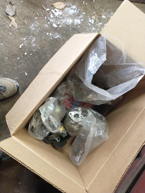

ebinmaine 81,294 #20 Posted February 25, 2023 Soo.. uhhh. Trina found a few more.... 1 2 Share this post Link to post Share on other sites
