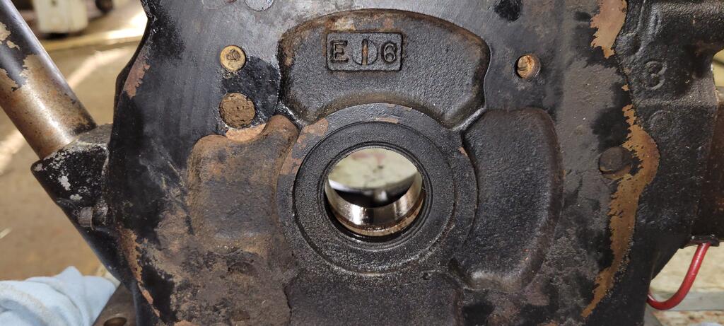

maysey 7 #1 Posted February 22, 2023 I have a 14 hp k series kohler. I'm about to do a rebuild on it and noticed it has E16 on the block instead of k321,the bore is right at 3.498. I mainly was wondering what the E16 means. 2 Share this post Link to post Share on other sites
oliver2-44 11,816 #2 Posted February 22, 2023 Lots of knowledge here! Someone will be along that has seen that has seen that before Share this post Link to post Share on other sites
rmaynard 17,642 #3 Posted February 22, 2023 Post a picture of the engine. Sounds like you don't have a K321. What other tags, decals or stickers are on the sheet metal? 2 Share this post Link to post Share on other sites
WHX?? 58,347 #4 Posted February 22, 2023 Yes need a little more info. Is this number cast in the block above crank shaft? Any chance this was a service replacement? 1 Share this post Link to post Share on other sites

953 nut 70,325 #7 Posted February 23, 2023 As others have said the E 16 is not a standard Kohler designation. The bore is standard for a 14 HP K-321, did it come out of a Wheel Horse. Share this post Link to post Share on other sites
maysey 7 #8 Posted February 23, 2023 (edited) I made a little mistake on the numbers maybe it looks like E I 6. Sorry guys. Edited February 23, 2023 by maysey 1 Share this post Link to post Share on other sites
953 nut 70,325 #9 Posted February 23, 2023 That is just a mold number. If there was a problem with the castings that would allow the factory to identify and check blocks that were cast in that mold. Share this post Link to post Share on other sites
WHX?? 58,347 #10 Posted February 23, 2023 I have the same tag on a motor on the bench now. The middle I is actually the screwdriver slot holding the plate to the mold. We have saw castings with the model number in the same place tho. It's behind the pto so often goes unnoticed. Share this post Link to post Share on other sites
