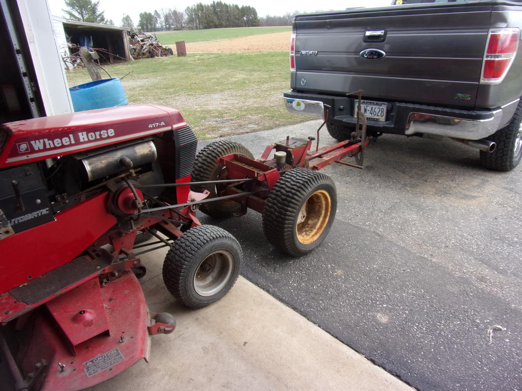

Ed Kennell 47,397 #9 Posted February 18, 2023 (edited) Yeah, if you don't have a tree, a trailer hitch works. Here's a pic of a 417-A powering an Eaton 5 hydro. It spun the tires on the blacktop with me standing on the tool tray. Edited February 18, 2023 by Ed Kennell 2 Share this post Link to post Share on other sites

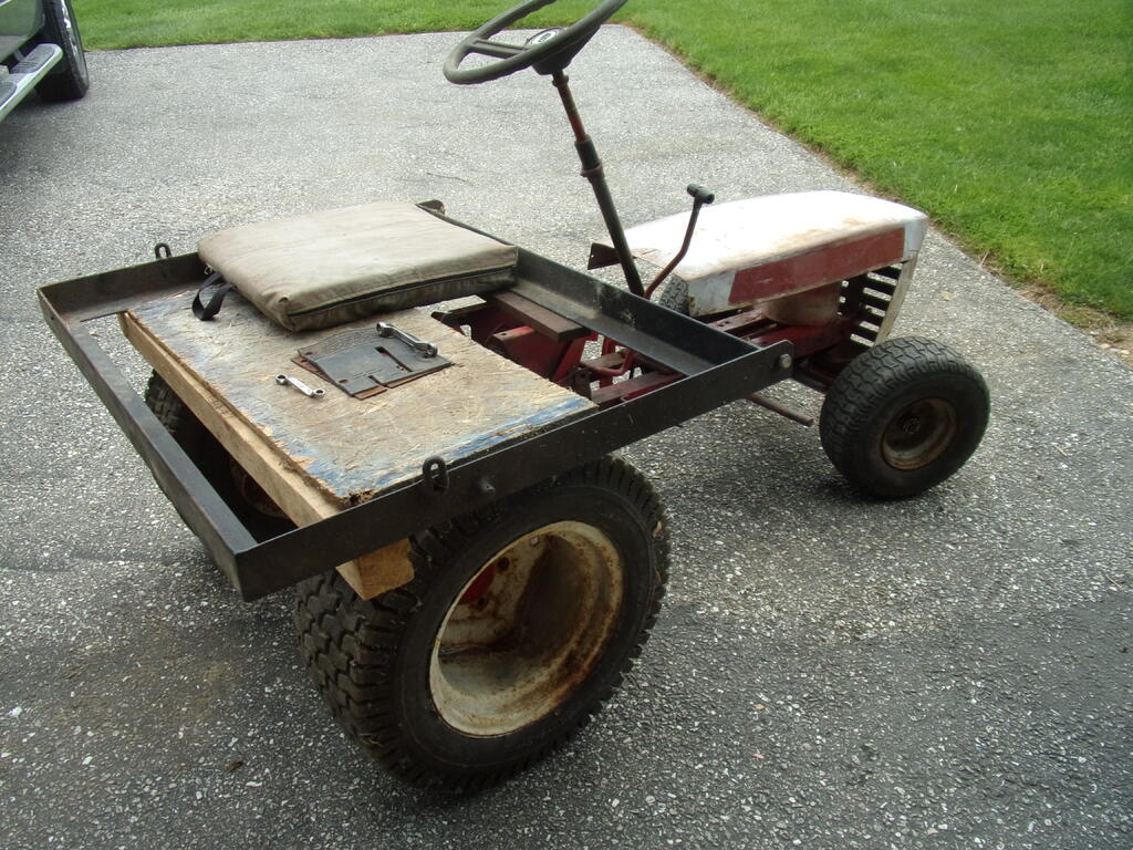

Ed Kennell 47,397 #11 Posted February 19, 2023 After confirming the Eaton 5 was a good hydro, I used it to make the side by side. 2 Share this post Link to post Share on other sites
