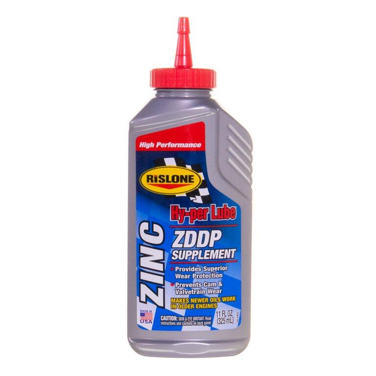

Racinbob 13,286 #13 Posted February 16, 2023 Geez! You guys just tick me off. I've been hearing so much about zinc that you've got me wondering. Actually, more like believing. One thing I won't do is switch from the lubricating products that have never failed me for decades. But I'm certainly thinking about that Rislone additive. I'm thinking it would be a good idea but then my thoughts go to the "why mess with something that has always worked?" logic. As an additive would it actually do the job? Gotta ponder and research more. 3 Share this post Link to post Share on other sites
