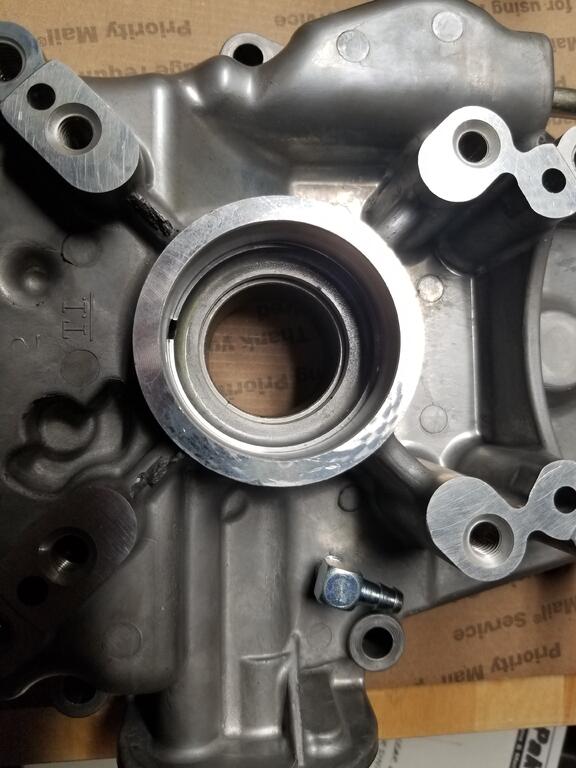

Wild Bill 633 943 #15 Posted February 14, 2023 (edited) The Kohler Command is designed with a bushing in the crankcase cover on the PTO end of the crankshaft. The cover could be bored out to install a R24 ball bearing to support the overhung load. This is what they do to pulling engines. See Lakota Racing's website. Also, there are some Kohler Command spec. nos. that have an axial thrust bearing. I have an spreadsheet from Medart which I can sort. If you post the model and spec. no. and I can check for you. The cover could also be machined on the inside to accept a thrust washer and washers. Edited February 14, 2023 by Wild Bill 633 Share this post Link to post Share on other sites

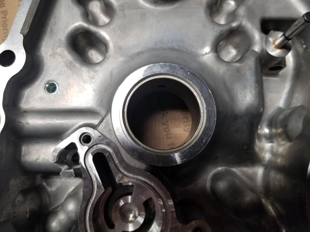

kpinnc 19,060 #19 Posted February 14, 2023 (edited) 59 minutes ago, Wild Bill 633 said: Also, there are some Kohler Command spec. nos. that have an axial thrust bearing. I have an spreadsheet from Medart which I can sort. If you post the model and spec. no. and I can check for you. The cover could also be machined on the inside to accept a thrust washer and washers. Now that definitely changes my thoughts. If you can get one of those covers worked with a bearing installed, that changes things completely. Changing the cover on a new engine is super simple. If a bearing can be added and lubricated, you would be fine to go that route. Edited February 14, 2023 by kpinnc Share this post Link to post Share on other sites
Wild Bill 633 943 #20 Posted February 14, 2023 8 hours ago, kpinnc said: If a bearing can be added and lubricated, you would be fine to go that route. You could use a sealed bearing and remove the seals. Share this post Link to post Share on other sites
kpinnc 19,060 #21 Posted February 14, 2023 (edited) 5 hours ago, Wild Bill 633 said: You could use a sealed bearing and remove the seals. Looks like the oil pump is right beside the bearing. Should be possible? Just remove the inner seal? Edited February 14, 2023 by kpinnc Share this post Link to post Share on other sites
Wild Bill 633 943 #22 Posted February 15, 2023 @kpinnc There is enough depth in the outer bore to leave the OEM bushing in the cover and bore a 2.625" hole to a depth of 0.875" which will allow the R24 bearing with a width of 0.5625" and the CR 15194 oil seal with a width of 0.3125 to fit. For the thrust bearing, I think you would be able to machine down the inside boss of the cover the same thickness of the thrust bearing and thrust washer and use crankshaft shims to adjust end play only if needed. Use the CH740-3008 IPL for reference. The Kohler P/Ns are 24 030 08-S for the thrust bearing and 52 114 04-S for the thrust washer. 1 Share this post Link to post Share on other sites
