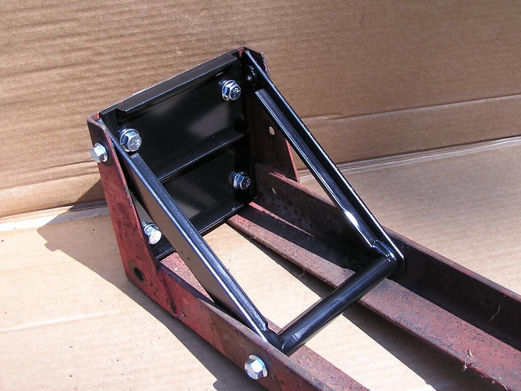

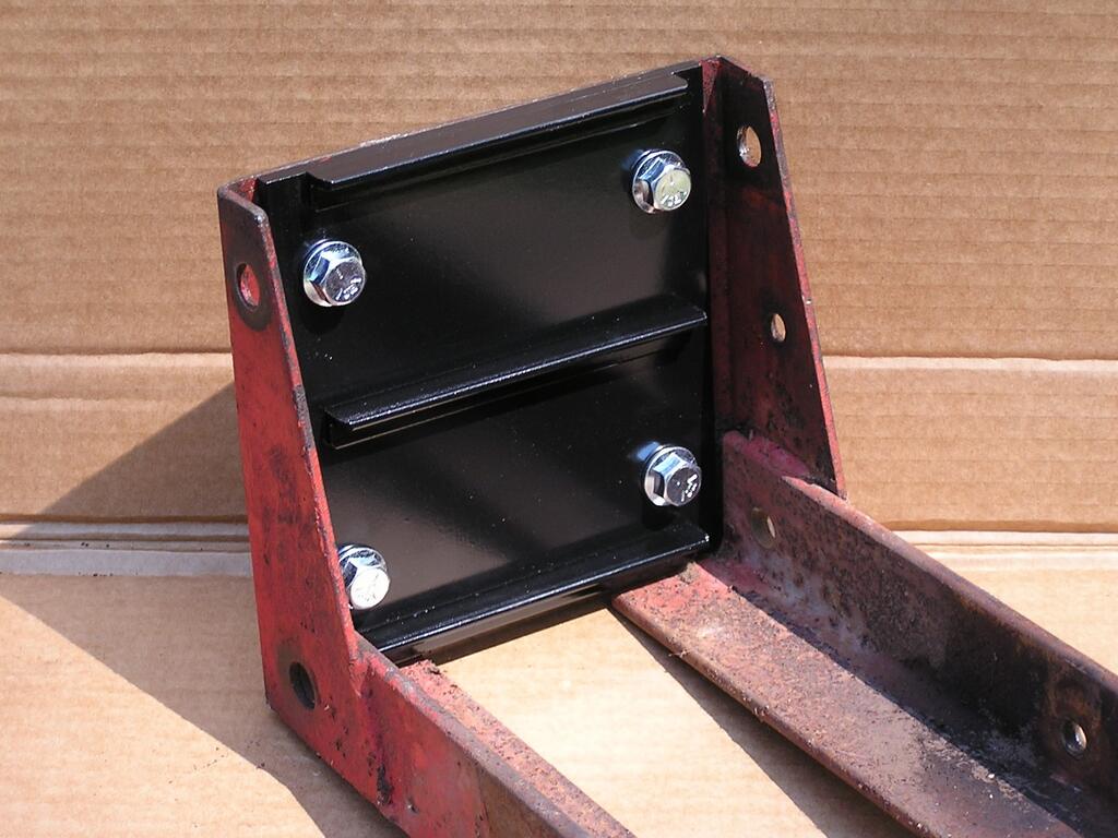

kpinnc 19,061 #40 Posted February 6, 2023 (edited) 15 hours ago, ri702bill said: Hope the frame does not look like this: Nothing a little 7018 can't fix. "V" those cracks out with a grinder and fill 'em back in both sides. Then grind smooth the side facing the tranny. Weld in a reinforcement tab like the later models have, and It'll last another 40 years. Edited February 6, 2023 by kpinnc 3 Share this post Link to post Share on other sites
ri702bill 13,316 #41 Posted February 6, 2023 4 hours ago, kpinnc said: Nothing a little 7018 can't fix. "V" those cracks out with a grinder and fill 'em back in both sides. Then grind smooth the side facing the tranny. Weld in a reinforcement tab like the later models have, and It'll last another 40 years. Good advise there. The frame I showed IS fixable, but it also has a 1/4" twist that needs to be dealt with first - I do as above, but drill about twelve 3/8" holes in the F plate so I can then plug weld the reinforcement plate in from behind, using the 4 fasteners to hold it in position. That one, because of it's crusty, rusty patina is destined to be the base for an upcoming "Yard Art" project.... 3 3 Share this post Link to post Share on other sites

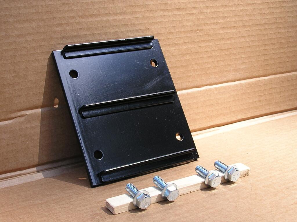

Lane Ranger 12,161 #43 Posted February 6, 2023 3 hours ago, ri702bill said: Good advise there. The frame I showed IS fixable, but it also has a 1/4" twist that needs to be dealt with first - I do as above, but drill about twelve 3/8" holes in the F plate so I can then plug weld the reinforcement plate in from behind, using the 4 fasteners to hold it in position. That one, because of it's crusty, rusty patina is destined to be the base for an upcoming "Yard Art" project.... one thing I made is a couple starter bolts to place these frames back into the four transmission holes. Just grind off the threads on a couple of the bolts and use to align frame with transmission! Then add two other bolts with threads to get in place. Saves a lot of time and stress! 3 2 Share this post Link to post Share on other sites
Sailman 1,307 #44 Posted February 6, 2023 @ri702bill I assume this repair has to be done with a bare frame, transmission removed. I have seen another option on this forum using angle irons but believe it can be done without stripping down to the frame. I have a C-120 that PO used with push blade and brinley plow that has some cracks, thankfully not as bad as the picture you posted. My spring project! 2 Share this post Link to post Share on other sites
kpinnc 19,061 #45 Posted February 6, 2023 2 hours ago, Lane Ranger said: one thing I made is a couple starter bolts to place these frames back into the four transmission holes. That is a very nice reinforcement plate. I like how you made that, as well as how you're attaching it. 1 1 Share this post Link to post Share on other sites

ri702bill 13,316 #49 Posted February 6, 2023 (edited) 57 minutes ago, Racinbob said: The frames I've repaired have all been older machines that came to me damaged. Ditto.... I also teamed up the frame plate with this triangular brace locked into the lower frame holes. These have been on the 854 8 speed for a few years now.... Edited February 6, 2023 by ri702bill 4 2 Share this post Link to post Share on other sites
