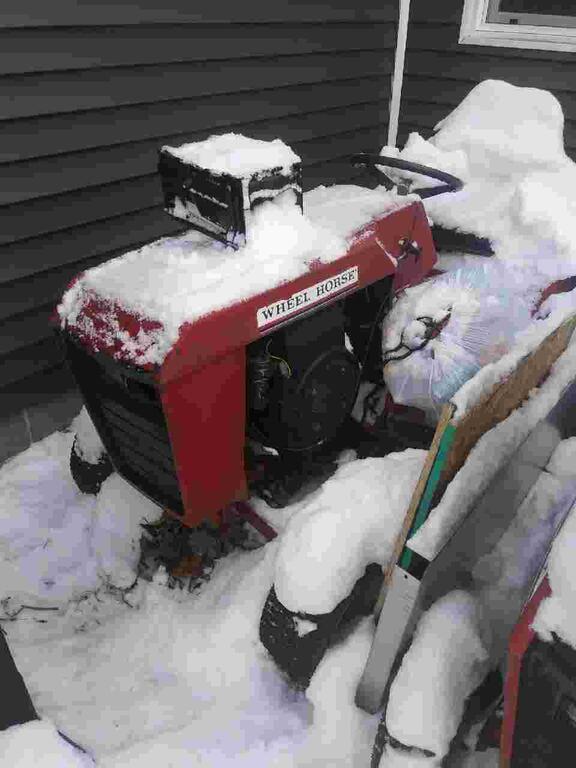

Blackm84 97 #15 Posted February 4, 2023 Ok I was leaning toward the c model, one here is a couple of pictures. Like I said I believe it is a c145 and a 1983 model year. My co-worker wants 350 for it, he has the mower deck and a few attachments with it. For an 83 I think its a pretty good start. I included the engine tag so please correct me if I am wrong on the model. 1 2 Share this post Link to post Share on other sites
Ed Kennell 47,818 #16 Posted February 4, 2023 Probably a 1984 with the Eaton 1100 hydro. 2 Share this post Link to post Share on other sites

Ed Kennell 47,818 #25 Posted February 5, 2023 3 hours ago, Blackm84 said: Only thing that scares me is the Eaton 1100 Not sure why this scares you. I have four tractors with this transmission and they all work fine. Some have over 2000 hours mowing and pushing snow. The only repairs I have done are to change a couple axle seals. BTW, $350 is the current price for a good used tiller alone. Just make sure you get all the brackets, pulleys, and lift attachment parts that are required. What does make me cringe is the picture of the poor thing stored outside covered with snow. Make sure you check the engine, transmission, and fuel system for water. Drain, clean, and flush all as required to remove any water before operating. 9 1 Share this post Link to post Share on other sites
