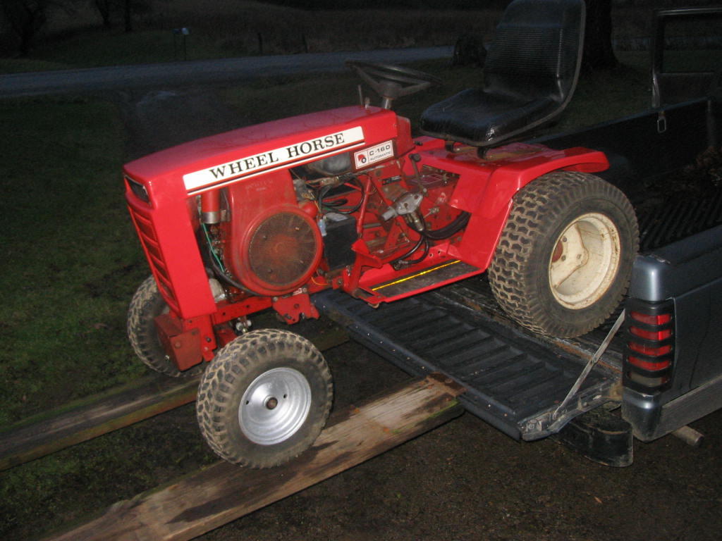

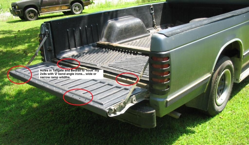

daveoman1966 3,885 #4 Posted February 1, 2023 (edited) I have a 1991 S-10 Long bed...7-1/2' inside tailgate. I use treated 2x10s, cut to 7-1/2' to lay in bed for transport and have used these for 10+ years. On the end of each 2x10, I bolted (4 bolts) a 'Z' bend angle iron, then drilled a 1/2" center hole on the side of the 'Z' that lays on the tailgate, or bed rail if tailgate is off. On the tailgate AND the bed rail, I drilled 6 corresponding 1/2" holes (3 each side) to accommodate wider/narrower tractors. A 3/8" x 2" carriage bolt is used to 'hook' the 2x10 Z bend to the tailgate/bedrail to keep the ramps from falling off or sliding either way. As a final note: I always back the tractor onto the bed and never drive up the ramps. 3 reasons: (1)I can't leap backward if a ramp breaks (2) easier to drive forward when unloading...(still can't leap backward). and (3)..better weight distribution. Edited February 2, 2023 by daveoman1966 4 1 Share this post Link to post Share on other sites
Brockport Bill 2,553 #5 Posted February 2, 2023 29 minutes ago, daveoman1966 said: I have a 1991 S-10 Long bed...7-1/2' inside tailgate. I use treated 2x8s, cut to 7-1/2' to lay in bed for transport and have used these for 10+ years. On the end of each 2x8, I bolted (4 bolts) a 'Z' bend angle iron, then drilled a 1/2" center hole on the side of the 'Z' that lays on the tailgate, or bed rail if tailgate is off. On the tailgate AND the bed rail, I drilled 6 corresponding 1/2" holes (3 each side) to accommodate wider/narrower tractors. A 3/8" x 2" carriage bolt is used to 'hook' the 2x8 Z bend to the tailgate/bedrail to keep the ramps from falling off or sliding either way. As a final note: I always back the tractor onto the bed and never drive up the ramps. 3 reasons: (1)I can't leap backward if a ramp breaks (2) easier to drive forward when unloading...(still can't leap backward). and (3)..better weight distribution. like the idea -- thanks 1 Share this post Link to post Share on other sites

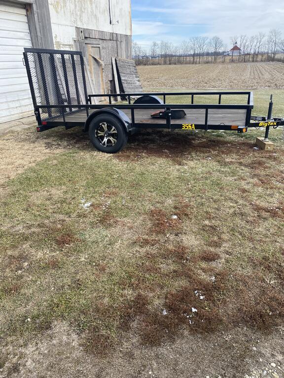

SylvanLakeWH 32,932 #11 Posted February 2, 2023 I use a 5x8 utility trailer with drop gate... cheap safer and easier. Would never ride a tractor up ramps... Would never use wood due to traction... Always back up ramps... 2 1 Share this post Link to post Share on other sites

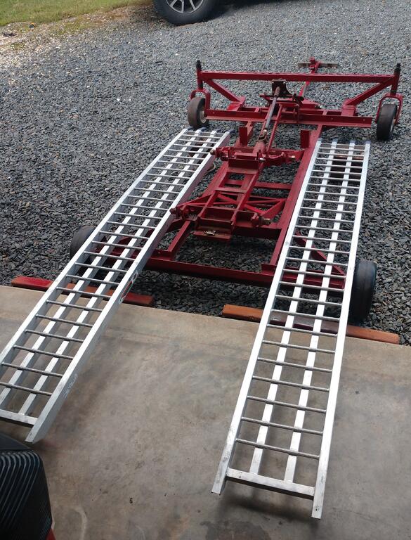

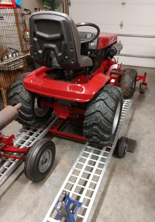

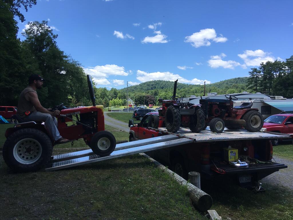

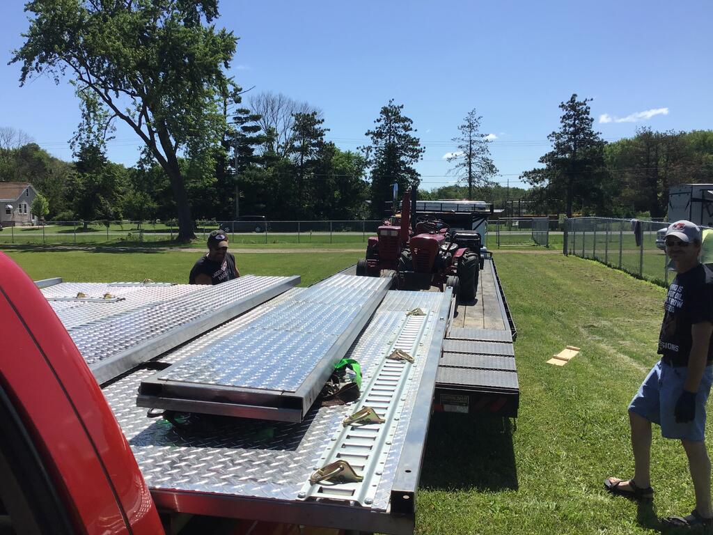

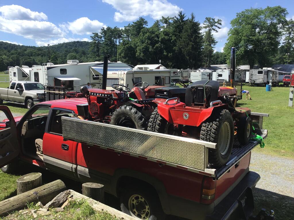

kpinnc 19,110 #12 Posted February 2, 2023 I have 7 foot curved aluminum ramps. They are rated for 750lbs each. Most of the ones I see around nowadays are similar but folding style instead of rigid. The curve makes truck loading much easier. I don't have a pic of the ramps by themselves. The ones below are all I have right now. Obviously I also use them to get on and off of my roll around lift. I never ride the tractor loading or unloading. Even though my ramps are strapped to the trailer hitch so they won't move, I let the tractor motor off in gear. I can't bench press 600lbs, so I'm not riding the tractor on or off. I've seen far too many folks flip off the ramps to try that myself. 2 2 Share this post Link to post Share on other sites
Tonytoro416 1,396 #13 Posted February 2, 2023 18 minutes ago, kpinnc said: I have 7 foot curved aluminum ramps. They are rated for 750lbs each. Most of the ones I see around nowadays are similar but folding style instead of rigid. The curve makes truck loading much easier. I don't have a pic of the ramps by themselves. The ones below are all I have right now. Obviously I also use them to get on and off of my roll around lift. I never ride the tractor loading or unloading. Even though my ramps are strapped to the trailer hitch so they won't move, I let the tractor motor off in gear. I can't bench press 600lbs, so I'm not riding the tractor on or off. I've seen far too many folks flip off the ramps to try that myself. I would like to know more about your lift there 1 Share this post Link to post Share on other sites
