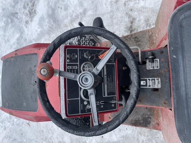

AHS 1,675 #28 Posted February 3, 2023 The gas tank on the C175 was nearly empty, so i put a 1/4 of a tank in… AND she runs without a choke! It runs pretty darn good! Ive changed the spark plugs, changed the oil, now i need to get to the hard fuel lines! I was telling @ebinmaine; “it like a time capsule” with the old WH seat, the wrapped steering wheel and the wood spinner knob! Now i need to get to the peeling paint!! 1 Share this post Link to post Share on other sites
c-series don 11,944 #29 Posted February 3, 2023 I’m not sure what went wrong with those early 80’s B,C series. The paint didn’t adhere well to the cast aluminum dash tower. Perhaps they needed to do something different to prep it? 3 Share this post Link to post Share on other sites
ebinmaine 79,021 #30 Posted February 3, 2023 10 minutes ago, c-series don said: I’m not sure what went wrong with those early 80’s B,C series. The paint didn’t adhere well to the cast aluminum dash tower. Perhaps they needed to do something different to prep it? Don that was the beginning of the paint issues that we remember from car manufacturing. This is only a supposition: Perhaps there was some sort of a prep for the aluminum that may have been no longer available or too expensive to justify. 2 Share this post Link to post Share on other sites
AHS 1,675 #31 Posted February 3, 2023 6 hours ago, ebinmaine said: Don that was the beginning of the paint issues that we remember from car manufacturing. This is only a supposition: Perhaps there was some sort of a prep for the aluminum that may have been no longer available or too expensive to justify. All of the wheel horse dash’s that I’ve seen, the paint ripped off!! 1 Share this post Link to post Share on other sites
