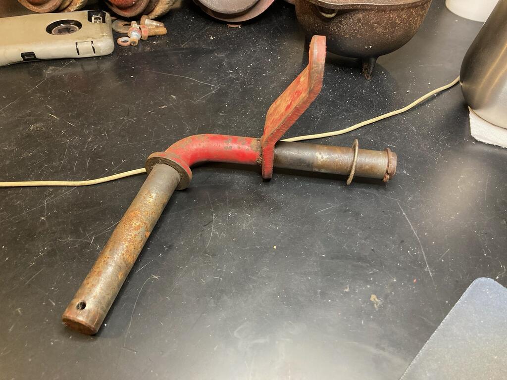

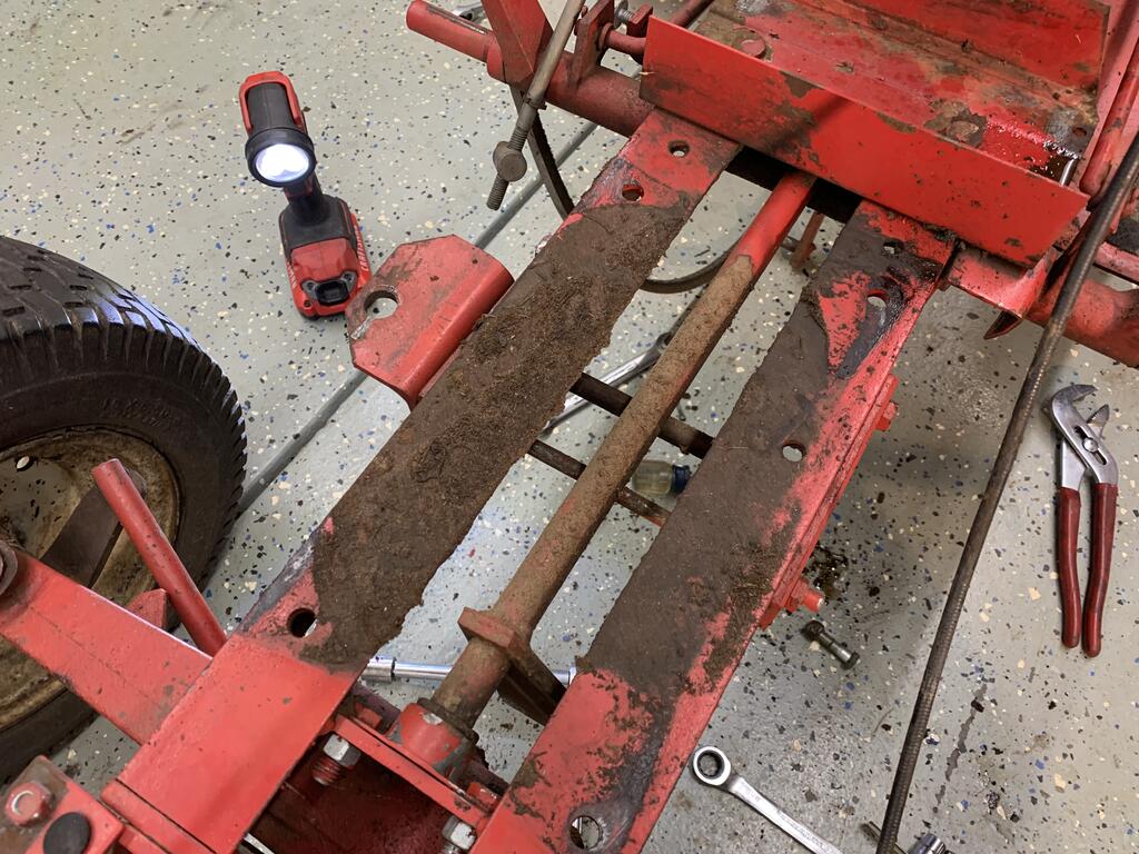

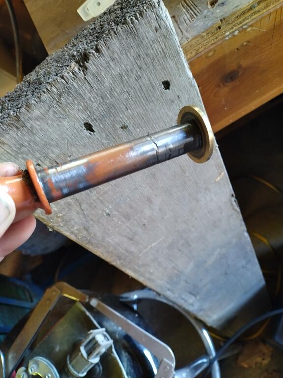

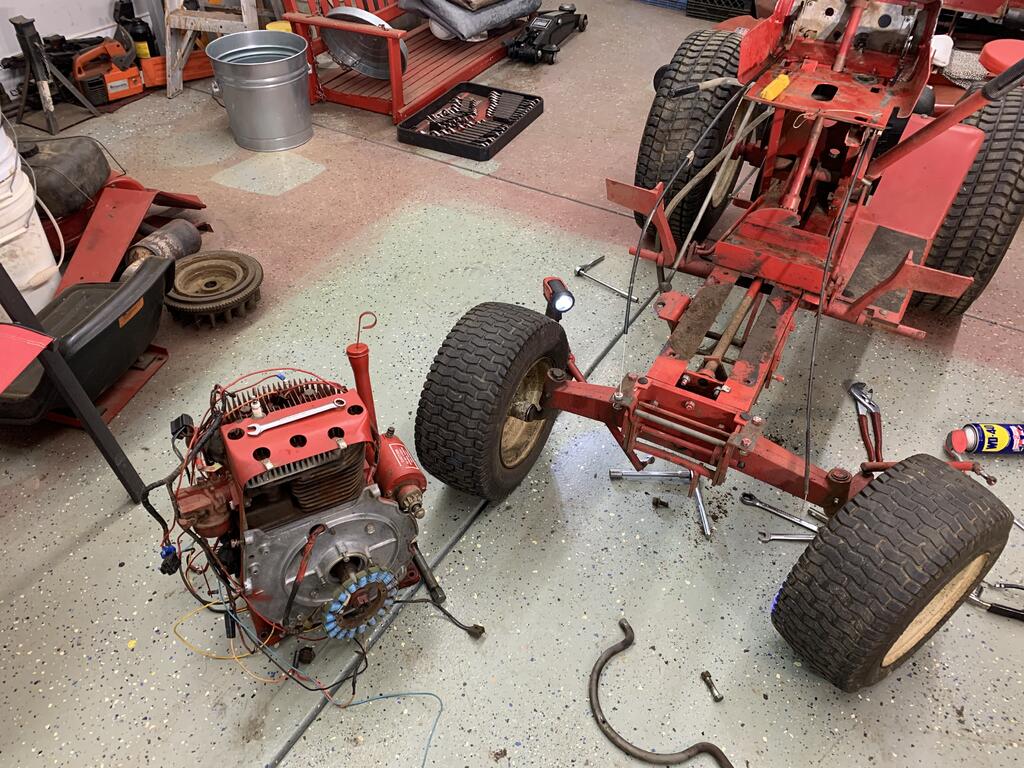

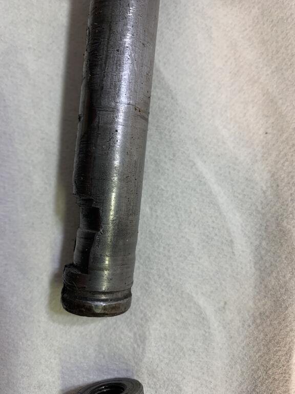

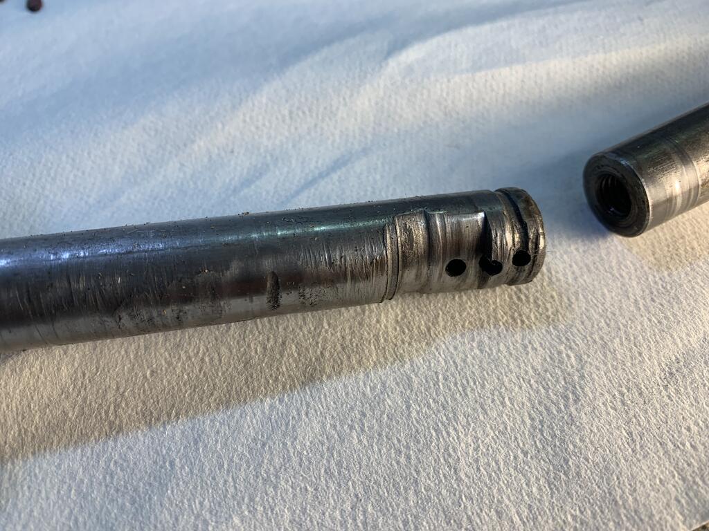

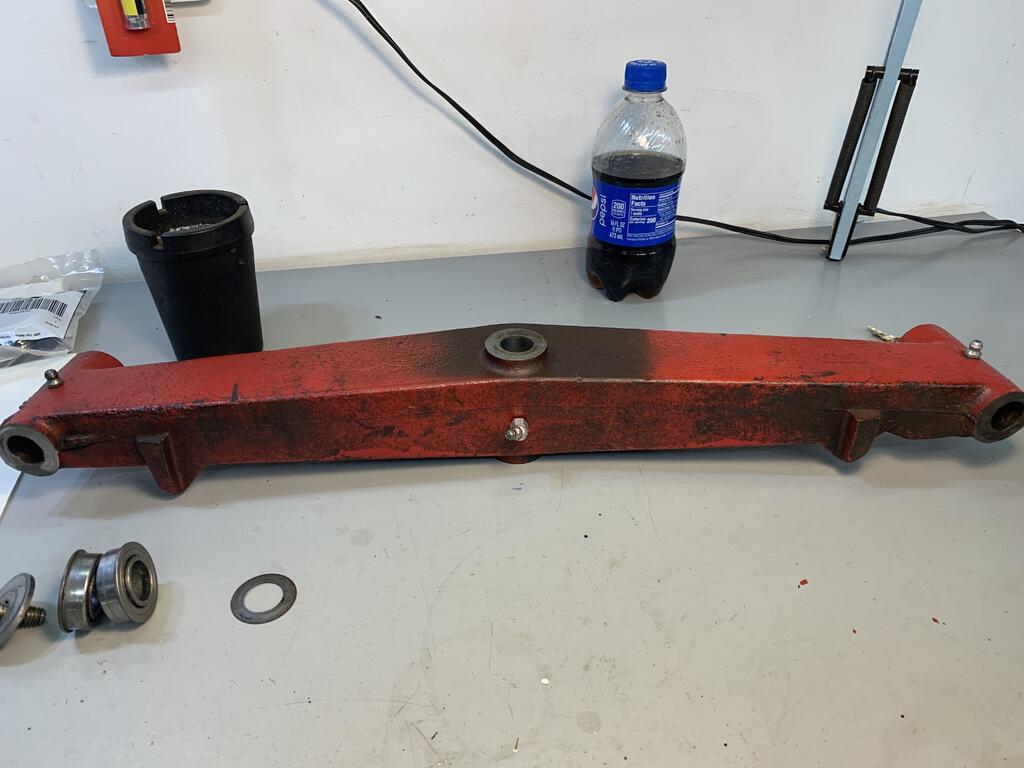

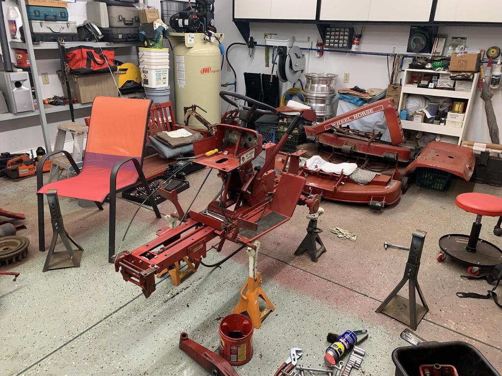

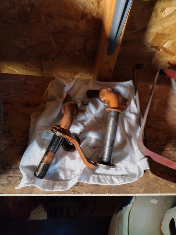

Horse Newbie 7,405 #177 Posted October 15, 2023 (edited) I started tinkering again on the 1977 C-160. Still mostly cleaning… I did take the engine off frame, drained the tranny. Tranny oil looked good… just barely a hint of chocolate milk. Dropped the front axle to clean under there. Found the axle king pin broke where they all break. I sent @ineedanother a pm because he said he may have a front spindle I need. @ebinmaine. If @ineedanother doesn’t still have the front spindle( right side) I need you to dig me one up. Took the wiring harness out… Edited October 15, 2023 by Horse Newbie 1 4 Share this post Link to post Share on other sites
ineedanother 2,885 #178 Posted October 15, 2023 Hey Tim, Glad you're back on this project. Looking good. PM your address and I'll ship this one off to you or I'll be in Charlotte November 1 and 2 for meetings if you want to get it from me there and save the shipping charges... 2 Share this post Link to post Share on other sites
Horse Newbie 7,405 #179 Posted October 15, 2023 32 minutes ago, ineedanother said: Hey Tim, Glad you're back on this project. Looking good. PM your address and I'll ship this one off to you or I'll be in Charlotte November 1 and 2 for meetings if you want to get it from me there and save the shipping charges... @ineedanother, Do you have the right one with the threaded hole in the end of the spindle ? Share this post Link to post Share on other sites

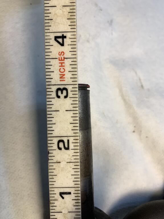

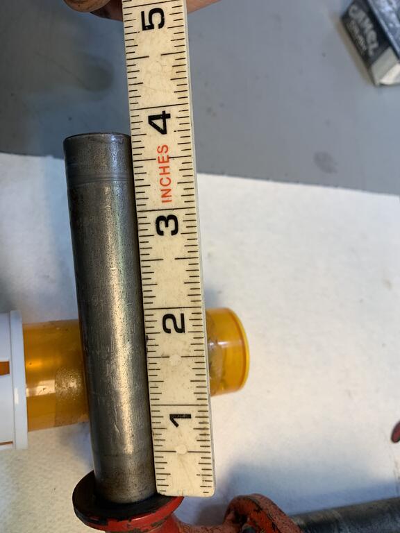

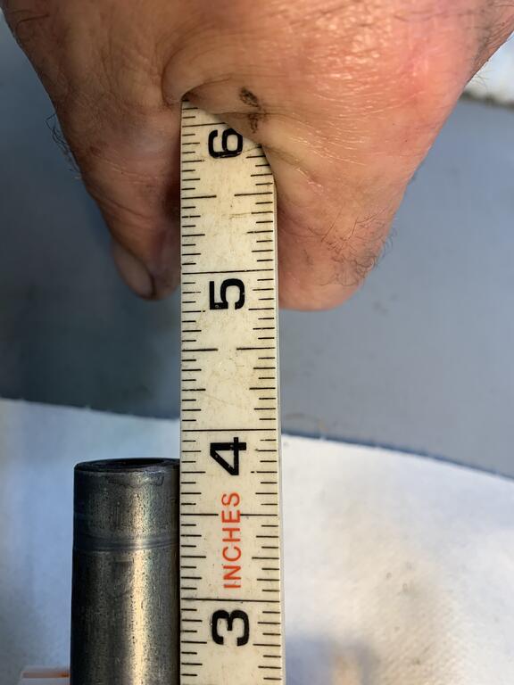

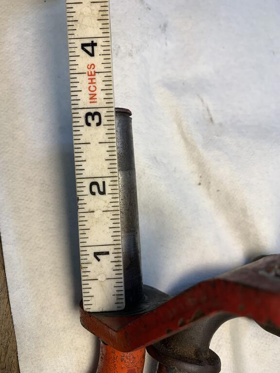

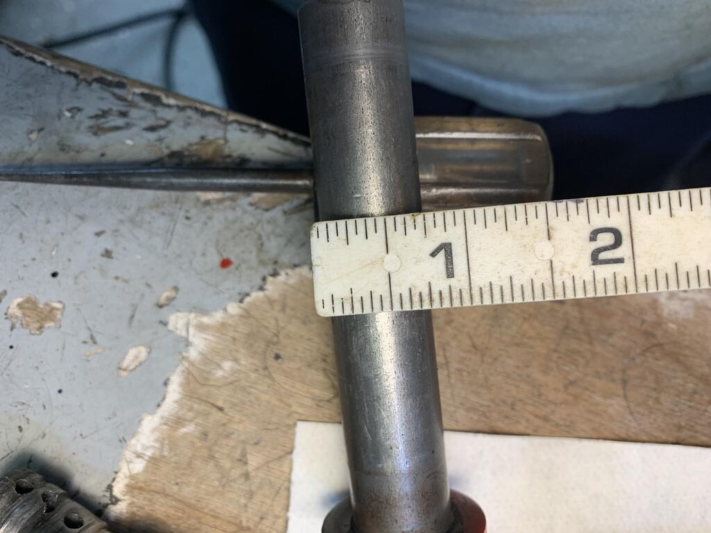

Horse Newbie 7,405 #180 Posted October 15, 2023 How long is the part that goes through the wheel ? Share this post Link to post Share on other sites
ineedanother 2,885 #181 Posted October 15, 2023 2 minutes ago, Horse Newbie said: How long is the part that goes through the wheel ? 4 1/4" . It doesn't look like I have one in the shop in that condition with the threaded end but those are shorter and this one could be cut off, drilled and tapped if you preferred that. Personally I wouldn't defer from this one with the pin. It's in really good shape. 1 Share this post Link to post Share on other sites
Horse Newbie 7,405 #182 Posted October 15, 2023 So you’re saying, if I wanted it to match the left side spindle( with bolt hole), go ahead and get yours, cut it down, and tap a hole ? Share this post Link to post Share on other sites
Horse Newbie 7,405 #183 Posted October 15, 2023 I may do that if I have to… I have another member that is looking for one too… Share this post Link to post Share on other sites
ineedanother 2,885 #184 Posted October 15, 2023 Just now, Horse Newbie said: So you’re saying, if I wanted it to match the left side spindle( with bolt hole), go ahead and get yours, cut it down, and tap a hole ? Yep. I have a threaded one but it's worn a bit. I think if you use the one with the pin you won't even remember that the other one is threaded. Share this post Link to post Share on other sites
Horse Newbie 7,405 #185 Posted October 15, 2023 One concern for me doing that would be being able to drill a straight hole in the end of the spindle, and I know I don’t have a bottom tap… 1 Share this post Link to post Share on other sites
ineedanother 2,885 #186 Posted October 15, 2023 4 minutes ago, Horse Newbie said: I may do that if I have to… I have another member that is looking for one too… No worries. Let me know though, I'll be off the grid a bit before I come to Charlotte in November. 2 Share this post Link to post Share on other sites
Horse Newbie 7,405 #187 Posted October 15, 2023 10-4… I do appreciate your willingness to help me with this. I have your phone number and may text you to update… Will you receive text while you are “off grid” ? 1 Share this post Link to post Share on other sites
ebinmaine 81,282 #188 Posted October 15, 2023 2 hours ago, Horse Newbie said: need you to dig me one up. I gotcha man. I'll see what I have here tomorrow. 1 Share this post Link to post Share on other sites
Horse Newbie 7,405 #189 Posted October 15, 2023 @ebinmaineOne concern for me doing that would be being able to drill a straight hole in the end of the spindle, and I know I don’t have a bottom tap 1 Share this post Link to post Share on other sites
Horse Newbie 7,405 #190 Posted October 15, 2023 Eric, see if you have right side, tapped for bolt, need a wheel too… 1 Share this post Link to post Share on other sites

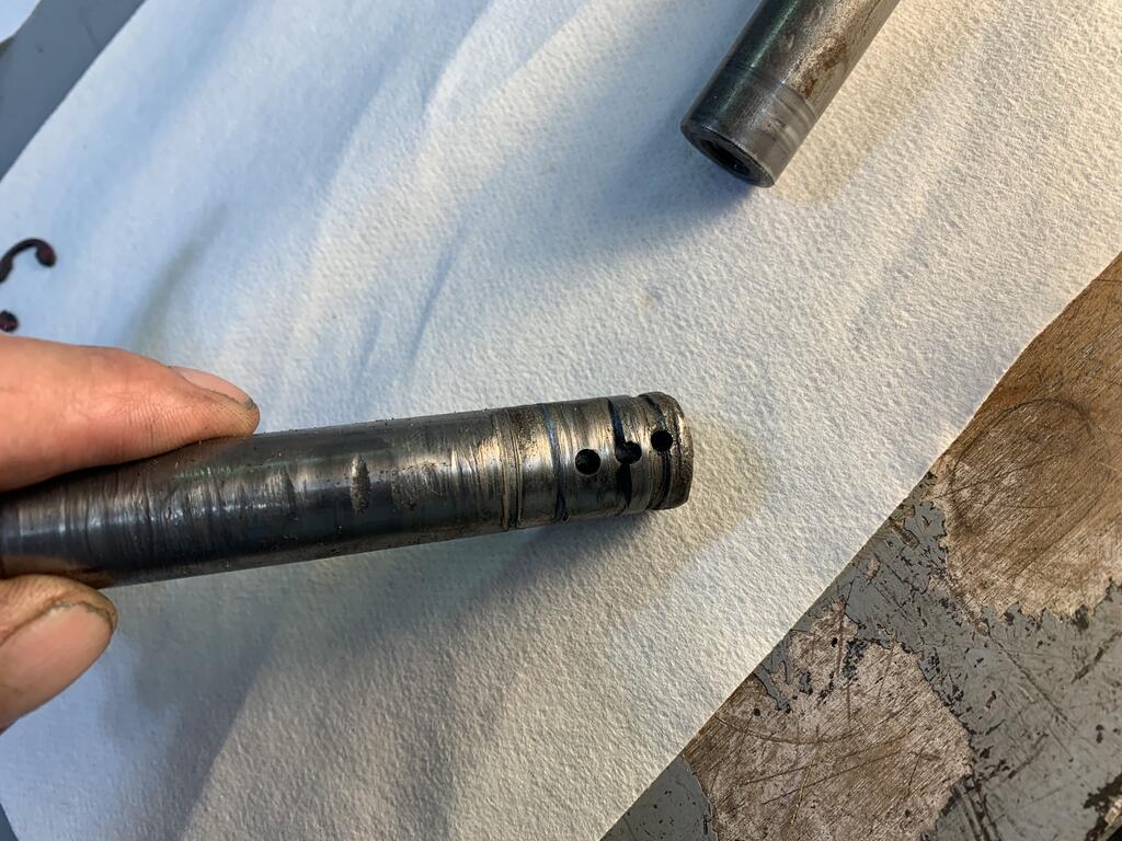

ebinmaine 81,282 #191 Posted October 15, 2023 6 hours ago, Horse Newbie said: Eric, see if you have right side, tapped for bolt, need a wheel too… I just went back and read through this thread to verify the wheel type. You have the standard 2 hole. Likely I've got some here. 6 hours ago, Horse Newbie said: @ebinmaineOne concern for me doing that would be being able to drill a straight hole in the end of the spindle, and I know I don’t have a bottom tap I personally don't have the skillset or tools to end drill or tap a shaft perfectly straight. It does need to be as close as possible so the washer is holding as much as it can of the end of the shaft to keep things tight. To clarify my thoughts about the spindles. There are 3 types I'm aware of. 1. Bolted on through/into the end. 2. Cotter pins through the spindle. 3. E or C clip slides into a groove near the end of the outer spindle shaft. I prefer to use the ones with bolts in the ends because my machines work pretty hard on very rough terrain. The other 2 types are likely just as rugged when properly installed and maintained. I have in fact spoken to folks who prefer the cotter pins because (to them) it's a more positive cross directional fastening point. I understand that logic. If your machine has 2 different types on it, it won't matter once assembled because there's a pair of grease caps that pop on at the outside. You won't see either/neither/both of the spindle ends. Your timing is good because as we transition from the two former workshops into the barn I've been spending time moving and organizing our "Parts Department". Today is another day I was planning on the so I'll see what's available here for spindles and wheels. How's your front tires? Also... Get ya impact driver out and pop that cylinder head off. Also, also... If you want/need help with the carb ~ send it to me. I'll rebuild it for the cost of parts. 1 Share this post Link to post Share on other sites
ineedanother 2,885 #192 Posted October 15, 2023 9 hours ago, Horse Newbie said: 10-4… I do appreciate your willingness to help me with this. I have your phone number and may text you to update… Will you receive text while you are “off grid” ? Yes, text. 1 Share this post Link to post Share on other sites

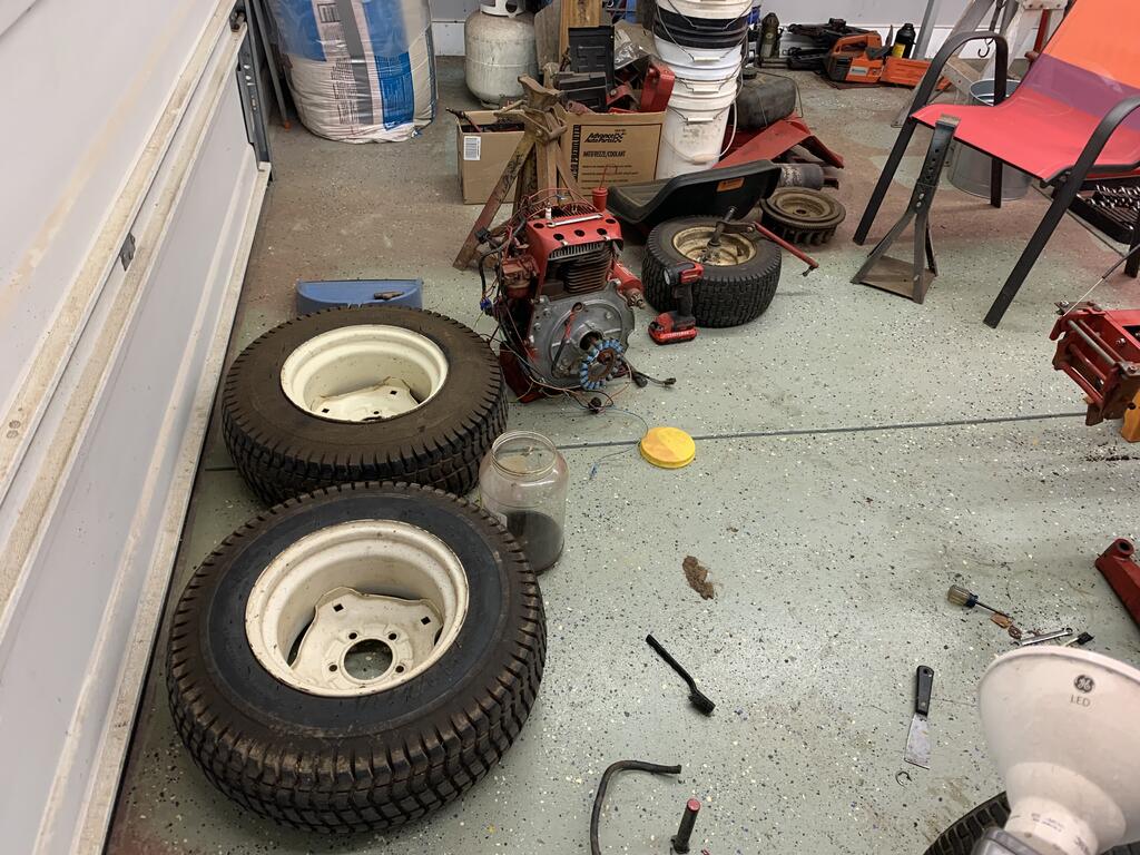

Horse Newbie 7,405 #193 Posted October 15, 2023 3 hours ago, ebinmaine said: If your machine has 2 different types on it, it won't matter once assembled because there's a pair of grease caps that pop on at the outside. You won't see either/neither/both of the spindle ends Correct… My order of preference would be… 1. Both spindles match, with the bolts in the end. 2. Both spindles match with either E/C clips or cotter pins. 3. Mismatched 3 hours ago, ebinmaine said: How's your front tires? Probably not service worthy… They leak down, and I despise having to air up a tire before I move a tractor. Even though I do check the air on my CC before each time I mow.😆 3 hours ago, ebinmaine said: Also... Get ya impact driver out and pop that cylinder head off. I was gonna try and weasel out of the decarboning… doesn’t look like youse guys are gonna let me. Guess while I’m at it may as well check/ adjust valves and knock those balance gears out… 3 hours ago, ebinmaine said: Also, also... If you want/need help with the carb ~ send it to me. I'll rebuild it for the cost of parts Thanks for being willing to do that. I have cleaned a few carbs, but I don’t have the experience that some of you fellows do. 1 Share this post Link to post Share on other sites
Bill D 3,213 #194 Posted October 15, 2023 I personally stay away from "C" clip front spindles. I had a wheel come off once when the clip broke. Bolts or cotter pin spindles are best in my opinion. Maybe someone here can cut down a C clip spindle and drill and tap it for a bolt. 2 Share this post Link to post Share on other sites

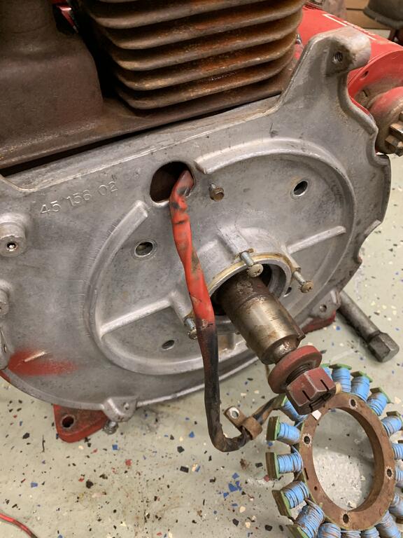

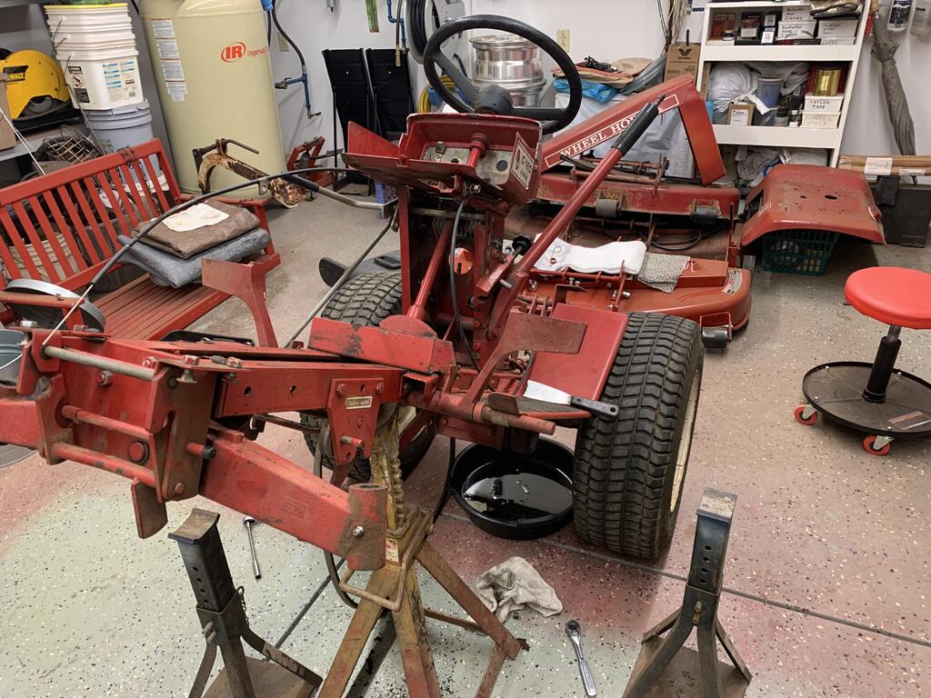

Horse Newbie 7,405 #196 Posted October 15, 2023 (edited) Aight… I done went and done it now… How does this great, big, giant, enormous piece come off ? I got the bolts out. Is the like a gasket or seal making it resist being pulled off ? Edited October 15, 2023 by Horse Newbie Share this post Link to post Share on other sites
ebinmaine 81,282 #197 Posted October 15, 2023 4 minutes ago, Horse Newbie said: Aight… I done went and done it now… How does this great, big, giant, enormous piece come off ? I got the bolts out. Is the like a gasket or seal making it resist being pulled off ? I didn't remove that. I took the bottom off. 1 Share this post Link to post Share on other sites

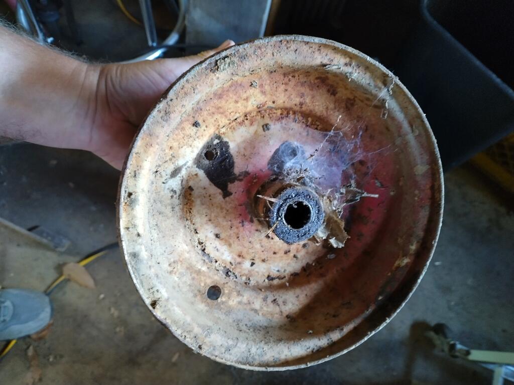

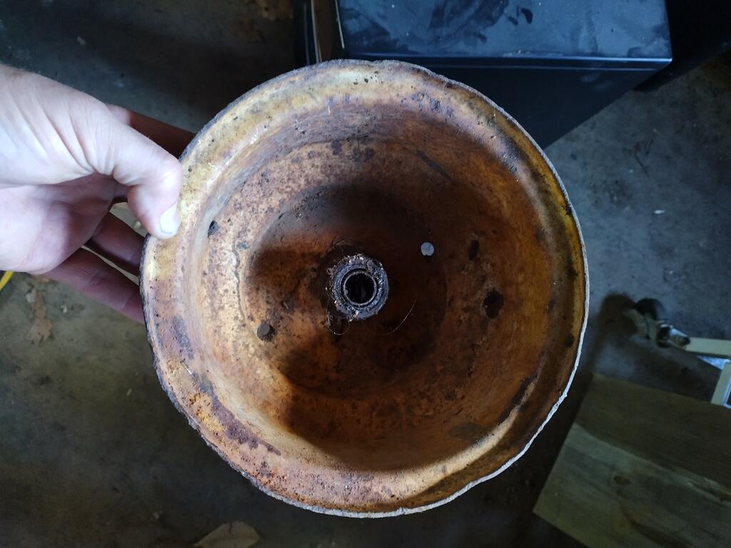

ebinmaine 81,282 #198 Posted October 15, 2023 1 hour ago, Horse Newbie said: Correct… My order of preference would be… 1. Both spindles match, with the bolts in the end. I have the old ones off Cinnamon Horse 1974 C160 from when I swapped over to a trailer hub type front spindle. The one good wheel I have is rusty but very usable. They aren't perfect but the price is right. See pics. 1 hour ago, Horse Newbie said: I was gonna try and weasel out of the decarboning… doesn’t look like youse guys are gonna let me. Guess while I’m at it may as well check/ adjust valves and knock those balance gears out… Excellent 👍👍👍 1 hour ago, Horse Newbie said: Thanks for being willing to do that. I have cleaned a few carbs, but I don’t have the experience that some of you fellows do. Glad to help.... 1 Share this post Link to post Share on other sites
Horse Newbie 7,405 #199 Posted October 15, 2023 Don’t I have to remove that aluminum plate to get the balance gears out ? Share this post Link to post Share on other sites
ebinmaine 81,282 #200 Posted October 15, 2023 6 minutes ago, Horse Newbie said: Don’t I have to remove that aluminum plate to get the balance gears out ? No sir. You really want to try to avoid removing that aluminum plate because it's a PRESSED IN bearing holder for the crankshaft. If you take the four bolts out of the oil pan then you will be able to access the balance gears from the bottom of the engine. 1 1 Share this post Link to post Share on other sites
