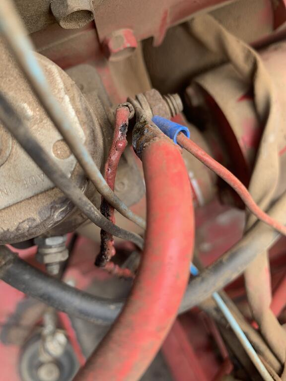

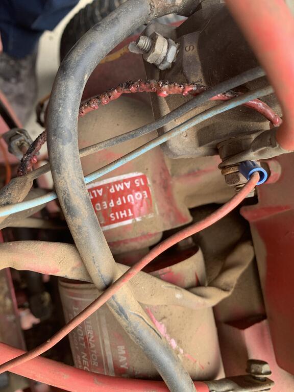

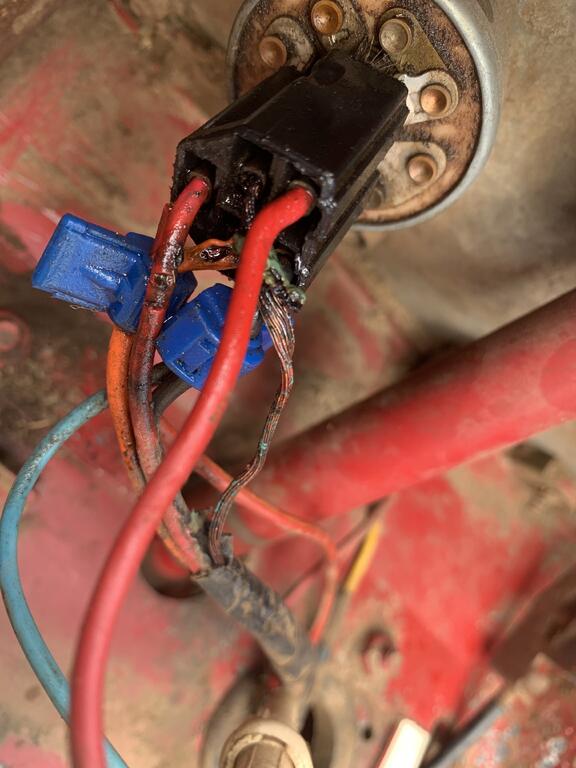

Horse Newbie 7,405 #55 Posted January 31, 2023 7 hours ago, Brockport Bill said: looks like a melted wire ?????? It is… when I was unloading it, some wire must have shorted to ground and I got some smoke. Was afraid it was gonna burn down sitting in the back of the truck. Drove 89 miles to get it home with clothesline rope holding it only to have it burn down… 1 Share this post Link to post Share on other sites
ebinmaine 80,751 #56 Posted January 31, 2023 1 hour ago, Horse Newbie said: It is… when I was unloading it, some wire must have shorted to ground and I got some smoke. Was afraid it was gonna burn down sitting in the back of the truck. No worries on that wire man. Likely once you get to poking around in there it'll be pretty easy to find the issue. 1 Share this post Link to post Share on other sites
Horse Newbie 7,405 #57 Posted January 31, 2023 4 hours ago, ebinmaine said: No worries on that wire man. Likely once you get to poking around in there it'll be pretty easy to find the issue. Yeah… when I get to checking over all the wires, it most likely will wind up being a rewire… 2 1 Share this post Link to post Share on other sites
ebinmaine 80,751 #58 Posted January 31, 2023 8 minutes ago, Horse Newbie said: it most likely will wind up being a rewire… You know, the more of these we restore the more I think that's the ONLY way to go... 4 Share this post Link to post Share on other sites
Dan.gerous 2,696 #59 Posted January 31, 2023 18 minutes ago, ebinmaine said: You know, the more of these we restore the more I think that's the ONLY way to go... We found that out the hard way this week, it was relatively quick and easy. Couldn't find the electrical fault on the C125, but replacing all the wires solved it instantly. 2 Share this post Link to post Share on other sites
Horse Newbie 7,405 #60 Posted January 31, 2023 58 minutes ago, ebinmaine said: You know, the more of these we restore the more I think that's the ONLY way to go... Well I repainted and semi-restored my 1994 520H and 1984 Work Horse GT-1600, so considering how the 1977 C-160 doesn’t seem to be beat up real bad I thought about going patina… just doing a little mechanical stuff… 3 Share this post Link to post Share on other sites
Horse Newbie 7,405 #61 Posted January 31, 2023 Of course anything I touch mechanically will probably be painted knowing me…😆 will be hard to resist… 2 1 Share this post Link to post Share on other sites

ebinmaine 80,751 #65 Posted February 5, 2023 Those spindles are readily available. I wouldn't bother trying to repair that. IIFF the bearing will sit tightly in the wheel then that can be reused. Those wires are a clear indication of a dead short somewhere. Them was 🔥 hot!! 1 Share this post Link to post Share on other sites

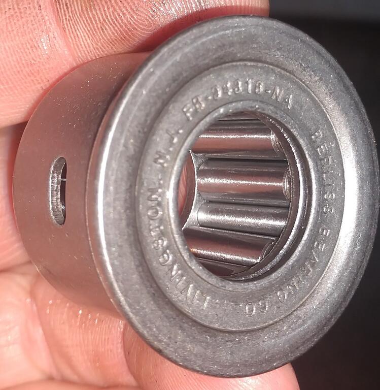

kpinnc 18,969 #67 Posted February 5, 2023 2 hours ago, Horse Newbie said: Take a look at this video… Lot of wear of course, but they're not a complete loss. Get a set of the Stens bearings below and a new spindle. It'll last another 40 years. The bearings are wide enough to reach into undamaged steel. 1 Share this post Link to post Share on other sites

kpinnc 18,969 #74 Posted February 6, 2023 On 1/31/2023 at 2:56 PM, Horse Newbie said: Yeah… when I get to checking over all the wires, it most likely will wind up being a rewire… That's what I would do. Complete rewire, and you know you're good. It's not a complex model to rewire. Heck, just bring it over here and I'll help if you want. Probably as close as I'll get to a C160 anyway! 1 2 Share this post Link to post Share on other sites
