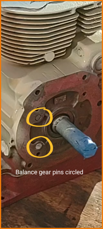

GAJoe 852 #26 Posted January 30, 2023 1 hour ago, kpinnc said: Just drive the top pin out. The lower pin's clip is easy to remove with snap ring pliers. Drive it out with a hammer and drift pin? Then retrieve it from inside and drive it back in flush with the outside? 3 Share this post Link to post Share on other sites
ebinmaine 81,282 #27 Posted January 30, 2023 8 minutes ago, GAJoe said: Drive it IN with a hammer and drift pin? Then retrieve it from inside and drive it back in flush with the outside? .... Drive it IN to the engine. Then take all the stuff out and drive the pin right back in from the outside. 2 Share this post Link to post Share on other sites
GAJoe 852 #28 Posted January 30, 2023 4 minutes ago, ebinmaine said: .... Drive it IN to the engine. Then take all the stuff out and drive the pin right back in from the outside. That's what I meant. I have a brass rod to get it moving then finish with a drift. Thanks Eric 3 Share this post Link to post Share on other sites

ebinmaine 81,282 #30 Posted January 30, 2023 Just now, GAJoe said: That's what I meant. I have a brass rod to get it moving then finish with a drift. Thanks Eric Likely you'll find it needs a LOT of "convincing" to move. You may very well crush the brass rod before the steel in cast iron moves. Mine was STUBBORN. 1 Share this post Link to post Share on other sites

kpinnc 19,107 #38 Posted January 31, 2023 48 minutes ago, GAJoe said: Drive it out with a hammer and drift pin? Then retrieve it from inside and drive it back in flush with the outside? Just make sure you don't mushroom the end of the pin. You don't want to crack the cast iron block. 2 Share this post Link to post Share on other sites
GAJoe 852 #39 Posted January 31, 2023 (edited) 11 minutes ago, kpinnc said: Just make sure you don't mushroom the end of the pin. You don't want to crack the cast iron block. That's why I want to get it moving with Kroil and brass before using more Kroil and a steel drift. And use brass to drive it back in flush. Edited January 31, 2023 by GAJoe added details. 2 1 Share this post Link to post Share on other sites
953 nut 70,656 #40 Posted January 31, 2023 56 minutes ago, GAJoe said: Then retrieve it from inside and drive it back in flush with the outside? Wouldn't hurt to put a little Blue Loctite on the last half inch of the rod as you get close to being flush. 1 1 Share this post Link to post Share on other sites

GAJoe 852 #42 Posted January 31, 2023 7 hours ago, ebinmaine said: Folks here's a still picture I got from the video of My Local Paint Department while she was spraying the K341 for me. Excellent color contrast because she had just a dusting of white over the metal and red colors. I chose to lay the engine down and drive those pins right straight through to the interior of the block. The reason I chose to push them straight through instead of trying to remove or break the interior gear is that to me it seemed like it was just easier. If this engine was on a stand and empty and I was going to have it cleaned I probably would have threaded that section and put a couple of pipe plugs in there or maybe even just used freeze plugs and indented the outside of the block with a cold chisel. Kind of like you would do for a camshaft on the old Chevy small blocks. Likely that would hold just fine because those things had oil pressure to push against and these don't. After removing the balance gears could you tell a difference in the vibration? If I take the oil pan off and they seem to not have any play or signs of wear in them would you remove them? 1 Share this post Link to post Share on other sites

oliver2-44 11,847 #50 Posted January 31, 2023 @Horse Newbie If those balance gear pins don’t want to move, it’s not hard to remove them from the inside. You can get the snap ring off the lower one with out much trouble. The upper one is hard to get snap ring off so I just split them with a chisel. Being cast iron they split quite easy with a sharp pop. Then the snap ring can be pried off a lot easier. 1 1 Share this post Link to post Share on other sites
