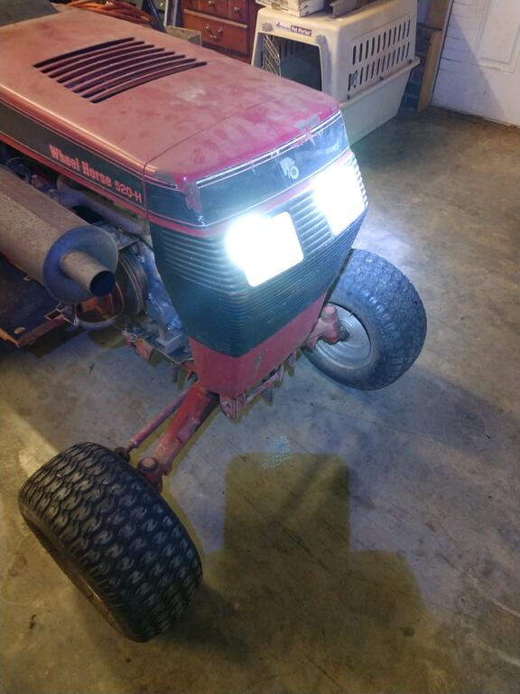

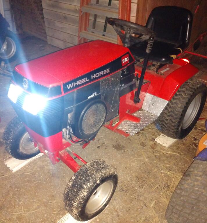

Dreamcatcher 102 #55 Posted February 9, 2023 Another question this time about HEADLIGHTS. Bulbs, can I find them at the auto parts store? If so what is the common part number for the bulbs. Thanks for your help Share this post Link to post Share on other sites
ebinmaine 81,291 #56 Posted February 9, 2023 You got me curious there so I poked around a little. Here's an old thread that has some information for you. Apparently in 1985 and/or 86 the 417 being the top of the line tractor had halogen bulbs. If you search on the internet for this number: GE H7610 You'll very likely come up with a good bright LED bulb available nowadays. 3 Share this post Link to post Share on other sites
Dreamcatcher 102 #57 Posted February 9, 2023 ahhhhh.......I was hoping for an LED replacement heehee 1 Share this post Link to post Share on other sites
ebinmaine 81,291 #58 Posted February 9, 2023 15 minutes ago, Dreamcatcher said: ahhhhh.......I was hoping for an LED replacement heehee There's bazillions of em. Just search 4411 led 2 Share this post Link to post Share on other sites
peter lena 10,127 #59 Posted February 10, 2023 @Dreamcatcher teflon washers are available at your local h/w store , in the pull out small drawer section . pete 2 Share this post Link to post Share on other sites
peter lena 10,127 #60 Posted February 10, 2023 @Dreamcatcher those lights are available on line , might even find a set at wallmart , they also have taillights , pete 2 Share this post Link to post Share on other sites
c-series don 12,757 #61 Posted February 10, 2023 (edited) GE 4411 tractor headlight, I forgot the taillight number. Just pop the rear lens cover off and pull out the bulb to match it up. Any auto parts store should have them. Edited February 10, 2023 by c-series don 3 Share this post Link to post Share on other sites
kpinnc 19,110 #62 Posted February 10, 2023 (edited) LEDs are really bright, and light on amp load. And they last forever. Plug and play. Just run a ground jumper from the hood to the frame at the pivot. That will keep them from flickering. Edited February 10, 2023 by kpinnc 2 2 Share this post Link to post Share on other sites
peter lena 10,127 #63 Posted February 10, 2023 @kpinnc agree with that grounding wire addition is so easy / important , do that on everything electrical , never count on original set up , also use mechanical electrical lugs . a no brainer , pete 1 Share this post Link to post Share on other sites
peter lena 10,127 #64 Posted February 10, 2023 @Horse Newbie https://www.bing.com/search?FORM=UP97DF&PC=UP97&q=amazon+bolt+on+electrical+lugs local h/w store or big box store , contractor section , use these on a related bolt / screw , add 10- 12 ga wire , insure that ground , pete Share this post Link to post Share on other sites

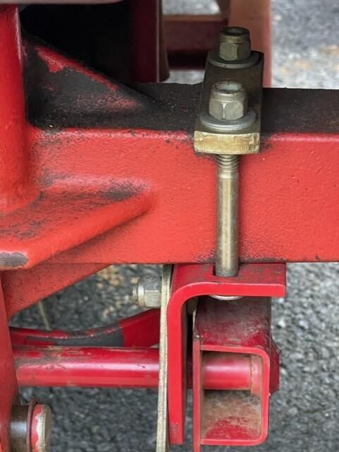

Dreamcatcher 102 #72 Posted May 16, 2023 (edited) I had some more time to poke around this morning. My tractor has the snow blade installed and teh frame goes all the way to the transmission. It looks like the only connection points for the blade frame are at the lift which looks to be just a pin and at the transmission with two nuts on each side. The round bar at the bottom of this picture is blocking the allen drain and it would seem that I must remove the plow frame to get to it. May I ask someone to confirm this is the Edited May 16, 2023 by Dreamcatcher 1 Share this post Link to post Share on other sites
c-series don 12,757 #73 Posted May 17, 2023 Yes, disconnect the lift bar then just flip up those levers that hold the round bar in place that will allow you to drop the plow and push the tractor back enough to get a drain pan under it. A small mirror will also help find the drain plug. 4 Share this post Link to post Share on other sites
