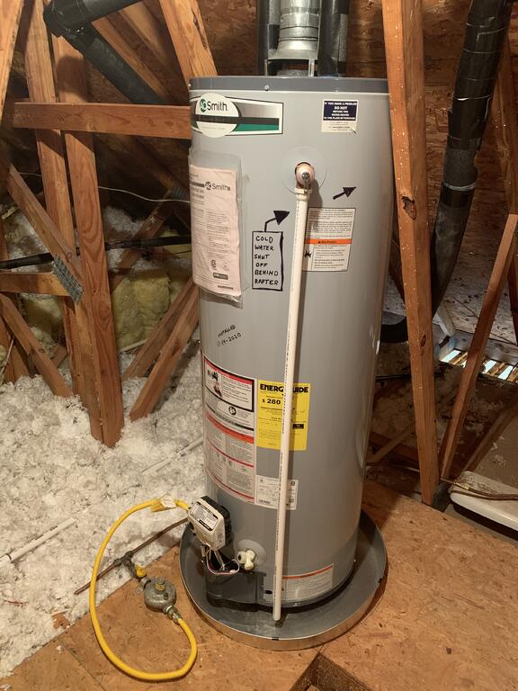

Horse Newbie 7,394 #1 Posted January 28, 2023 Hey guys I need a little advice/ help here… I got up this morning and the hot water was only warm… Checked the water heater and the pilot was off. Relit the water heater and as the flame was burning I noticed a drip sound and a ssssss like when you drop a drop of water on a hot piece of metal, and when this would happen I could tell by looking through the sight glass that the flame would change momentarily. It would drip and do this every few seconds. After the heater had run for a minutes it stopped doing this. At first I thought maybe the tank had a hole, but if there was a hole it would continue right ? I’m thinking that maybe when I lost the pilot and the burner would not flame up, the water heater cooled down and condensation formed, I relit and the condensation dripped until the moisture was gone. I plan to monitor the water heater and see what happens… what do you guys think ? A.O. Smith water heater installed 11/14/2020 1 Share this post Link to post Share on other sites

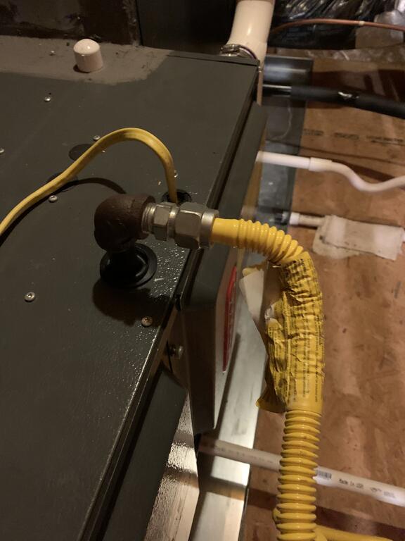

squonk 43,661 #2 Posted January 28, 2023 (edited) A leak will keep on leaking. I'm going with condensation contributing to the hiss. Roof rafters not insulated might be a bit of the cause. Not a fan of that gas line . Is this LP? Edited January 28, 2023 by squonk 2 Share this post Link to post Share on other sites
Pullstart 66,469 #3 Posted January 28, 2023 Every gas water heater condenses until the tank temp reaches 120 degrees. Normal operation there… but a great reminder to keep your t-stat at least 130, maybe 140, so it never falls to the point of condensing. Gas appliance condensation is ultra corrosive, a perfect way to find yourself in premature failure. 2 Share this post Link to post Share on other sites

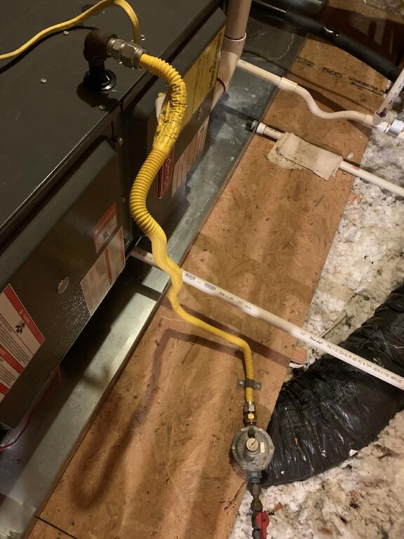

Pullstart 66,469 #4 Posted January 28, 2023 46 minutes ago, squonk said: Not a fan of that gas line . Is this LP? I was going to point that out. It needs a drop leg, to catch any debris in the gas pipe. Black pipe is always the best, and the corrugated line can easily reduce throughput on the gas, limiting the supply the burner may need. This is all observation, gas pressure measured at the valve with a manometer is always the best way to confirm. 1 Share this post Link to post Share on other sites
ri702bill 9,316 #5 Posted January 28, 2023 (edited) 9 minutes ago, Pullstart said: It needs a drop leg, to catch any debris in the gas pipe. Up here - called a mud leg - same thing, a place for any solid crud to fall into before entering the appliance. What you have is "probably not to code" And NOT sufficiently guarded to prevent leak damage if something were to fall on that flex connector... Edited January 28, 2023 by ri702bill 3 Share this post Link to post Share on other sites

WHX?? 51,649 #7 Posted January 28, 2023 (edited) They are properly called drip legs. They come from old school days when pipe was hand and even machine threaded to keep thread cutting oil out of the valve. They should be used at all appliance connections. Looks to me he had a LP system (copper lines) that was converted to 2 lb natural gas. Hence the regulator to take it down to 7" water column. Actually, guys there is nothing in the code books against the connector. Yes just condensation from a cold tank when started and should go away after run time. Just like the vapor that comes out of a tractor exhaust when first started in the cold. Yes very corrosive. this is why is best not to completely empty a tank or run it too low. Unheard of here to have it installed in an attic. Guess it the norm in warmer climes. Good to see they had the presence of mind to put it in a drip pan. Edited January 28, 2023 by WHX?? 3 Share this post Link to post Share on other sites
Horse Newbie 7,394 #8 Posted January 28, 2023 (edited) 4 hours ago, squonk said: Not a fan of that gas line . Is this LP Which gas line… the copper, or the yellow flexible connector ? Natural gas… Edited January 28, 2023 by Horse Newbie 1 Share this post Link to post Share on other sites

Horse Newbie 7,394 #10 Posted January 28, 2023 3 hours ago, Pullstart said: I was going to point that out. It needs a drop leg, to catch any debris in the gas pipe. Black pipe is always the best, and the corrugated line can easily reduce throughput on the gas, limiting the supply the burner may need. This is all observation, gas pressure measured at the valve with a manometer is always the best way to confirm. I agree with the drip leg as I have seen them in the past. I believe the gas piping was installed without a drip leg… house built in 1997, we moved in in 2007. I was also surprised to see the copper gas line also, but apparently it meets code. Black pipe comes from the gas meter into the garage wall cavity, then immediately changes over to copper. We have only a gas furnace and water heater on gas. I used the flexible connector because it was specifically stated in the instructions that a brand new connector of that type must be used ( has a built in brass body back flow preventer that came with the line ). I think code requires a flexible connector in case the water heater tips less likely to cause a gas leak… maybe they were thinking about earthquakes… 1 Share this post Link to post Share on other sites
Horse Newbie 7,394 #11 Posted January 28, 2023 (edited) 1 hour ago, WHX?? said: They are properly called drip legs. They come from old school days when pipe was hand and even machine threaded to keep thread cutting oil out of the valve Since most of my gas piping is copper ( only threaded pipe is at the meter outside and a short piece into garage wall cavity), and the fact that the gas pipe then takes an 8-9 foot vertical run into the attic, no debri will get that far, not with just 2 psi pressure… 1 hour ago, WHX?? said: Looks to me he had a LP system (copper lines) that was converted to 2 lb natural gas. Hence the regulator to take it down to 7" water column. Actually, guys there is nothing in the code books against the connector Don’t think it was LP converted to gas… city house built in 1997, and yes a flexible connector is required. Edited January 28, 2023 by Horse Newbie 2 Share this post Link to post Share on other sites
squonk 43,661 #12 Posted January 28, 2023 Copper line looks puny and is in an area where it could get damaged. Every nat gas line here in NY is black iron. No brazing soldering, flaring or compression fittings. Drip pan is nice but it that thing lets go the that pan will stop working in about a minute. 3 Share this post Link to post Share on other sites

Horse Newbie 7,394 #14 Posted January 28, 2023 58 minutes ago, Horse Newbie said: think code requires a flexible connector in case the water heater tips less likely to cause a gas leak… maybe they were thinking about earthquakes I said wrong… you have to have black pipe inside and through the furnace/ appliance cabinet… then you can connect the flexible connector… 1 Share this post Link to post Share on other sites

Blasterdad 3,044 #16 Posted January 28, 2023 7 hours ago, Horse Newbie said: Make sure that copper line isn't touching the gang nailer on that roof truss or any other metal besides copper, it will eat a hole in it... 2 Share this post Link to post Share on other sites
Horse Newbie 7,394 #17 Posted January 28, 2023 10 minutes ago, Blasterdad said: Thanks… I will definitely check the hangers and copper line… 1 1 Share this post Link to post Share on other sites
Horse Newbie 7,394 #18 Posted January 28, 2023 (edited) 2 hours ago, squonk said: Drip pan is nice but it that thing lets go the that pan will stop working in about a minute I hear ya… Agree… a catastrophic tank failure would over flow that pan immediately… guess that’s what insurance is for… A slow leak, which I noticed coming from the drain pan drain line is how I found out about needing a new water heater in Nov. 2020. Edited January 29, 2023 by Horse Newbie 1 Share this post Link to post Share on other sites

WHX?? 51,649 #24 Posted January 29, 2023 5 hours ago, Horse Newbie said: I was also surprised to see the copper gas line also, but apparently it meets code. It does as long as forged flare nuts are used as as opposed to water line flare nuts. Quite common in retrofit LP to natural retrofits. 4 hours ago, Horse Newbie said: All this talk about water heaters has me wondering… Do any of you fellows drain/ flush Nope ... nowadays it all goes to hell just replace it. That's what they want you to do so you buy another box and Pullstart's wife keeps her job. You don't mess with a 10 year old water heater you just replace it. Just happy this doesn't apply to our tractors. 1 1 Share this post Link to post Share on other sites
