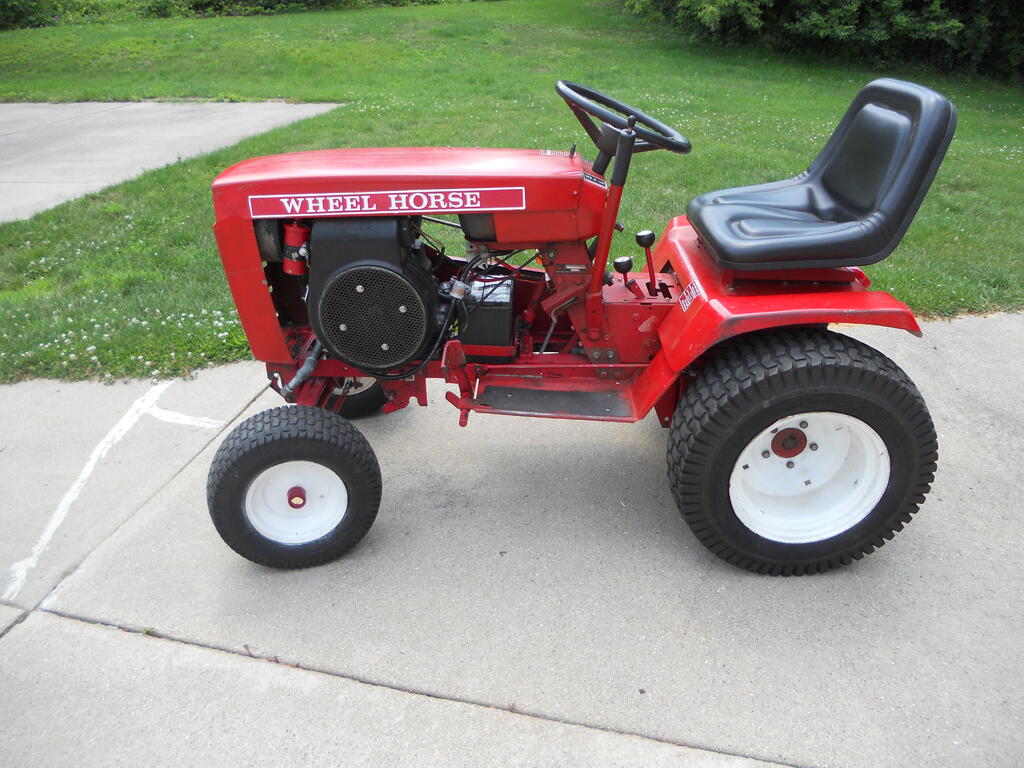

Racinbob 13,286 #14 Posted January 27, 2023 (edited) The 76 and 77 B's were identical to the C's other than a few minor things. Rear tires were 22.7.50 vs 23.850, low back seat vs high back, 13" steering wheel vs 15", headlights optional vs standard and of course engine size. I bought this 76 B-80 brand new. A couple years later WW Grainger sent out microfiche pricing for dealers only that had special pricing. Kohler K-341's for around $250. They even had the correct threaded holes in the oil pan for the frame bolts from underneath. So I gave birth to my B-160. The low back seat went on a Commando 800 restoration, found a set of 23.850's, a headlight kit and it was good to go. Just need to get a couple B-160 8 Speed decals. Edited January 27, 2023 by Racinbob 1 5 2 Share this post Link to post Share on other sites

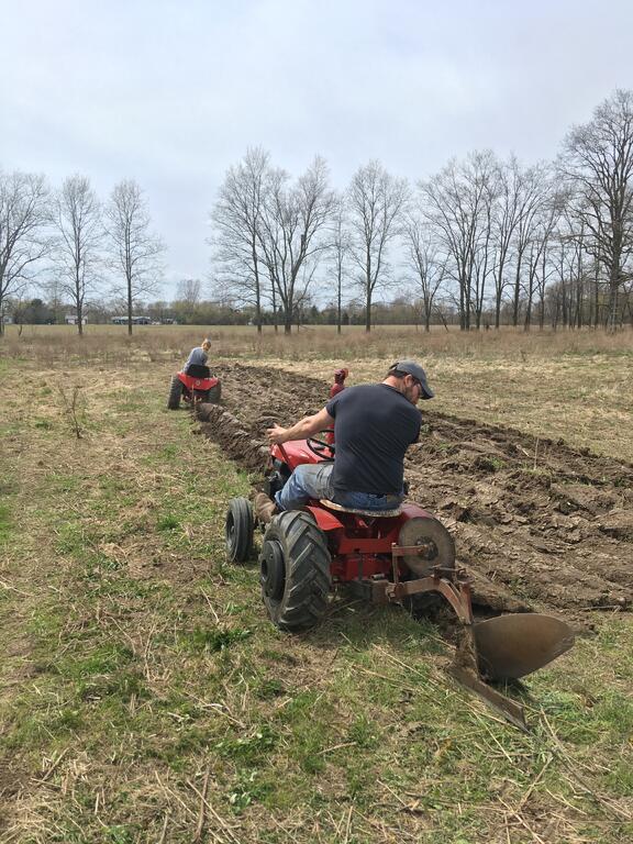

Pullstart 71,516 #15 Posted January 27, 2023 @Dreamcatcher! I agree with @ebinmaine, there is no need to look down upon a 8 horse, as inferior. My 502 is heavily modified, with an 8 hp engine (originally 5 hp) and a C-series transmission, among other things. I can pull a 10” plow through the dirt with only tr@cation being the limiting factor. 2 3 Share this post Link to post Share on other sites
kpinnc 19,060 #16 Posted January 28, 2023 I've plowed dry red unbroken clay with an 8 inch moldboard and my 867. Those little Kohlers are stout! 3 2 Share this post Link to post Share on other sites
