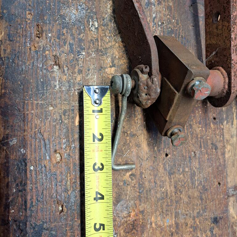

Blasterdad 3,167 #3 Posted January 26, 2023 (edited) Only one I have on file at the moment, if you zoom in on it you can see it better. Edited January 26, 2023 by Blasterdad 1 1 Share this post Link to post Share on other sites
Blasterdad 3,167 #4 Posted January 26, 2023 3 hours ago, TractorEd said: I’m not able to find one, but in the parts manual it just looks like a piece of wire rod bent into shape. That's pretty much all it is... 1 Share this post Link to post Share on other sites
TractorEd 675 #5 Posted January 26, 2023 14 minutes ago, Blasterdad said: Only one I have on file at the moment, if you zoom in on it you can see it better. I can’t enlarge that pic on my phone for some reason. I’ll have to look on my laptop tomorrow morning. I appreciate the help! 2 Share this post Link to post Share on other sites

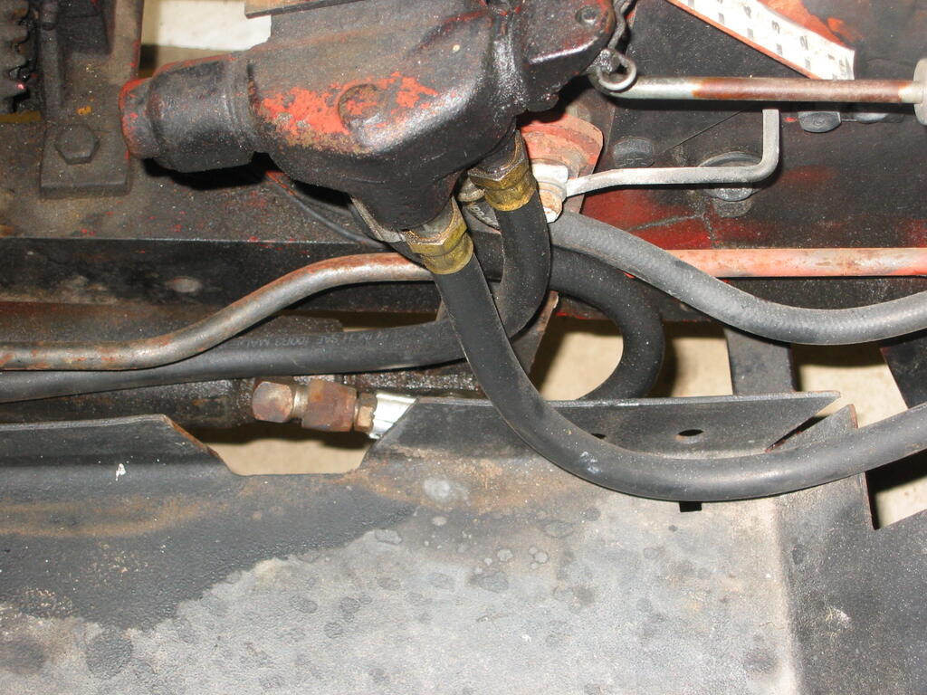

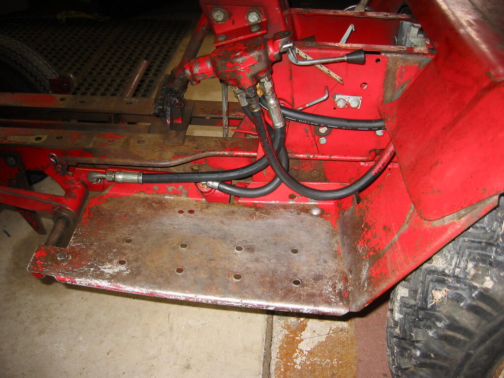

WHX?? 57,384 #7 Posted January 26, 2023 Should be easy to make. 2 2 Share this post Link to post Share on other sites
Blasterdad 3,167 #8 Posted January 26, 2023 @pfrederi & @WHX?? Those are great pics but are for older models, he is looking for one on a C-161, they are on the inside of the side cover & have a "C" bend on the end of the rod. As stated, would be easy enough to make one though... 1 Share this post Link to post Share on other sites
