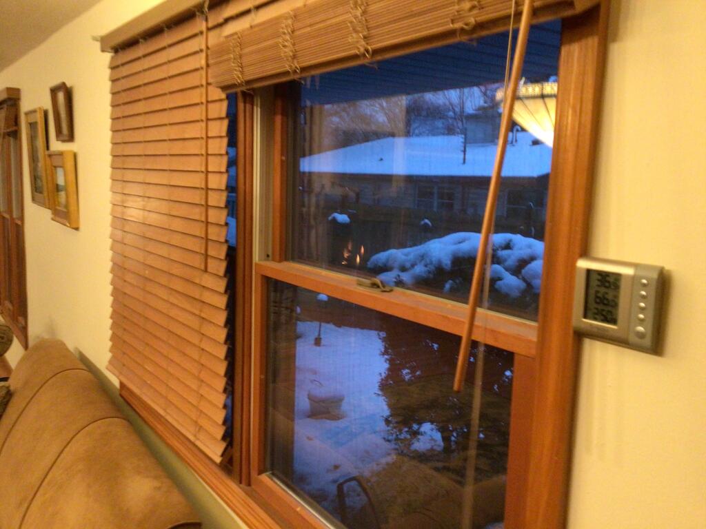

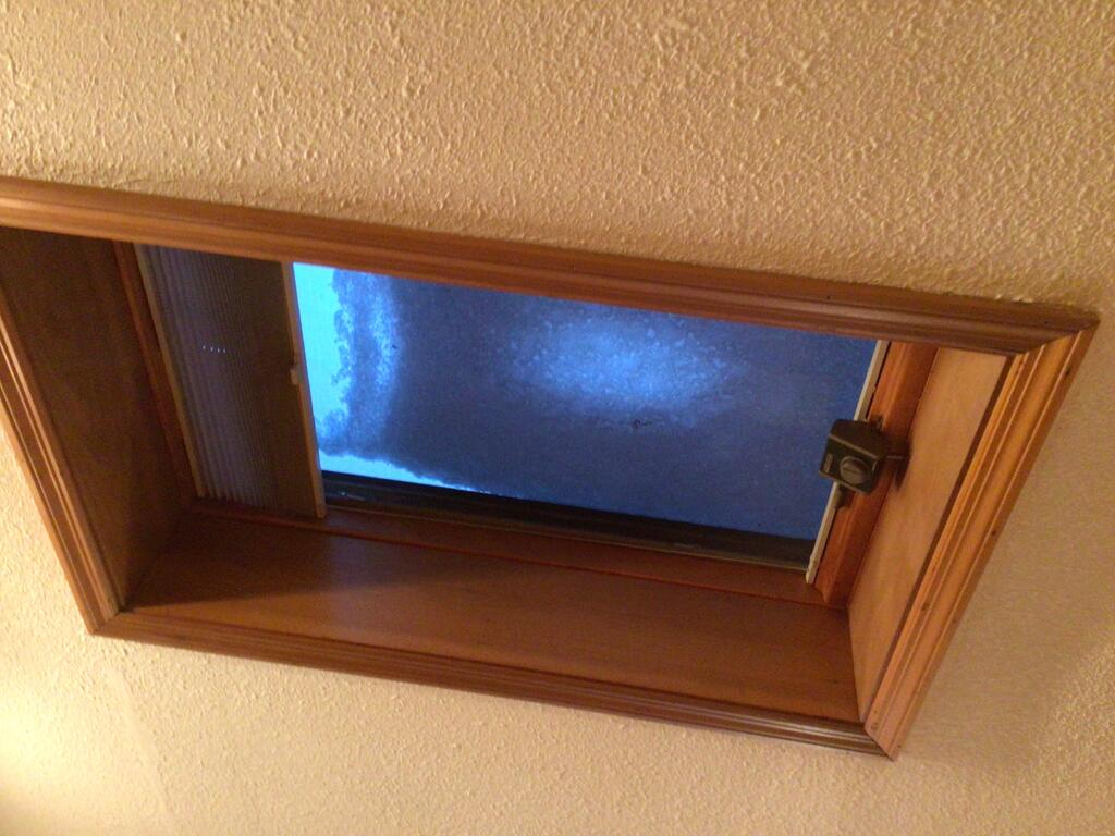

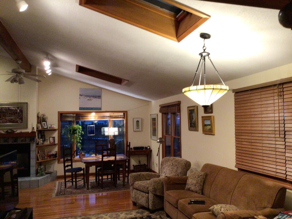

Lane Ranger 11,823 #2 Posted January 25, 2023 (edited) Yes someone does! Our rear room on our home was designed by the architect son in law of the previous owner, Andersen Windows were the install on 1992. We moved in in 2002 - twenty years ago. So our old house had many windows and two furnaces. I had experience with window conversion kits from Marvin Windows that converted old windows with iron ballasts and single panes to double pain with plastic sides that allowed the sashes to be opened inside to clean on top and bottom. These were great and at the time about $200 per window. I think I changed eight windows. I went to the local Andersen Window distributor in our area and ordered my first two window kits about 2006. The old dual glass sash was not leaking but is was dated. I decided after reviewing all the options to buy love E glass with radon gas in the insulating unit. I bought four window kits as that had the oldest units. The rest are motorized skylights and ash no longer made by Andersen. I am very pleased with them and easy to install yourself. I was able to match the wood stain used on our originals and trim with no problems. No trim had to be removed or changed. I attached some pics with a view of the white plastic channels used on the frame to allow tracks for the new sash. We do have vinyl windows in the older portions of our house that were put in by previous owners probably in late 1980s or early 1990s. Several have leaking insulating units (double glass) . Edited January 26, 2023 by Lane Ranger 4 1 Share this post Link to post Share on other sites

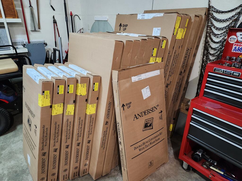

Racinbob 12,812 #20 Posted February 22, 2023 They said it would take 5 weeks but 3 days short of 4 weeks and here they are. I opened up one of the small units to see what all was in there. With the simplicity of installing these there wasn't all that much. Left and right replacement jamb assemblies, a few odds and ends and, of course the 2 sashes. We need to wait until things warm up more but I'm looking forward to getting started. My SWAG estimate is about 2 hours each (after the first one). The only supplies needed are sealant and 2.5" drywall screws which I'll use stainless. As mentioned, one of the biggest things and almost a must for the boss is the complete lack of disruption to any of the trim or window frames. Being able to do them at our own pace as weather and time permits is also pretty cool. I had a little chuckle with the delivery guys. They called when they were an hour away. They asked if we had the 'workers' there to help unload. I told them "Yup, they're all here". When they got here my wife and I met them in the garage and they asked where the 'workers' were. I told them they were looking at them. The sad part was that they were 'kids' and I guess they figured they needed a big crew to help unload 19 boxes. The only units my wife couldn't handle herself were the biggest ones. Once we get this done we may find the hardest part is figuring out what to do with the 39 thermopane window sashes we removed. 1 1 Share this post Link to post Share on other sites
