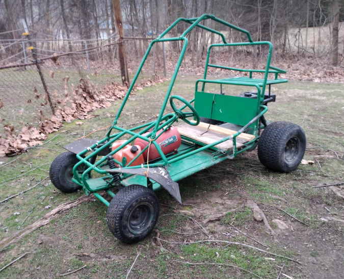

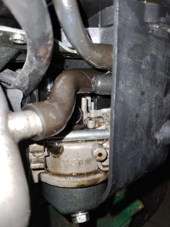

TJ5208 1,841 #1 Posted January 22, 2023 (edited) I Recently purchased this go-kart which has a stage 3 212 predator motor on it and I went riding today and I was going up and down Hills probably sloshing the oil everywhere I was running it pretty hard I'm not sure how many RPMs it turns but it turns quite a few and it just started sputtering and cutting out and I just got to a stop sign so when I stopped it died so I got off it was going to start it back up and then I seen oil was dripping on the ground and when I looked there was oil all over the carb I'm not sure if it's in the carb I didn't really have the chance to work on it so it's about 5 miles from home right now a nice couple seen me standing on the side of the road with it and they asked the people across the road if I could leave it in their front yard until I can fix it or come pick it up so the people let me. According to some of the research it may because of too much crankcase pressure which would cause it to blow oil. So would it still be fine to maybe take it easy on it and try to get it home or should I try to work on it and see what's wrong with it while it's sitting there I don't have access to a truck so I have to drive it home I'm not sure if it runs or not and of course I would want to check the oil level but I just want to get you guys's opinion on if I should try to get it home or if I should try to work on it where it sits which will not be easy because I don't have transportation. Edited January 22, 2023 by TJ Salyers Share this post Link to post Share on other sites

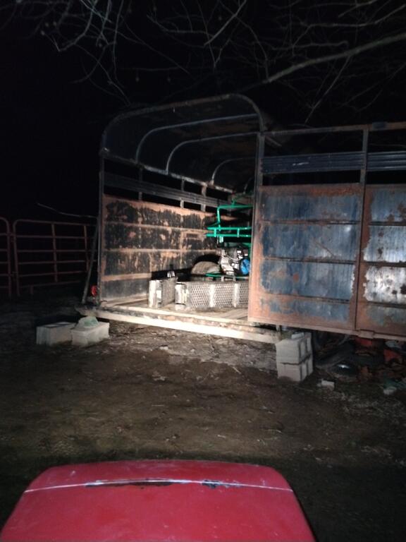

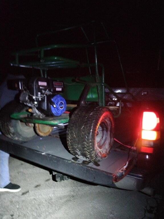

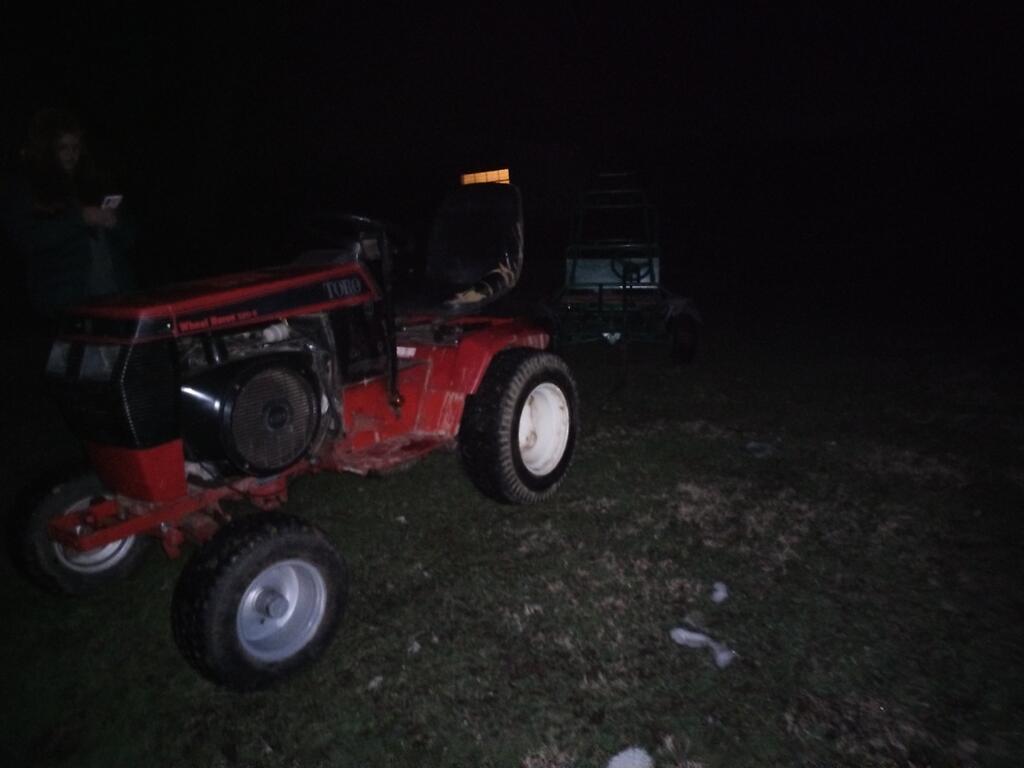

TJ5208 1,841 #17 Posted January 25, 2023 (edited) My brother came and got it. So it's home and looking at it the hose fell off. Got the ole 520-8 out and pulled the Go Kart to the horse trailer. Edited January 25, 2023 by TJ Salyers Share this post Link to post Share on other sites
