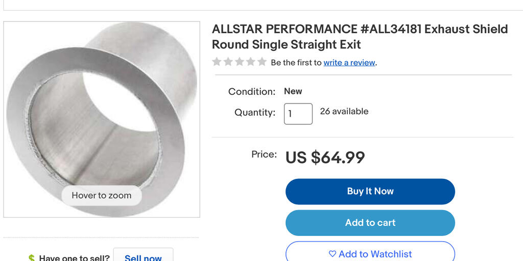

Pullstart 71,571 #1 Posted January 18, 2023 Hey y’all, I’m looking for ideas. I need to run a piece of 1-1/2” exhaust through the sidewall of a trailer race trailer. There is no insulation, but I’d like a trim ring for asthmatics and wouldn’t mind making it dual purpose like a wood stove “thimble”. Trying not to break the bank, I’m thinking something like a boat hull exhaust, or the like. I am seeing stuff over $100 but we have $30 into the pipe for the job. Thoughts? Ideas? Sources? Share this post Link to post Share on other sites

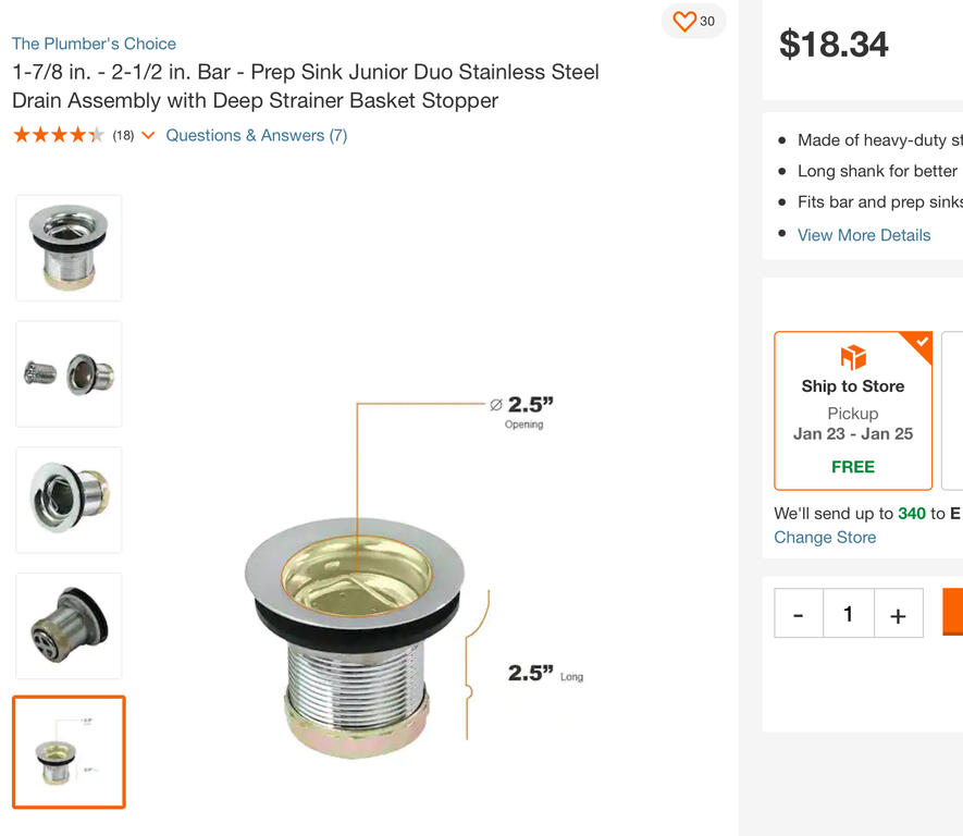

Pullstart 71,571 #2 Posted January 18, 2023 Might have a winner! cut the bottom out of a sink drain! 1 Share this post Link to post Share on other sites

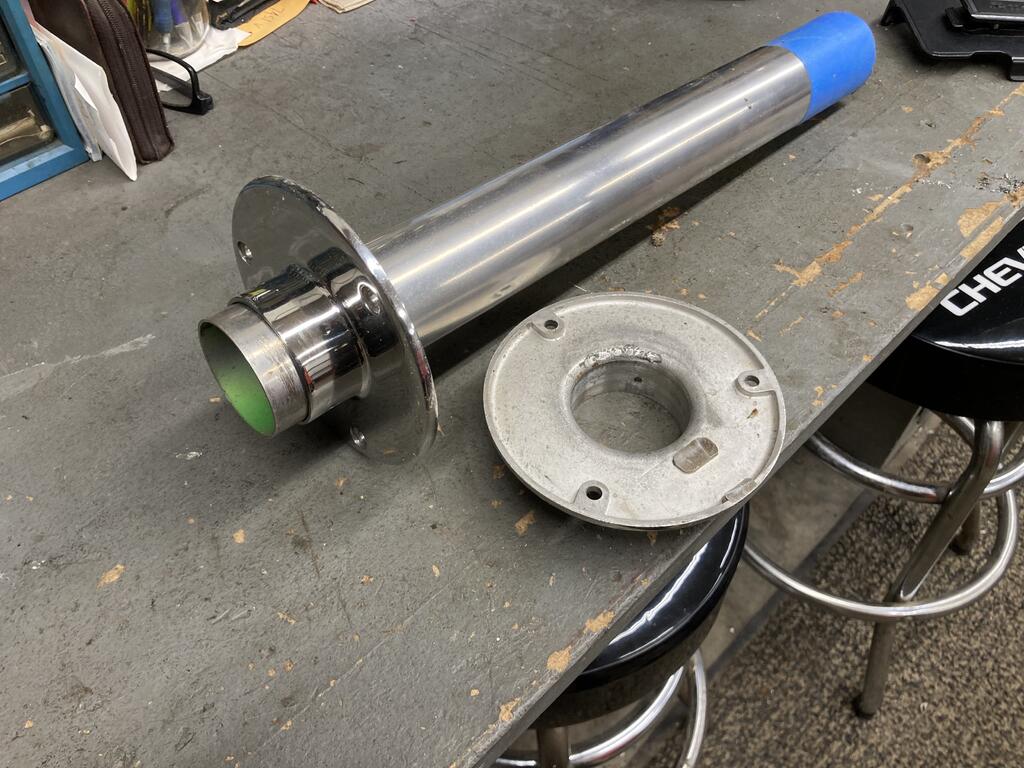

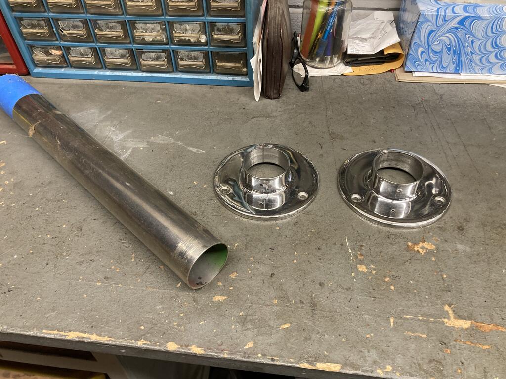

Blasterdad 3,168 #3 Posted January 18, 2023 Pretty sure these will work for ya, 2" chrome flanges that fit a 2" OD stainless pipe. ID ends up 1 7/8. Pipe is 17" long, should be plenty. I'm about a 1/2 hour drive from ya, come get 'em... Message me if ya want them.... 4 Share this post Link to post Share on other sites
Pullstart 71,571 #4 Posted January 18, 2023 Woah! Might delivery and a Ride Away Senior ride be anything that entertains ya? I’m not in a huge hurry… a week or so. Share this post Link to post Share on other sites
Blasterdad 3,168 #5 Posted January 18, 2023 4 minutes ago, Pullstart said: Woah! Might delivery and a Ride Away Senior ride be anything that entertains ya? I’m not in a huge hurry… a week or so. Works for me... Share this post Link to post Share on other sites

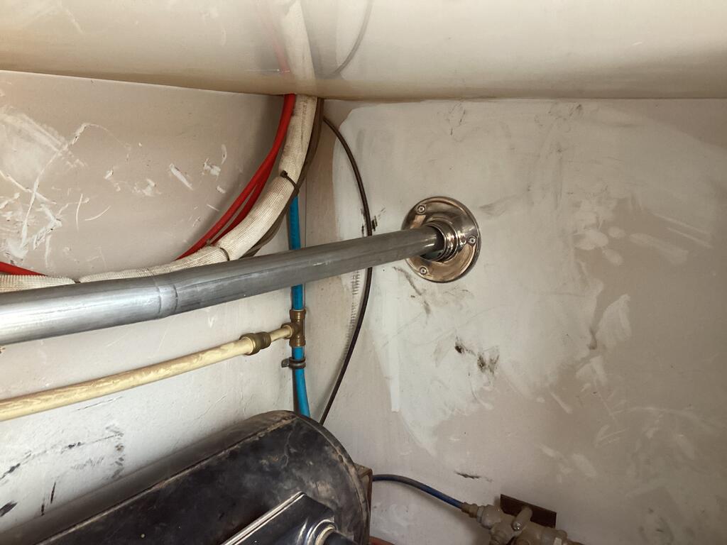

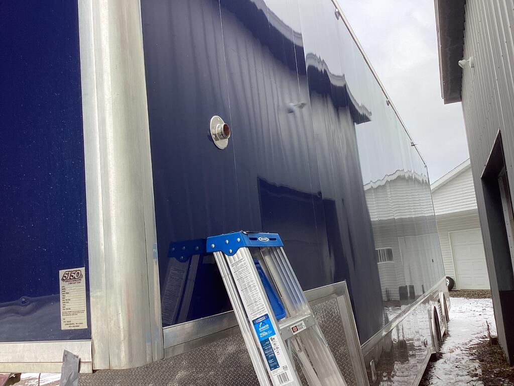

Pullstart 71,571 #9 Posted January 24, 2023 Thanks again @Blasterdad for your generosity! It made this generator so much better! The diesel exhaust was routed through the body and down to the bottom of the trailer, fumigating everyone inside. Along with the terrible choice to put it down low, it was banging in the body of the trailer too. The exit is now about 7’ or so off the ground and on the opposite wall of the entry door. 2 1 Share this post Link to post Share on other sites
Blasterdad 3,168 #10 Posted January 24, 2023 Way better setup! Looks great! 1 Share this post Link to post Share on other sites
