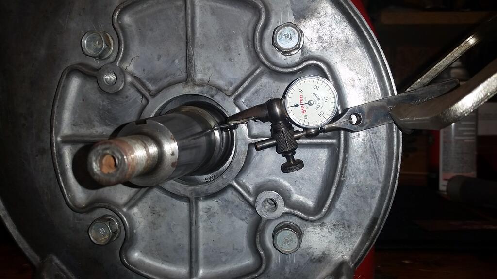

WHX?? 57,808 #7 Posted January 16, 2023 I measure the gaskets/ spacers but then measure the end play. 2 1 Share this post Link to post Share on other sites

Wheelhorse#1 1,962 #10 Posted January 16, 2023 (edited) 51 minutes ago, WHX?? said: I measure the gaskets/ spacers but then measure the end play. @WHX??Thats the ticket. I may just invest in one of these.Do you think the Harbor fraud model would be sufficient ? Edited January 16, 2023 by Wheelhorse#1 Share this post Link to post Share on other sites

WHX?? 57,808 #12 Posted January 16, 2023 15 minutes ago, Wheelhorse#1 said: Harbor fraud model would be sufficient ? I would think so for what we are doing. 1 Share this post Link to post Share on other sites

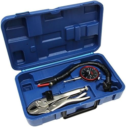

squonk 47,888 #13 Posted January 16, 2023 I use one of these. Share this post Link to post Share on other sites
ri702bill 12,816 #14 Posted January 16, 2023 1 hour ago, squonk said: I use one of these. Originally intended to check disc brake rotor runout, right Mike?? Bill 2 Share this post Link to post Share on other sites
Wheelhorse#1 1,962 #15 Posted January 16, 2023 @squonk who makes that one ? Share this post Link to post Share on other sites
squonk 47,888 #16 Posted January 16, 2023 33 minutes ago, ri702bill said: Originally intended to check disc brake rotor runout, right Mike?? Bill Yes. Also ball joint wear. 11 minutes ago, Wheelhorse#1 said: @squonk who makes that one ? Several companies make that style. Horror Fright sells it. $33 bucks https://www.harborfreight.com/search?q=clamping dial indicator 2 Share this post Link to post Share on other sites
