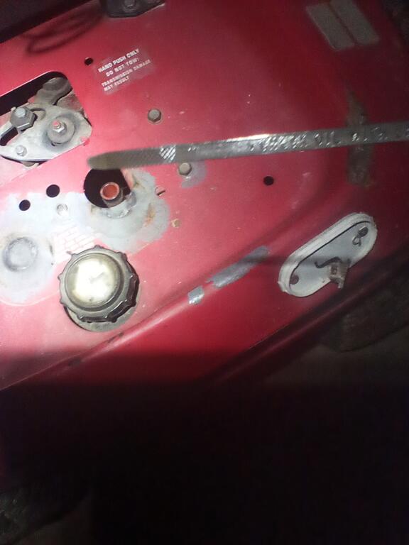

Metal Blender 8 #6 Posted January 12, 2023 33 minutes ago, 953 nut said: Are you running 10 W 30? Any signs of water in the transmission oil? 1 Share this post Link to post Share on other sites
WHX?? 58,194 #7 Posted January 12, 2023 (edited) That looks OK Metal... but... if you don't know when everything was changed last just drop the oil and filter and change it out. Run it for abit if you can to get the oil warm before dropping ...usually doesn't take long. NAPA 1410 on the filter. I use any quality Syn 10w-30. Reports are syn does better in cold ... I can neither confirm or deny that tho. Edited January 12, 2023 by WHX?? 3 Share this post Link to post Share on other sites
