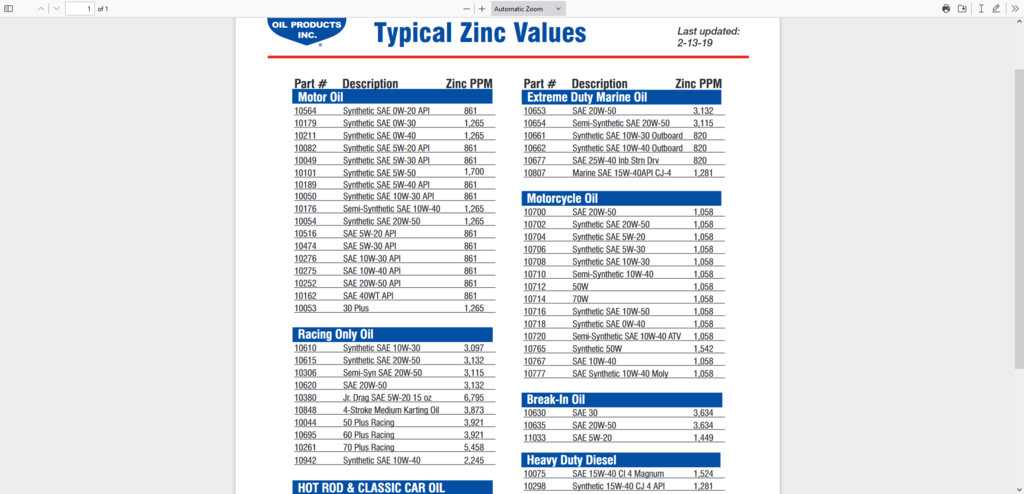

Brockport Bill 2,455 #49 Posted February 1, 2023 came across this Lucas oil spec sheet for Zinc values in their various oil products https://lucasoil.com/pdf/Zinc_Values_MotorcycleOil.pdf Share this post Link to post Share on other sites
Brockport Bill 2,455 #50 Posted February 1, 2023 On 1/9/2023 at 8:43 PM, lynnmor said: Did you check the amount of zinc in other oils? I said before that they all have it, just some has more than others. ZDDP is in motor oil to reduce wear, I can’t imagine that there are any noticeable changes in the short run. yes, thanks --- i have been checking the amount of zinc included across various labels ---- that's why i have just purchased the Kohler label noted earlier on the thread designed for their older Kohler engines - i recall their own Kohler oil that includes added zinc is about 1300 ppm --- whereas the "typical" oils have about 800 ppm zinc 1 Share this post Link to post Share on other sites
