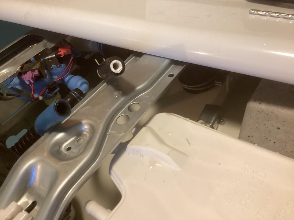

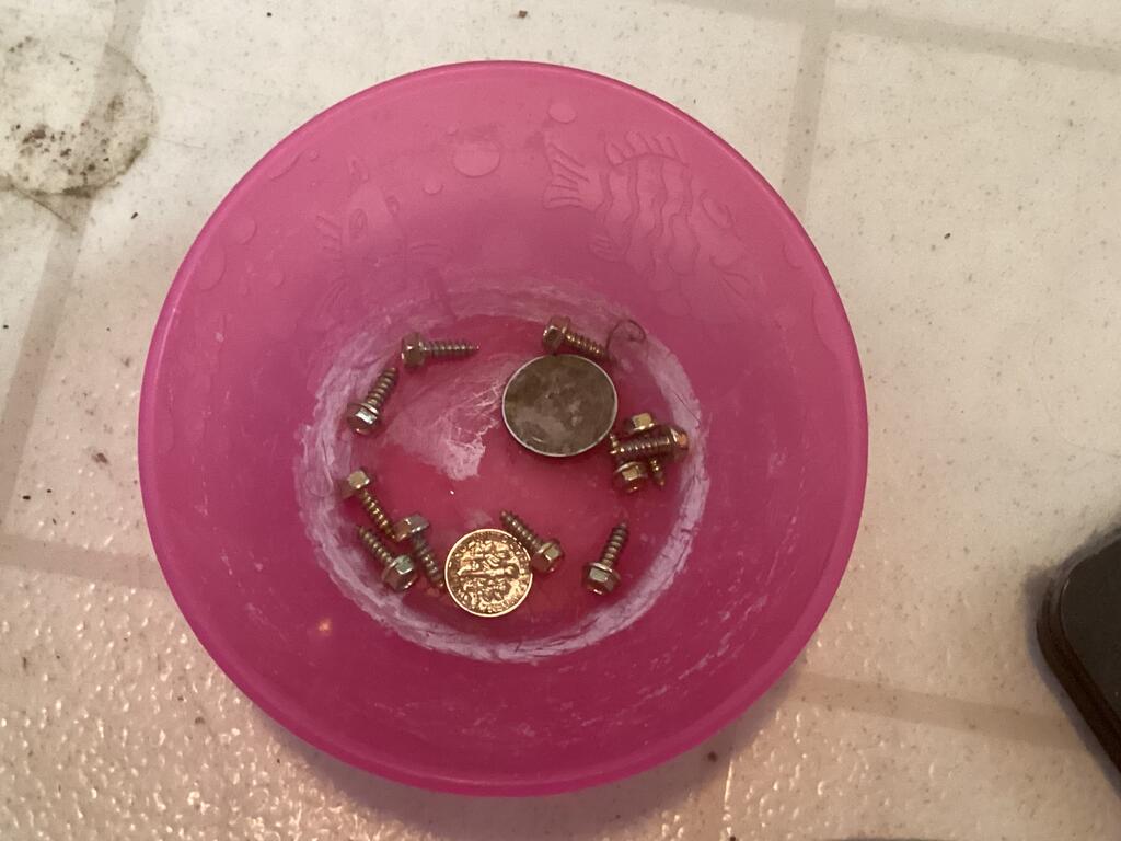

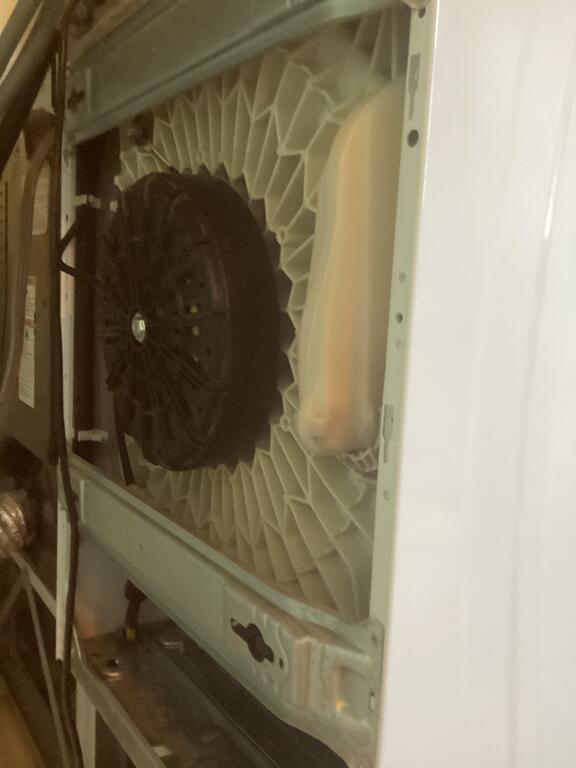

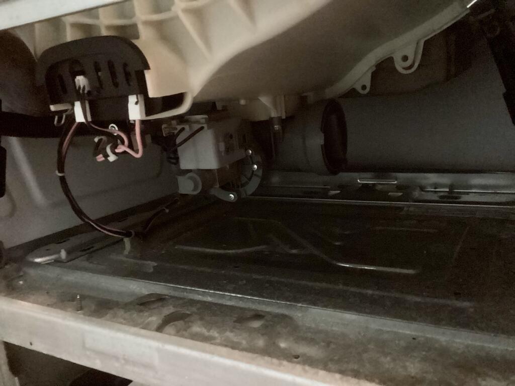

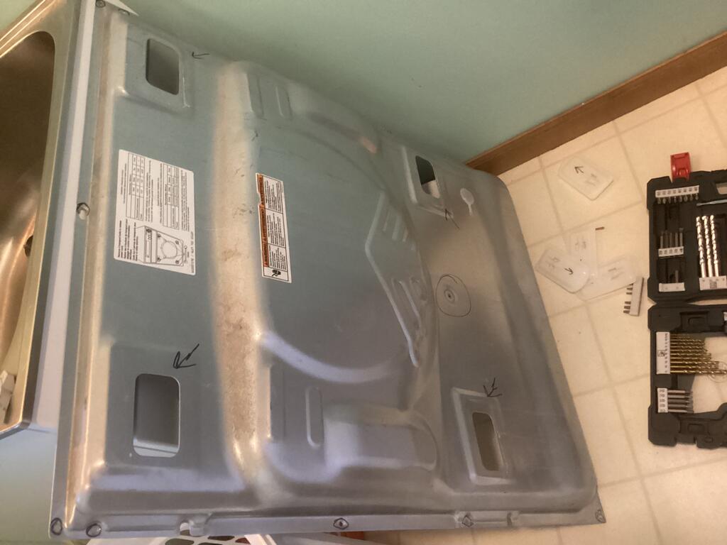

Pullstart 71,571 #1 Posted January 6, 2023 The day started with me being 35 cents up, for cleaning out the pump in our laundry mo-chine. It’s a job I‘ve done enough, that I have a map of which screws to remove off the back panel, and which way the clips slide. Some screws remain (where there are cut outs, but sometimes in the dark abyss of the rear of the laundry, any guide is a good one) to hold cross braces in place. I noticed the dispenser drop tube for fabric softener was dripping, so I decided to do some more tearing apart for cleaning aide. Well, the dispenser drum decided to snap instead of letting a feed hose loose. I’m finding myself with a not available / back ordered part, and am struggling with the idea of $1,200 for a wash machine and pedestal base because of it. The way I see, is a few options. 1) pony up and replace this 7 year old appliance with yet another sub-par wash machine 2) keep looking for that $200 piece of plastic, pay for shipping and wait on our courier service to deliver it 3) wait for the local appliance shops to call back with the same news as #2, but more money for their service 4) attempt a repair and hope it doesn’t burst. It’s on the low pressure side of a water solenoid. It just flushes the detergent, bleach, or fabric softener through the dispenser. thoughts? Happy Friday! 2 Share this post Link to post Share on other sites

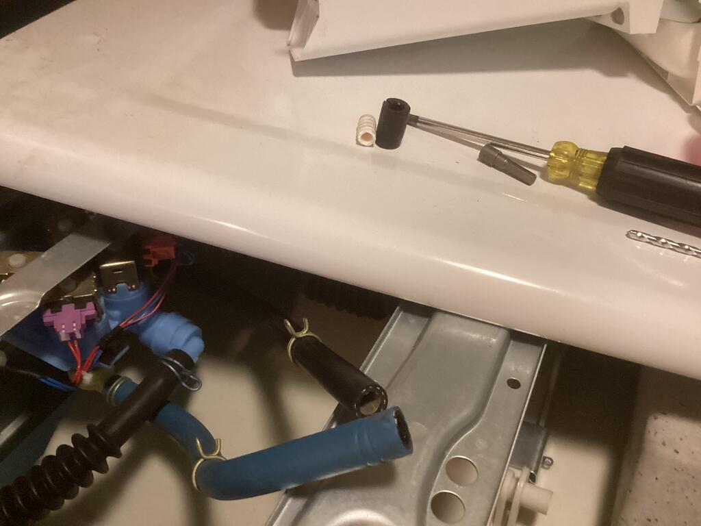

Pullstart 71,571 #4 Posted January 6, 2023 9 minutes ago, stevasaurus said: Plug it looking further into this, the two lines are hot and cold. They Y together in the drawer. I am contemplating an in-line tee on the hoses and epoxy the snapped piece shut. 3 Share this post Link to post Share on other sites

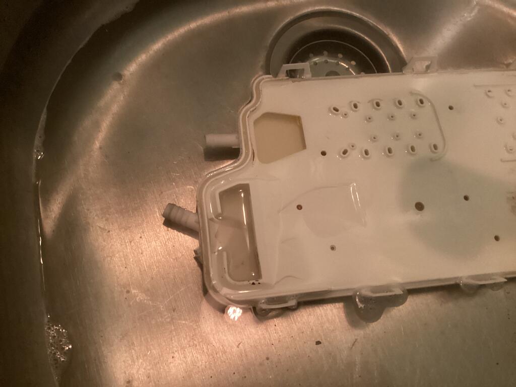

Pullstart 71,571 #6 Posted January 6, 2023 Good news-ish. The local appliance shop called back and we talked things over. Come to find out, my thoughts and plans to tee the lines together sounded good to him. I took the box out and removed the lid. I am soaking it in bleach water to cleanse it of any grime and slime before assembling it again. You can clearly see they are the same system once they enter the case. 3 Share this post Link to post Share on other sites
SylvanLakeWH 32,933 #8 Posted January 6, 2023 I've used that on boats. Amazing holding power... Good suggestion... 2 Share this post Link to post Share on other sites

WHX?? 58,388 #12 Posted January 7, 2023 (edited) How did the coins get past the inlet screen? I've laundered plenty of money but it was just always laying on the bottom of the drum. I would thunk they got in the pump they would busted off most likely plastic impellers. 3 hours ago, Pullstart said: this 7 year old appliance with yet another sub-par wash machine I'm on track for 20 years but I don't want new big box junk. I just keep a wrenching on them as long as parts are NLA and affordable. Your crew T prolly does alot of wash tho. Tell her I got a line on one of these if she wants to upgrade... Yep... Dan & I know a guy... Ask her she prefers a metal or wooden tub?... Hit n miss or Maytag?!? Edited January 7, 2023 by WHX?? 2 5 1 Share this post Link to post Share on other sites
