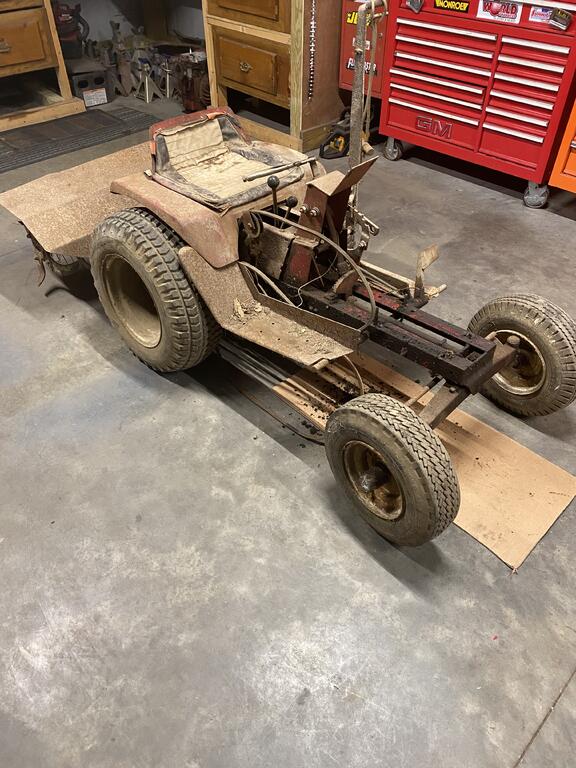

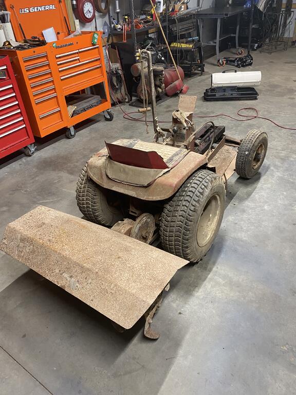

Tonytoro416 1,393 #1 Posted January 5, 2023 This will be the next tractor I begin to restore/ put back together. I have a long history with this tractor and tiller actually. This tractor belonged to both of my grandfathers in its life time. (Lived across the road from each other). Which to me makes it special even though it doesn’t look like much nowadays. My dad remembers his dad buying it a few years old from a Wheelhorse dealer in Portland, IN. He always told dad it was a 1969. My dad remembers several details from the tractor like it being a six speed with a Tecumseh engine 10hp. Had a 42” deck on it and this tiller as well. Their garage caught fire and the tractor and tiller were in there. My other grandfather (across the road) drug it out of the garage weeks later and took to his house. There he made it usable for his needs. The original hood stand is gone along with the hood and engine. The hood stand currently on it now comes back to a lawn ranger. Guessing grandpa had it laying around so it went on there took original hood and engine off and put this large Wisconsin engine on it and tilled garden with it for years. This is why I’m not 100% sure what it is but from my digging around I believe it to be a 1968 raider 9 or a 1969 Raider 10. If anyone has any info regarding that plz feel free. Regardless I have sourced parts to be able to put it back mostly to the way I believe it should be. So this is the next big project as you can tell it needs alot but for the most part is all there from what I can tell aside from the previous mentioned parts. Parts I have for it aren’t CORRECT in certain terms but are era correct. I have the correct dash with cigarette lighter and white rocker switch for headlights. Dad specially remembers those features also. And solid state ignition as he remembers helping his dad pay for a new one way back. Lol 😂 said it was terribly expensive even back then. I’m sure this will be a long one but will try and keep those interested up to date as I go 2 8 1 Share this post Link to post Share on other sites

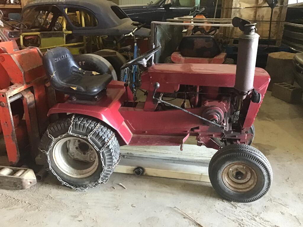

Lee1977 7,807 #6 Posted January 5, 2023 I have a complete list of Wheel Horses I printed out. It only list one Raider 9 1968 model 1-6931. Are you sure it's a short frame? Would a 42" deck even fit under a short frame? Share this post Link to post Share on other sites

Tonytoro416 1,393 #9 Posted January 5, 2023 (edited) 4 minutes ago, Lee1977 said: I have a complete list of Wheel Horses I printed out. It only list one Raider 9 1968 model 1-6931. Are you sure it's a short frame? Would a 42" deck even fit under a short frame? It’s for sure a short frame. It was tough sourcing the correct hood. I have a 1077 that has the same hood as I sourced for this tractor. Just the 1077 hood is about 3 inches longer Edited January 5, 2023 by Tonytoro416 Share this post Link to post Share on other sites

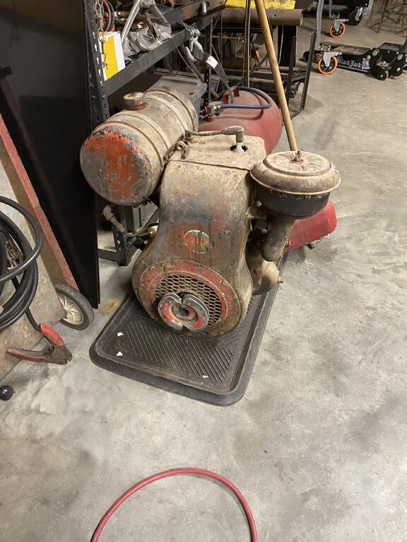

Tonytoro416 1,393 #10 Posted January 5, 2023 1 minute ago, oliver2-44 said: Have you though about raising the hood and keeping the Wisconsin part of its history! Plan on putting the Wisconsin on the bench and getting it running again. It will live with me for a good while yet. Does anyone know anything about that Wisconsin? Hp and that Share this post Link to post Share on other sites

Lee1977 7,807 #12 Posted January 5, 2023 (edited) 22 minutes ago, Tonytoro416 said: What other options does your list have as what it could be? Six speed and Tecumseh 10hp The 1-6931 1968 Raider 9 had a Tecumseh HH10 115095B and 6 speed. There is a Raider 12 model 1-6231 1968 with a Kohler with the 6 speed. There could be mistakes in the list, as I don't know where it came from. Edited January 5, 2023 by Lee1977 Share this post Link to post Share on other sites
oliver2-44 11,791 #13 Posted January 5, 2023 3 minutes ago, Tonytoro416 said: Plan on putting the Wisconsin on the bench and getting it running again. It will live with me for a good while yet. Does anyone know anything about that Wisconsin? Hp and that Looks like the data plate is missing from the shroud. You would have to open it up and measure the bore and stroke to help figure out what engine it is. I have a similar looking Wisconsin on the floor in the shop right now. I was a sucker for a $20 engine and I love the challenge of learning new engines and trying to breath life back into them) I've gathered a lot of information about them over on the Smokstak forum. Parts are fairly readily available, but can be expensive ($68 for a carb kit). Post a picture of the carb and any name (probable Zenith) and numbers. Also if the carb is cast steel or cast aluminum. 1 Share this post Link to post Share on other sites
Pullstart 71,482 #14 Posted January 5, 2023 11 minutes ago, Tonytoro416 said: Plan on putting the Wisconsin on the bench and getting it running again. It will live with me for a good while yet. Does anyone know anything about that Wisconsin? Hp and that It could be an AEN, AEH, etc. looks like the AEN on the Senior, and on my Lever Steer. The difference, is in the years and HP ratings. 8.3 is base power though, up to about 10. GOBS of torque are available with that long stroke 2 Share this post Link to post Share on other sites

Tonytoro416 1,393 #16 Posted January 5, 2023 Okay yea I wasn’t able to find much info on the engine itself but I can look closer at it this evening. Thanks 1 Share this post Link to post Share on other sites
Pullstart 71,482 #17 Posted January 5, 2023 Also, Steiner a tractor parts is a great source for Wisconsin stuff, like magneto parts. 2 Share this post Link to post Share on other sites

ebinmaine 81,046 #21 Posted January 5, 2023 Looking forward to following along on this one. As to short or long frame... @OldWorkHorse has a '68 Raider I used to own. I thought those were all long frames but I don't think I ever had a tape measure on it. Have you physically measured the frame length? Any chance your family members could have/ would have done a frame change with the engine or something else? Any ID tag on the tractor or any old pics? Share this post Link to post Share on other sites
Tonytoro416 1,393 #22 Posted January 5, 2023 40 minutes ago, ebinmaine said: Looking forward to following along on this one. As to short or long frame... @OldWorkHorse has a '68 Raider I used to own. I thought those were all long frames but I don't think I ever had a tape measure on it. Have you physically measured the frame length? Any chance your family members could have/ would have done a frame change with the engine or something else? Any ID tag on the tractor or any old pics? I have measured wheelbase. Unless there are tags I don’t know about the one is on the hood stand but it’s not the correct hood stand. Share this post Link to post Share on other sites
Tonytoro416 1,393 #23 Posted January 5, 2023 You guys have me questioning it now for sure I am going to have to do some more looking when I get off work 2 Share this post Link to post Share on other sites
ebinmaine 81,046 #24 Posted January 5, 2023 31 minutes ago, Tonytoro416 said: not the correct hood stand. That's has me wondering even more if the frame was changed..... Share this post Link to post Share on other sites
Tonytoro416 1,393 #25 Posted January 5, 2023 Everything else appears to have went through the fire though that’s what gets me. The hood stand you can tell it definitely didn’t go through a fire Share this post Link to post Share on other sites
