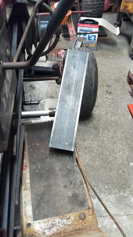

case442 132 #5 Posted January 5, 2023 Hey all, this one of mine has a p.o. Home brew. works great 7 Share this post Link to post Share on other sites

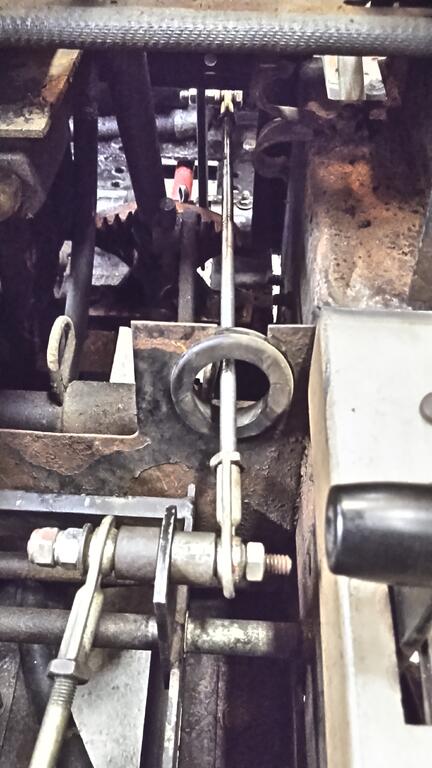

Handy Don 17,209 #9 Posted January 5, 2023 3 hours ago, case442 said: Hey all, this one of mine has a p.o. Home brew. works great Looks good.Any pictures of how you handled the linkage inside? Neutral interlock? Motion centering? Thanks! Share this post Link to post Share on other sites

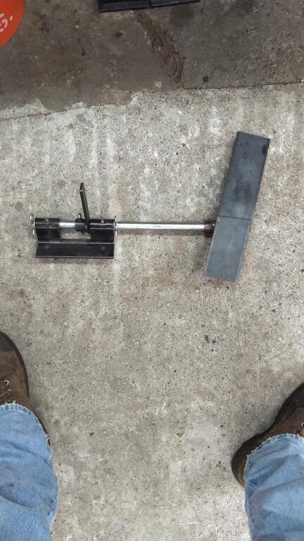

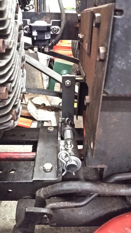

Bill D 3,063 #10 Posted January 5, 2023 I made my own. Still working on mods to the pedal design and I want to make an automatic return to neutral setup for it. My goal is a bolt on kit with minimal cutting or drilling required to install. 1 1 1 1 Share this post Link to post Share on other sites

Bill D 3,063 #13 Posted January 6, 2023 5 hours ago, ri702bill said: Excellent approach there Bill. Can be removed at a later date if desired - no one knows the difference.... Bill There will be a hole in the belt guard and I've drilled a hole above the linkage to reroute the fuel line. Those are the only major holes I have drilled so far. No major changes otherwise. 1 Share this post Link to post Share on other sites
