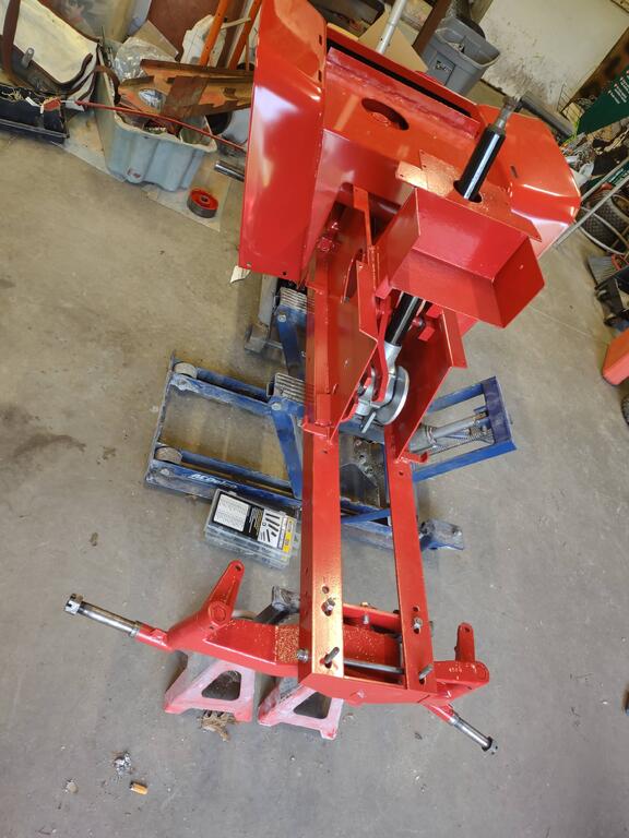

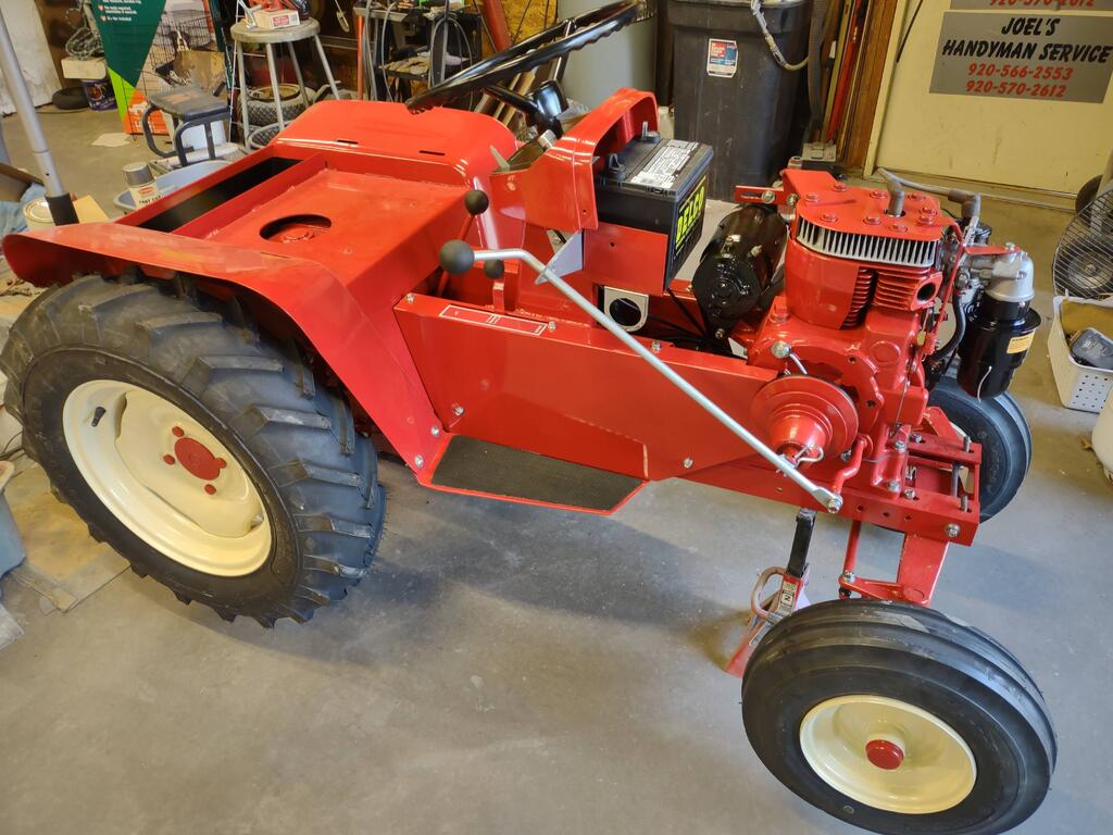

Achto 32,262 #104 Posted May 21, 2023 (edited) Spent the morning with Jim wet sanding the sheet metal on 2 tractors, then painted one of them. Used the rest of my day to do some more assembly on my tractor. Made some good progress with the few hours that I had to work on it. Edited May 21, 2023 by Achto 6 6 Share this post Link to post Share on other sites
WHX?? 57,645 #105 Posted May 22, 2023 (edited) That Ross box is boss! Edited May 22, 2023 by WHX?? Speeling 3 1 Share this post Link to post Share on other sites

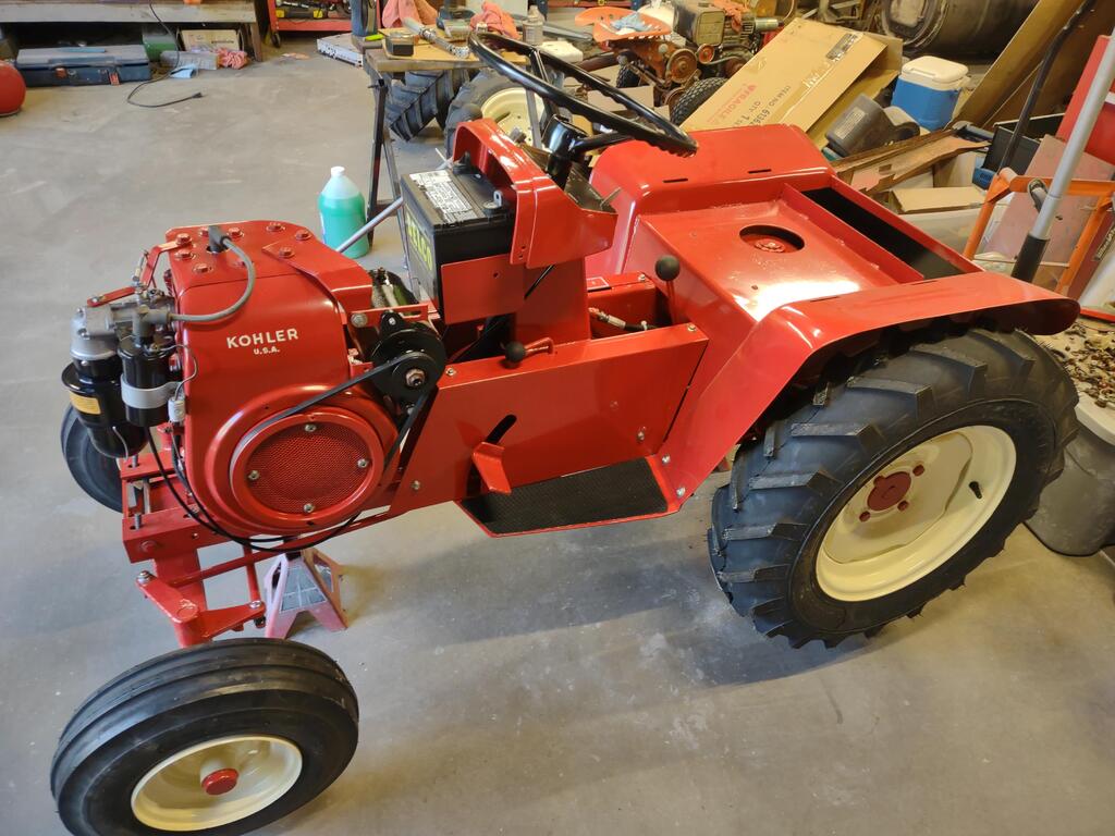

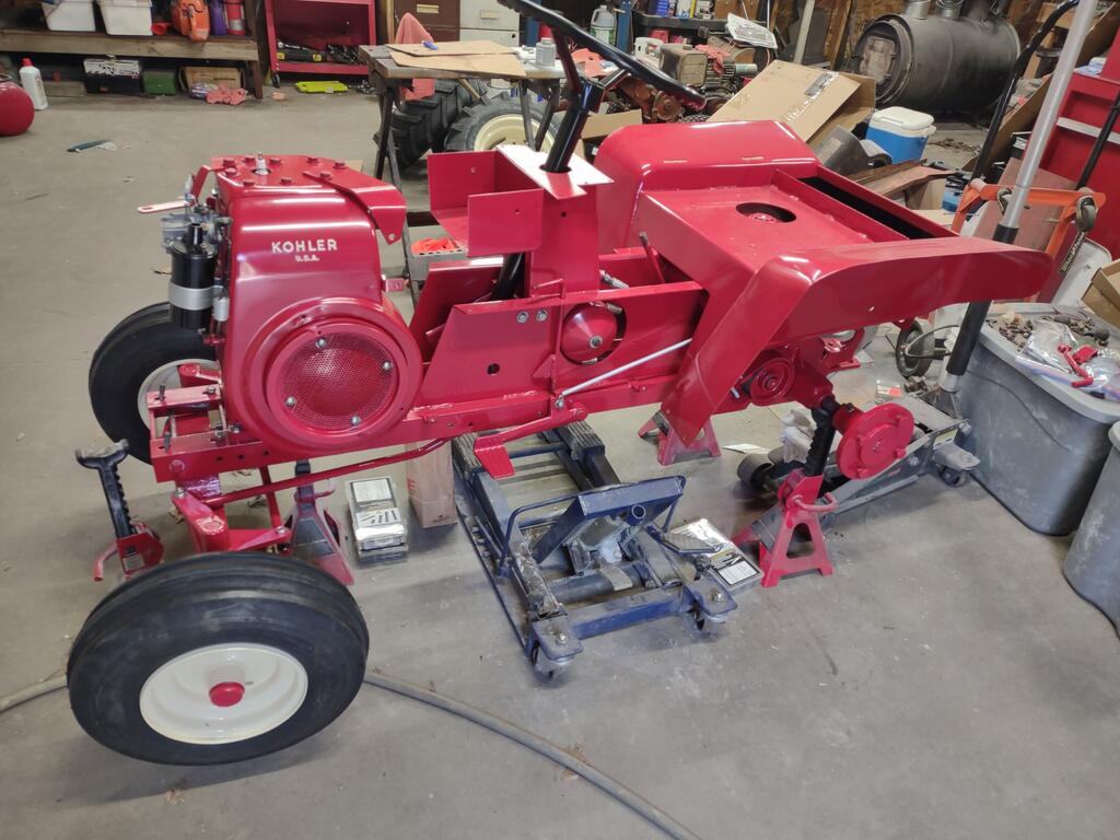

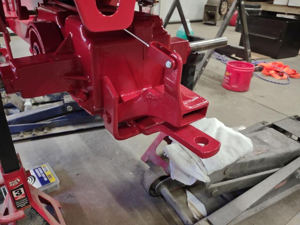

Achto 32,262 #106 Posted May 29, 2023 Added a few more pieces over the last couple of days. Yesterday I installed the hydraulics and got them plumbed. Hitches installed on the rear end. Today I was able to show more progress. Front end completed, engine bolted down, clutch & brake system installed. I also cut the pads out for the foot boards. 4 9 3 Share this post Link to post Share on other sites
Moparfanforever 933 #107 Posted May 29, 2023 Awesome looking tractor !!!!! 👍👍👍 1 1 Share this post Link to post Share on other sites

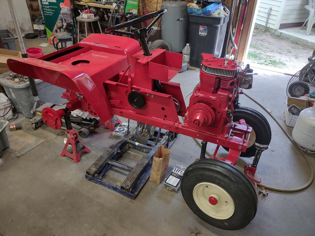

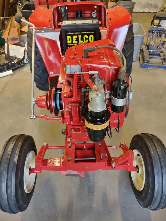

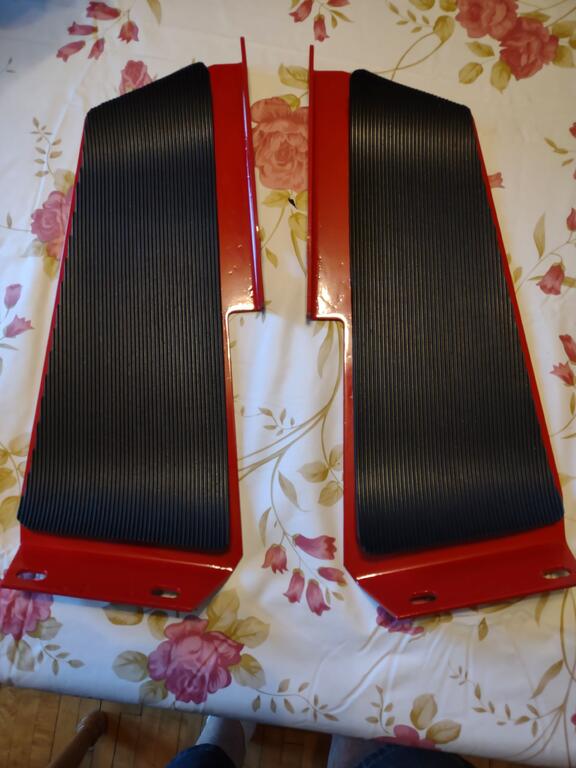

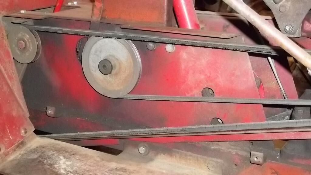

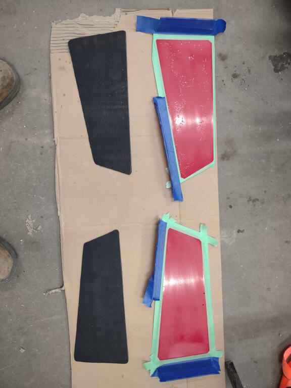

Achto 32,262 #108 Posted May 30, 2023 (edited) Moving right along today. Started out by applying 3M spray adhesive to the running boards and the rubber pads for them. Ran the plumbing for for the fuel system, made new throttle cables and continued to bolt pieces on. I had trouble remembering how the piece of angle iron was mounted below the drive belt. A big thanks to Jim for some picture assists. Turned out that I had the drive pulley pushed too far on to the crank shaft. In this next picture everything looked so purty that I had to take a picture before I covered it up. A few picture of how I ended the day. Down to wiring and bolt on the last few pieces. Edited May 30, 2023 by Achto 7 4 Share this post Link to post Share on other sites
WHX?? 57,645 #109 Posted May 30, 2023 Not to shabby ... not to shabby at tall. .. take it the trip to the dentist is wearing off? Farmer says no Cap'n on the meds tho? Bummer I would skip them meds and let him ease the pain. So the book says 1/16 - 1/32 clearance on that lower belt thingy? Pretty slim margin right @953 nut? 1 1 Share this post Link to post Share on other sites
WHX?? 57,645 #110 Posted May 30, 2023 (edited) 19 minutes ago, Achto said: I had trouble remembering how the piece of angle iron was mounted below the drive belt. A big thanks to Jim for some picture assists. I ran out ther in my knickers to crop those pics... a bro in need is a bro indeed... Cinnddaayy says you got no pants on yet .. . I says I pay the taxes here... I do like those Delco decals shoulda had ya order some extras. Edited May 30, 2023 by WHX?? 3 Share this post Link to post Share on other sites

953 nut 68,179 #115 Posted May 30, 2023 Outstanding paint and body work there. I have found that the TS 4l-820 is a bit too short for the clutch to wok, looks like that is what you are using. Mine has an 83" belt. 1 1 1 Share this post Link to post Share on other sites
WHX?? 57,645 #116 Posted May 30, 2023 (edited) 9 minutes ago, 953 nut said: TS 4l-820 is a bit too short for the clutch to wok, looks like that is what you are using. What does the IPL call for? Looks like Richard's clutch idler is up higher. Edited May 30, 2023 by WHX?? Share this post Link to post Share on other sites

Achto 32,262 #118 Posted May 31, 2023 4 hours ago, 953 nut said: I have found that the TS 4l-820 is a bit too short for the clutch to wok, looks like that is what you are using. That is exactly what I am using. I matched it up to the belt that was on the tractor. If it doesn't work I'll switch it out for a 4L-830. Thanks for the tip!! 2 Share this post Link to post Share on other sites

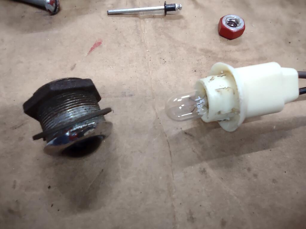

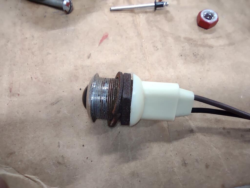

Achto 32,262 #120 Posted May 31, 2023 (edited) Ran into a sight dilemma. I have the lens for the generator light but I do not have the part to hold the light bulb. Did a little head scratching & think that I came up with a solution, well one that seems to work any way. One lens - one 194 bulb socket. Shave a little off from the tabs on the 194 bulb socket and Walla!! Fits tight, takes a bit of effort to remove the socket. Used a 149 bulb for lower wattage but could use the bulb to be a bit shorter. Edited May 31, 2023 by Achto 5 1 Share this post Link to post Share on other sites
WHX?? 57,645 #121 Posted May 31, 2023 (edited) Have I not told you anything? Have a couple of those "IN STOCK" including a NOS for those special occasions. This resto might be one of those. Orginal tail light now... yer on yer own. Heard tell @Shynon might have one but he's dropping trousers for it. Edited May 31, 2023 by WHX?? 1 Share this post Link to post Share on other sites
Achto 32,262 #122 Posted May 31, 2023 16 minutes ago, WHX?? said: Orginal tail light now... yer on yer own Have everything for the tail light. 17 minutes ago, WHX?? said: Have I not told you anything? Have a couple of those "IN STOCK" Might take a used one if your offering. If not, my idea will work. 1 Share this post Link to post Share on other sites

953 nut 68,179 #125 Posted May 31, 2023 19 hours ago, WHX?? said: What does the IPL call for? Looks like Richard's clutch idler is up higher. 82" belt, swapped it for an 83 inch belt and all is good. Looking at Dan's photo it appears his idler is the same as mine was with lots more range to move up to tighten the longer belt. 14 hours ago, Achto said: sight dilemma. I have the lens for the generator light but I do not have the part to hold the light bulb For future reference the Cole-Hersee PL 20 RC light is a direct replacement. 2 hours ago, Achto said: stainless fresh off the laser. Outstanding! 1 Share this post Link to post Share on other sites
