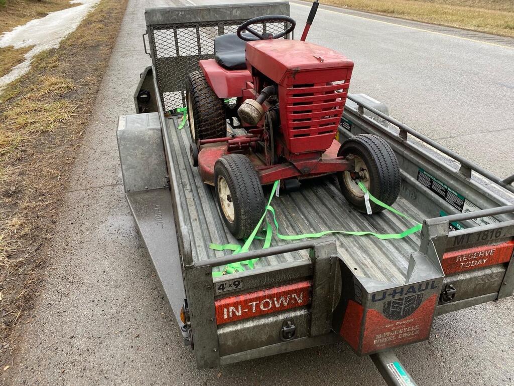

Thompson1276 257 #1 Posted December 31, 2022 Picked up this 856 it runs drives and mows suprisingly it mowed every season since it was new , the brake works on a flat surface but not on hills planning to flip the chassis and make it a low rider since this also has the first year of the rigid frames, was on market place for $700 got it for $500 it was worth it and it’s name is Winnie to match my other wheel horse Wonda the 1276, if anyone can help me on the brake issue that would be nice and I don’t know where the parking brake is too I couldn’t find one , but she’s in good hands and will be just fine, also here’s some pics kinds of eager of getting it so I rented a uhual and got it since my trailer was iced in from the last storm. 7 2 1 Share this post Link to post Share on other sites

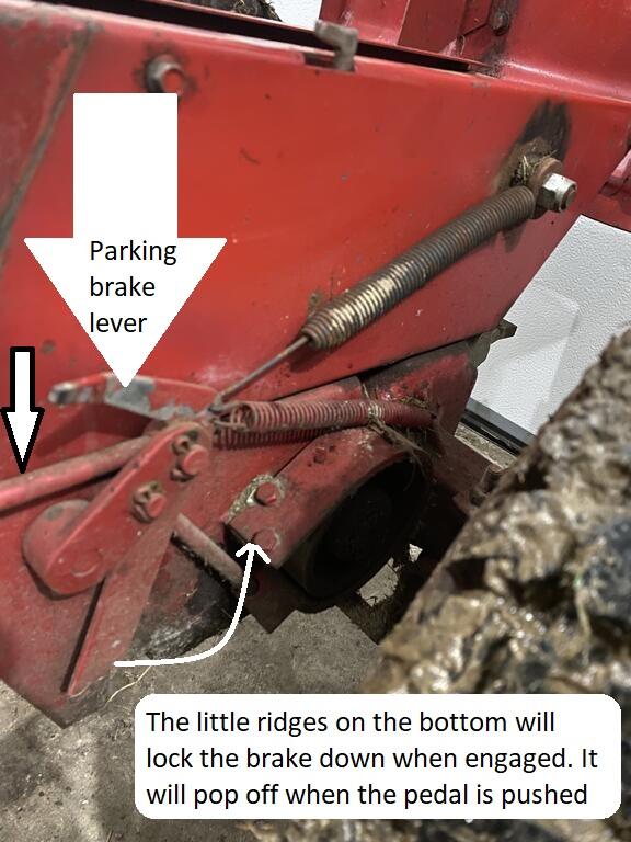

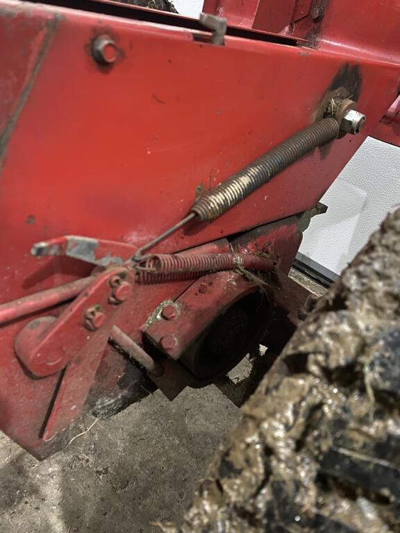

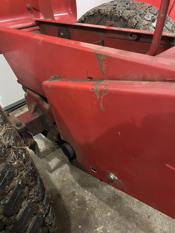

Thompson1276 257 #10 Posted January 1, 2023 For everyone who wanted pics of the “parking brake” (there is none) or I don’t know how to opperate it I guess but I thought it was a little handle you lift on the right it’s not there and the brakes work now I got it situated just had to drive it a little 1 Share this post Link to post Share on other sites

Thompson1276 257 #12 Posted January 1, 2023 4 minutes ago, Pullstart said: I’m still u sure if what little bars you mean? Maybe they were added by a PO, but not factory that I’m aware of. Cool tractor! The short frames are fun! Thank you it’s a cool little thing it’s name is Winnie but yeah 1961-1965 they didn’t have the ribs by the transmission, all frames after 65 had ribs by transmission bolts for added strength since they was known to crack since that where most the weight was and yes it’s factory check any frame after 65 just little ribs shown instead of it being flat prevents it from cracking 1 Share this post Link to post Share on other sites

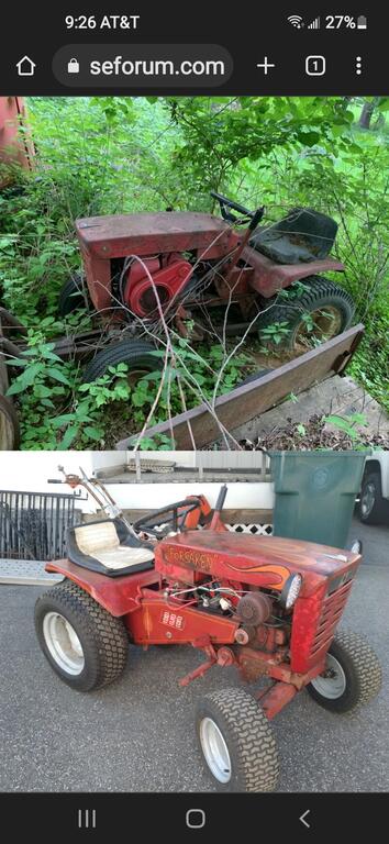

D_Mac 9,339 #13 Posted January 1, 2023 I dragged my 856 out of the woods where it had been left for decades. New carb, fuel lines, clean gas tank, new battery, rewired, new key switch, replaced rims, tires and seat and it was up and running again. I'm glad I saved it. Tractor runs fantastic. Short frames are my favorites. Good luck with yours. Share this post Link to post Share on other sites
Thompson1276 257 #14 Posted January 1, 2023 20 minutes ago, D_Mac said: I dragged my 856 out of the woods where it had been left for decades. New carb, fuel lines, clean gas tank, new battery, rewired, new key switch, replaced rims, tires and seat and it was up and running again. I'm glad I saved it. Tractor runs fantastic. Short frames are my favorites. Good luck with yours. Thank you and that looks cool man and im planning to fully restore and repaint my 856 like I did my 1276 1 Share this post Link to post Share on other sites
Racinbob 13,290 #15 Posted January 1, 2023 1 hour ago, Thompson1276 said: For everyone who wanted pics of the “parking brake” (there is none) or I don’t know how to opperate it I guess but I thought it was a little handle you lift on the right it’s not there and the brakes work now I got it situated just had to drive it a little You're right about the reinforcing ridges. My 854 doesn't have them and I added some bar stock for strength. Your brake linkage is really screwed up. The brake lever is actually there but installed wrong. What the heck is that spring thingy going up to where it looks like a hole was torched? If it was to assist the belt engagement it was the wrong way to go about it. Has someone got a good picture of the correct way to do the linkage on this model? Share this post Link to post Share on other sites
Racinbob 13,290 #16 Posted January 1, 2023 That spring thingy looks like a storm door safety spring. Noooooooo!!!!!!!!!!!! The lower spring looks to be wrong too. Get a 108035 spring, get the linkage straightened out and go from there. 1 Share this post Link to post Share on other sites
wallfish 20,744 #17 Posted January 1, 2023 You can get a bigger spring at TSC The parking brake lever is missing the plastic knob 1 1 1 Share this post Link to post Share on other sites
Thompson1276 257 #18 Posted January 1, 2023 21 minutes ago, wallfish said: You can get a bigger spring at TSC The parking brake lever is missing the plastic knob Got it fixed thank you, didn’t know that’s how it worked. As for the springs I figure they was wrong 😂 look man I got it from the most Appalachian hillbilly family you can think of like straight of the Beverly Hillbilly’s type stuff. But they was very very nice people but it worked so i won’t fix it until it comes to repainting and rebuilding next fall 1 Share this post Link to post Share on other sites
