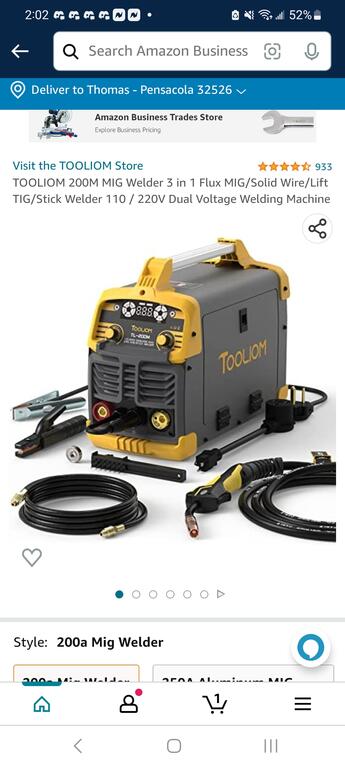

RED-Z06 2,720 #22 Posted December 27, 2022 18 minutes ago, ebinmaine said: That's my go-to tool for a lot of things. Didn't work either. This is another one of those multiple situations where it would be handy to have a nice easily set up wire feed welder sitting around. Ive got a 120/240v Tooliom 3 in 1, its cheap, can run flux core or gas mig, does arc welding and is Tig capable if you get the lift tig torch. After about 5 minutes of setup i was burning, its pretty simple to operate..ive run about 10lbs flux core through it this year with the only issues being my own...but its got loads of power. https://tooliom.com/products/mig-welder-tl-200m 2 Share this post Link to post Share on other sites
