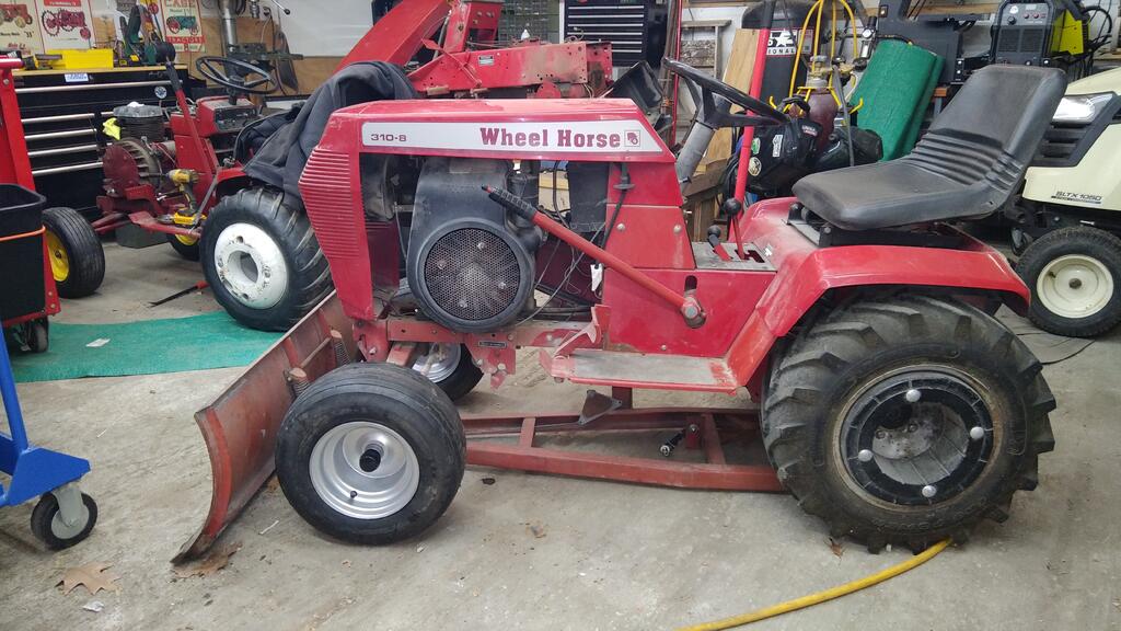

DNoland 2 #1 Posted December 27, 2022 I’m looking to get a set of 23x9x12r for my 312-8 and am having trouble finding them anyone know where to get them for a affordable price? 2 Share this post Link to post Share on other sites

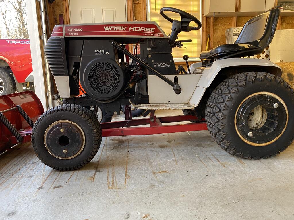

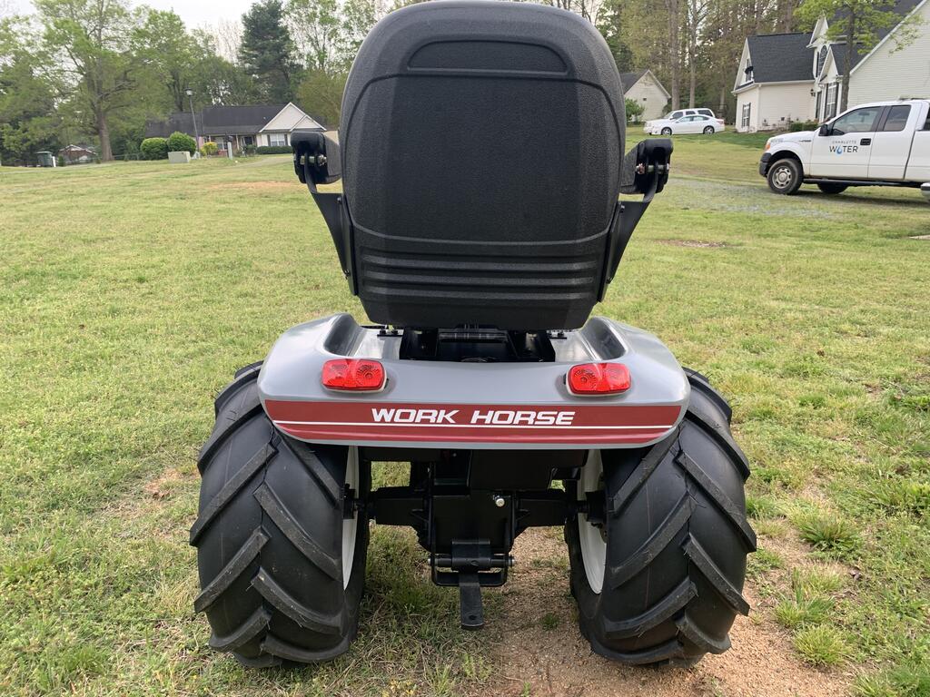

Horse Newbie 7,405 #8 Posted December 27, 2022 (edited) I use 23x10.50-12’s on the rear of my 1994 520H and 1984 Work Horse GT-1600. Hi-Run ags on the Work Horse and Turfs on the 520H… Edited December 27, 2022 by Horse Newbie 6 Share this post Link to post Share on other sites

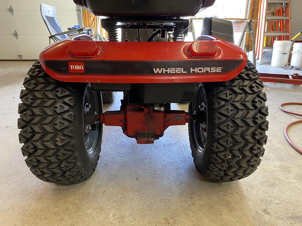

RandyLittrell 3,945 #11 Posted December 27, 2022 23x8.50-12's will work as well, here is some on my 310-8. 2 2 Share this post Link to post Share on other sites
RandyLittrell 3,945 #12 Posted December 27, 2022 (edited) I bought those through Walmart if I remember right. https://www.walmart.com/ip/Carlisle-Tru-Power-23-8-50-12-Tire/338767292 Randy Edited December 27, 2022 by RandyLittrell 2 Share this post Link to post Share on other sites

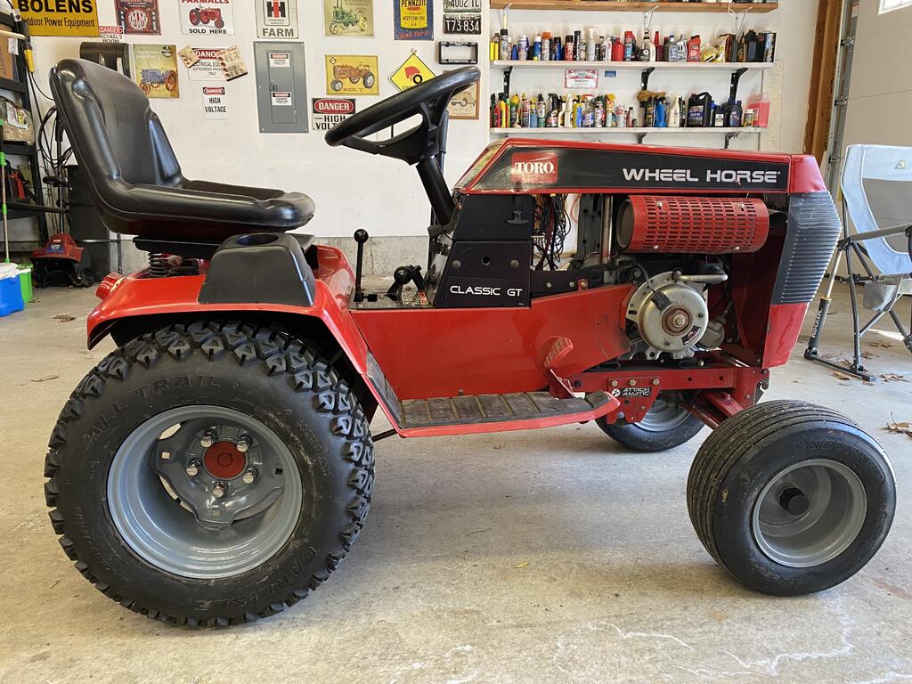

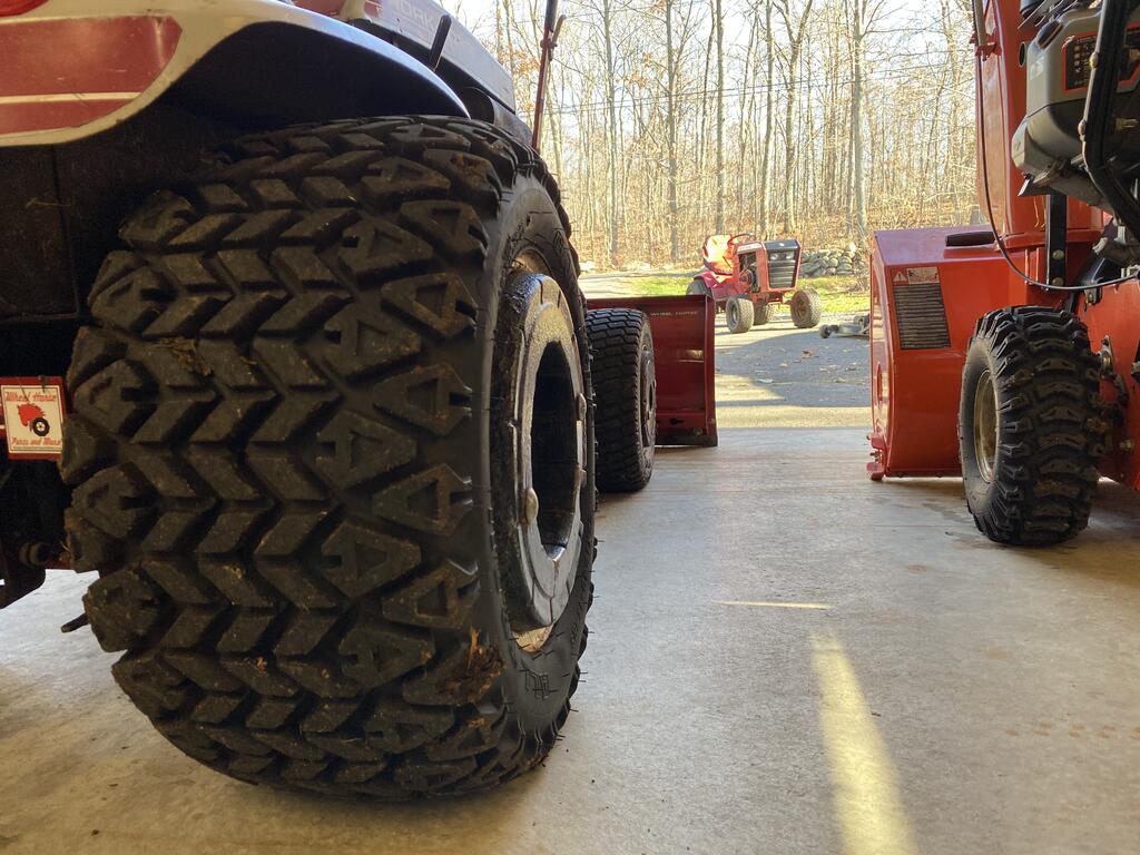

Sparky-(Admin) 26,322 #18 Posted December 28, 2022 @DNoland … are you looking for a new tire with the same or similar tread pattern, or AG style tires? Or something in- between? I have these on two of my rigs and anytime someone asks about tires I use the opportunity to brag about em! Carlisle All-Trails are the brand and type. 23x10.5 on the gray tractor and 23x8.00 on the red tractor. 5 1 Share this post Link to post Share on other sites
ebinmaine 80,653 #19 Posted December 28, 2022 28 minutes ago, Sparky said: Carlisle All-Trails If'n I had a hankerin' to buy some new tractor sneakers right now I'd be after these. I REALLY like the fact that the traction is equal both forward and reverse. The aggressive "Z" pattern is well known for excellent traction over many brands and a long proven history. 2 Share this post Link to post Share on other sites
