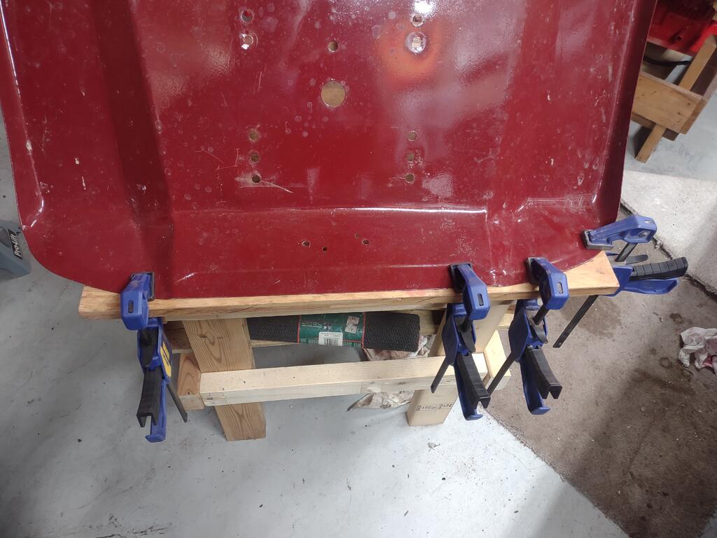

ebinmaine 81,046 #3 Posted December 27, 2022 8 minutes ago, JPWH said: A picture of the fender would help to advise the repair method. Jay Absolutely. This is the bottom facing you. Rear fin clamped to table. Whole fender standing up. The areas in white circles are pushed on towards the tires. The blue circle on the left is a wrinkle. The blue line on the right denotes a pair of wrinkles. The small yellow circle is a wicked little inward wrinkle. Here's a picture without the marks (for clarity). Share this post Link to post Share on other sites
JPWH 6,544 #4 Posted December 27, 2022 First thing I would do is hammer and dolly to smooth out the wrinkles. Then work on the larger areas that are left. Taking out the wrinkles will take care of some of the pushed in areas. 2 1 Share this post Link to post Share on other sites
Pullstart 71,482 #5 Posted December 27, 2022 A little heat on the dented spots might help too. Enough to help stretch the steel you know. No spare fenders EB? 3 Share this post Link to post Share on other sites
ebinmaine 81,046 #6 Posted December 27, 2022 17 minutes ago, Pullstart said: No spare fenders EB? I have the same amount of fenders as tractors to be restored. I could rob one and fix this later but... Why not just do it now ... Besides, the learning is fun. 😊 4 Share this post Link to post Share on other sites
Achto 32,890 #7 Posted December 27, 2022 1 hour ago, ebinmaine said: I need to know what objects or tools to use and how to go about straightening/pulling UP the metal away from the tires Like stated above, use a hammer & dolly to knock things back into place. When working out dents - first in last out is a good rule of thumb. 2 Share this post Link to post Share on other sites
ebinmaine 81,046 #8 Posted December 27, 2022 1 hour ago, JPWH said: First thing I would do is hammer and dolly to smooth out the wrinkles. Then work on the larger areas that are left. Taking out the wrinkles will take care of some of the pushed in areas. 5 minutes ago, Achto said: Like stated above, use a hammer & dolly to knock things back into place. When working out dents - first in last out is a good rule of thumb. I've a strong feeling that once the wrinkles are flattened out the ends are still gonna need movement. What can we do to bend the whole corners? 1 Share this post Link to post Share on other sites
Achto 32,890 #9 Posted December 27, 2022 11 minutes ago, ebinmaine said: What can we do to bend the whole corners? I have used a concrete floor as my dolly many times. Hold the fenders at the correct angle on the floor and tap things out strait. A third hand could be useful when doing this, but I usually manage by myself. 2 1 Share this post Link to post Share on other sites
JPWH 6,544 #10 Posted December 27, 2022 (edited) A dead blow hammer on the larger areas with a board on backside for general movement followed by hammer and dolly works good for me. Depends on how things need to move. The dead blow hammer won't make sharp hammer marks like a steel hammer will. Edited December 27, 2022 by JPWH 1 1 Share this post Link to post Share on other sites
8ntruck 9,368 #11 Posted December 27, 2022 Has the triangular area between the center of the fender and the offset area near the tire been flattened? If so, I'd start there trying to restore the offset to match the opposite side. As far as bending the fender away from the tire, I'd try clamping the short part of the fender to a table or bench, then use the rest of the seat pan to bend the fender back. Would be helpful to have pictures from the other side of the pan. 1 Share this post Link to post Share on other sites

ri702bill 13,271 #15 Posted December 27, 2022 @ebinmaine - A second identical pan - in good shape - can be a good visual guide to your progress of massaging the damaged one. Also helps to do "The Pringle Thing" - stack the good one on top, look inside them for variations....BT,DT. 3 Share this post Link to post Share on other sites

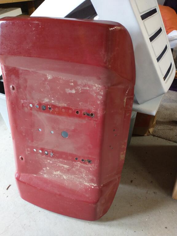

ebinmaine 81,046 #16 Posted December 27, 2022 11 hours ago, 8ntruck said: pictures The area circled in blue is the worst. You can see that's pushed in quite a fair amount. The opposite side that's on top right now. I didn't mark that but it too, is dented some. Share this post Link to post Share on other sites
oliver2-44 11,791 #17 Posted December 27, 2022 A tip an old rat rod acquaintance gave me was to work from the outer edge of the dent inward, tap, tap, tap. In other words don’t take the BIg Hammer and smash it in the middle of the dent. 1 2 Share this post Link to post Share on other sites
Achto 32,890 #18 Posted December 27, 2022 6 minutes ago, oliver2-44 said: tip an old rat rod acquaintance gave me was to work from the outer edge of the dent inward, tap, tap, tap. First in last out. 1 1 1 Share this post Link to post Share on other sites
8ntruck 9,368 #19 Posted December 27, 2022 sometimes taking big bites of the dent will stretch the metal enough that it won't want to go back to where it started. 3 Share this post Link to post Share on other sites
RandyLittrell 3,946 #20 Posted December 27, 2022 Best way to do that is to bolt it back to a tractor, then use your hands or even a two by four between the tire and fender. If you have it on a tractor, you can stand back and look at it to get both sides the same. Randy Share this post Link to post Share on other sites
ranger 1,862 #21 Posted December 27, 2022 (edited) If the metal is stretched and you don’t have any means of shrinking it, ie, shrinking tools, oxy-acetylene torch etc, Don’t try to hammer the dent out with a “Hard” hammer whilst supporting the metal against a “Hard” backing, dolly, etc. You’ll only stretch it more. Use a block of hard wood as a dolly, and a metal hammer, or a metal dolly with a wooden mallet. There are many old publications around which can guide you, but remember, most steel “body” panels made from the early 1970’s are made from “High Strength” steel, which is much more difficult to work/rework than the previous material used, which was much more malleable. google “The key to metal bumping” you should be able to open or download this book for free as a pdf file. Edited December 27, 2022 by ranger 1 Share this post Link to post Share on other sites
