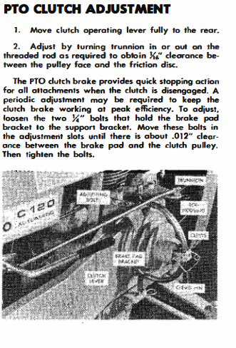

gwest_ca-(File Mod) 12,510 #2 Posted December 27, 2022 Pto clutch slipping? Tighten the trunnion about 2 turns and try again. Repeat if necessary. The belt would be the last to slip if ever. 3 1 Share this post Link to post Share on other sites

Joe 77 B100 84 #4 Posted December 27, 2022 (edited) 15 hours ago, gwest_ca said: Pto clutch slipping? Tighten the trunnion about 2 turns and try again. Repeat if necessary. The belt would be the last to slip if ever. I am going to have to google a pic and/or video to even know what/where that is. If you have a link or any help then let me know so I can go try it. Or, even some pics. but, I "think" I already tried that. The engine does NOT bog down when the blower stops turning so it isn't tight and also bringing down the rpms. Something needs to be tighter. I pulled the pin out on the lever that engages the PTO and turned the bar with the threads on it but now the PTO still stays engaged a bit when I release it. Edited December 27, 2022 by Joe 77 B100 1 Share this post Link to post Share on other sites
Joe 77 B100 84 #5 Posted December 27, 2022 11 hours ago, Ed Kennell said: If the engine rpm is not decreasing when the auger slows down then possibilities are; 1.as Garry noted, the PTO is slipping and needs adjusted 2.the belt tension spring needs replaced 3.The belt is worn on the sides and bottoming out in the PTO or blower drive pulley...replace the belt 4.One of the jackshaft keys is missing The engine does NOT decrease. I pulled this out, which I think is the trunnion, and turned the bar that threads into it but that just seems to keep the PTO running even when its disengaged. I am going to undo that unless I just turned it too many times. I will check and see what a jackshaft key is. Any pics or videos would be great. Totally learning as a go. 1 Share this post Link to post Share on other sites

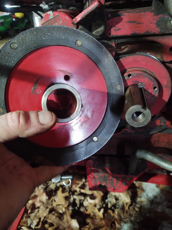

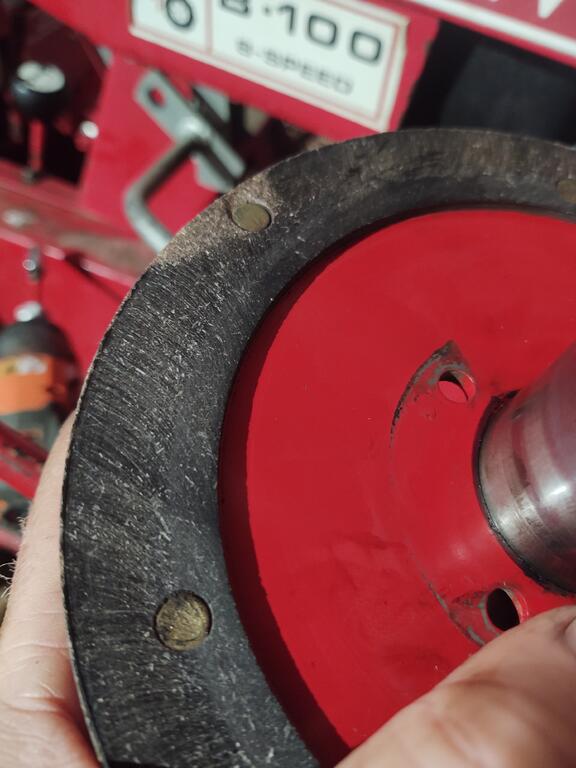

Joe 77 B100 84 #15 Posted December 29, 2022 Anyone know how to make the images smaller? The face of the clutch looks ok. It is still a few mm from the brass- but not much. 1 Share this post Link to post Share on other sites

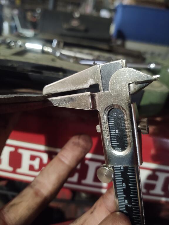

Joe 77 B100 84 #16 Posted December 29, 2022 And, here is a pic of me trying to measure with a caliper but I wasn't able to hold the caliper, the clutch plate AND take a pic. 1 Share this post Link to post Share on other sites

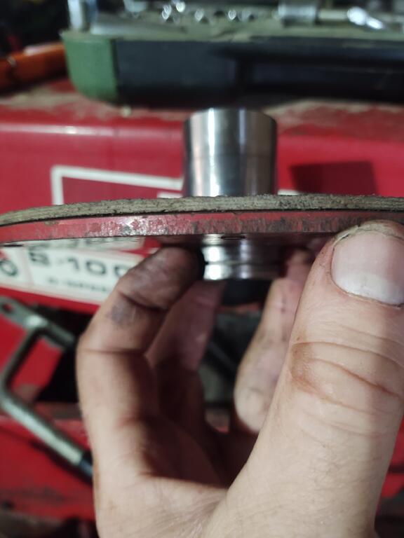

Joe 77 B100 84 #17 Posted December 29, 2022 A better pic of the thickness of the clutch plate. By the way, that shiney tube or "race"? easily slides through the clutch plate. Should there be some ring in the groove by my index finger which keeps it from slipping all the way and both ways through the clutch plate? 1 Share this post Link to post Share on other sites

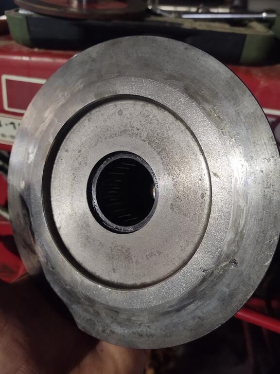

Joe 77 B100 84 #18 Posted December 29, 2022 The face of the "bell" looks to be in ok shape and there seems to be plenty of lube in the bearings. 1 Share this post Link to post Share on other sites
Joe 77 B100 84 #19 Posted December 29, 2022 As you can see, the "key" seems to be totally missing from the rest of the shaft that goes through the clutch plate. But, part of me thinks there doesn't need to be a key in the shaft/race because it is screwed with four bolts to the block. And, if there is supposed to be a key that continues from the block through the race, shouldn't there be a square cutout on the inside of the race into which the rest of the key (if there is supposed to be more key) would go? 1 Share this post Link to post Share on other sites
peter lena 10,089 #20 Posted December 29, 2022 @Joe 77 B100 looks like a building detailing is in order , that pto cone area , has 2 related bearings , one outside and another needle bearing inside, grease type , not volume is most important , a hi temp 560 deg rated lube , will stay with the bearings , heve re greased all of mine , thorough clean out , and lightly lube inner needle bearing , excess can and will sling on/up to clutch face , making it slip. note pto lever , added washers , at start point , makes it work better , also note heim joint on place of trunnion , super easy smooth , last pic, battery tender plug in , added ground cable from battery ground bolt to engine / chassis , increase engine grounding / lights . pete 1 Share this post Link to post Share on other sites
Joe 77 B100 84 #21 Posted December 29, 2022 19 minutes ago, peter lena said: @Joe 77 B100 looks like a building detailing is in order , that pto cone area , has 2 related bearings , one outside and another needle bearing inside, grease type , not volume is most important , a hi temp 560 deg rated lube , will stay with the bearings , heve re greased all of mine , thorough clean out , and lightly lube inner needle bearing , excess can and will sling on/up to clutch face , making it slip. Got it! note pto lever , added washers , at start point , makes it work better , In this pic, which articulation point that I highlighted? I don't know what you mean by "starting point"? also note heim joint on place of trunnion , super easy smooth , Not sure what you mean by that. Heim joint? Newbie here, you will have to be very specific and use terminology from the parts list. last pic, battery tender plug in , added ground cable from battery ground bolt to engine / chassis , increase engine grounding / lights . pete Got it! 1 Share this post Link to post Share on other sites
8ntruck 9,338 #22 Posted December 29, 2022 My PTO was slipping while I was running my 42" mower deck this summer. Turns out that the 'C' clip on the outside end of the stub shaft in the PTO bell had come out of the groove in the stub shaft. Instead of putting force on the PTO clutch, the arch that the PTO engagement lever moves was just pushing the stub shaft deeper into the bearing on the outside of the bell. I also found that the Spiroll pin that holds the U shaped bracket on the end of the stub shaft to the arch was broken. A spring pin will work here for a while, but you really need a two layer Spiroll pin there. Good luck. 2 Share this post Link to post Share on other sites

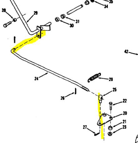

peter lena 10,089 #23 Posted December 29, 2022 @Joe 77 B100 # 29 LEVER ROD going into # 30 , has a lot of loose play right there , thats what my initial picture showed , if you fill in that gap with washers and grease , like my picture showed , it makes it solid and smooth .for a starting point . what I did on the trunnion swap out , to screw on heim joint ,https://www.bing.com/images/search?view=detailV2&ccid=lysk0f8m&id=72F06682269870F5F9330B540563A2EB1C6B679C&thid=OIP.lysk0f8mBNCkXdN_vSsvnQHaFj& used a 3/8 x 24 die thread nut , over original 3/8 x 16 threads , to screw on new heim joint , adjust back and forth , till it works easily .the fit will be into part # 29 outer corner hole . use an elastic nut on the heim joint bolt end . so it will not move . actually a pretty simple improvement , have it on my 3 horses , local h/w store might have that heim joint , question , just ask , pete 1 Share this post Link to post Share on other sites
