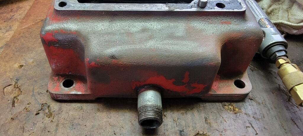

Joker72 96 #34 Posted January 5, 2023 (edited) It was the oil pan. Wanted to start with that before I threw the block in. I thought the same thing about the license plates. Will turn on next pass. I'm pleased with the initial results. The cast iron looks clean. Will finish it up w a wire brush. Edited January 5, 2023 by Joker72 3 Share this post Link to post Share on other sites
