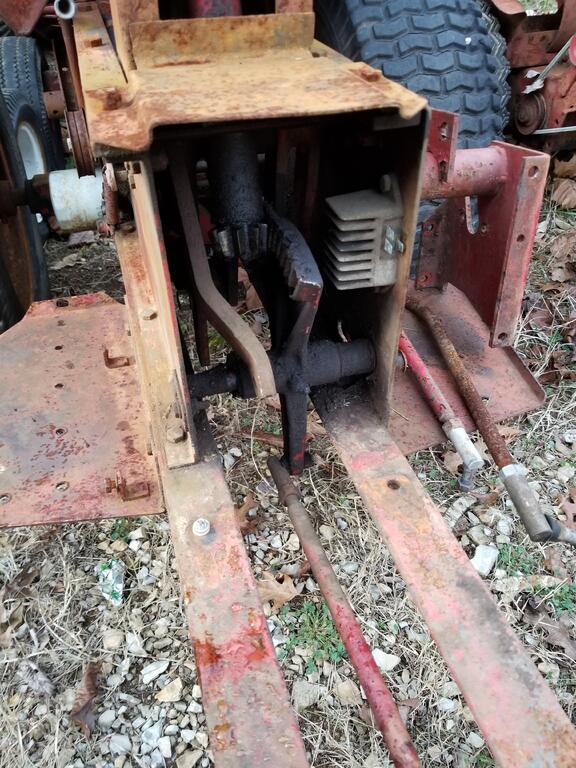

Bill D 3,119 #3 Posted December 17, 2022 Anyone have pictures of a GT 14 steering system? Share this post Link to post Share on other sites
