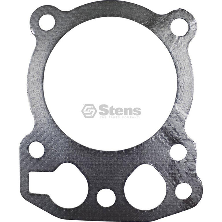

jeff lary 173 #34 Posted December 19, 2022 So at a bare minimum if I just get into it far enough to see the head gasket to see if it is blown, I will need.... 3/8 torque wrench to put it back together New head bolts RTV sealant Head Gasket Valve cover Gasket or maybe just use RTV here I can get the torque wrench at Harbor Freight (maybe). The RTV at the auto parts store. But what about the head gasket? order it online maybe? As for the Head bolts do they really have to be replaced? if so I assume that I can get them at an auto parts store maybe. I assume they are of a different strength than any hardware store bolt might be... See you kept after me now I am asking lots of questions... 1 Share this post Link to post Share on other sites

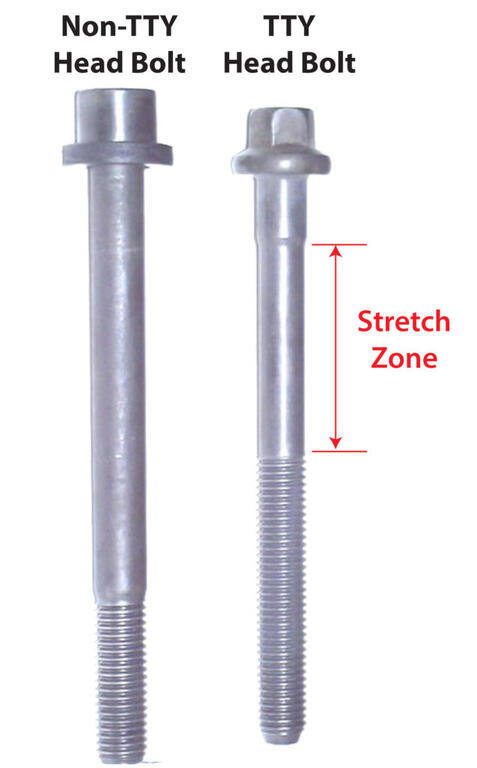

RED-Z06 2,720 #37 Posted December 19, 2022 Whats you're model and spec number, ill try to see if they used tty head bolts. Tty bolts will have a necked down area above the threads where the bolt will yield Share this post Link to post Share on other sites

RED-Z06 2,720 #39 Posted December 19, 2022 19 minutes ago, jeff lary said: CH 14S ,,,I believe it is 14S but could be 145 if my eyes were not seeing right if I remember that correctly that number is worn away or the sticker is scratched right there. SER NO. 300 530 2811 I have this recorded in a book here in the house it should be correct The spec number would be on that worn sticker, i pulled up a Toro spec on the drop down list (Ch14-1838) and it shows the current bolt is 20 086 02-S which is not torque to yield and head gasket is 12 041 08-S. Without your specific spec number i can't say with 100% certainty. 1 Share this post Link to post Share on other sites
jeff lary 173 #40 Posted December 19, 2022 like I said 14S I believe. what does " not torque to yield" mean. and the Head gasket ,.. is that the replacement number maybe? I am watching a video on Youtube by I SAVE OLD TRACTORS. he is showing some of the things I will need to know. I am a very visual learner. 2 Share this post Link to post Share on other sites
Snoopy11 5,731 #41 Posted December 20, 2022 4 hours ago, jeff lary said: The v-e-r-y little I have read says something about not reusing the head bolts after taking them out. So if that is the case I will need to go find some new bolts to replace them with I suppose Be very careful when removing them. If your gasket is blown, normally the bolts are difficult to get out. I do not recommend using any power tools for this. 10 minutes ago, jeff lary said: what does " not torque to yield" mean TTY means that the first time a bolt is installed, it is torqued to the point where if the bolt is removed, it cannot be reused. Upon first installation, the bolt was stretched, and will not spring back. In your case, the type of bolts that are in your engine can be reused more than once IF you remove the head bolts and they aren't in horrible shape. Best to soak them in some sort of rust penetrant and chase the threads just for good measure. Whatever bolts you put back in, I recommend lubricating them with ARP fastener assembly lubricant. Don Share this post Link to post Share on other sites
jeff lary 173 #42 Posted December 20, 2022 Thank you I will be careful no inch impacts here! I will just use a 3/8 ratchet. I am done for the night I will check in tomorrow 2 Share this post Link to post Share on other sites
RED-Z06 2,720 #43 Posted December 20, 2022 22 minutes ago, jeff lary said: like I said 14S I believe. what does " not torque to yield" mean. and the Head gasket ,.. is that the replacement number maybe? I am watching a video on Youtube by I SAVE OLD TRACTORS. he is showing some of the things I will need to know. I am a very visual learner. Normally a bolt tightens down and clamps 2 or more parts together and the friction of the head onto a washer and the friction of the threads, it puts stress on the bolt...this is what provides the clamping power, so you torque to x foot pounds. TTY is torque to yield, TTY bolts are designed to be torqued to X foot pounds, then usually a final movement such as "torque to 90ft/lbs then 90⁰. This forces the thinned area of the bolt to stretch permanently and gives a more consistent clamping force. Once the bolt yields, it will never take torque again, it will usually snap off because it cant get to the torque again. 1 1 Share this post Link to post Share on other sites
Snoopy11 5,731 #44 Posted December 20, 2022 (edited) @jeff lary... Considering TYPE of cylinder head bolts your engine has based on my research on your engine model.... your cylinder head bolts can be reused. CONDITION is another thing. CONDITIONALLY... you'll know when you remove them if you can reuse them or not... In other words, if they come out looking like Methuselah's momma... you'll want to replace them. Don't forget, you can use both rust penetrant and heat to remove them if you need. They SHOULD come out though without a problem. Don Edited December 20, 2022 by Snoopy11 1 Share this post Link to post Share on other sites
Wild Bill 633 943 #45 Posted December 20, 2022 Cost of new cylinder head bolts (5) @ $1.82 each = $9.10. Not worth my time to reuse old ones. Share this post Link to post Share on other sites
