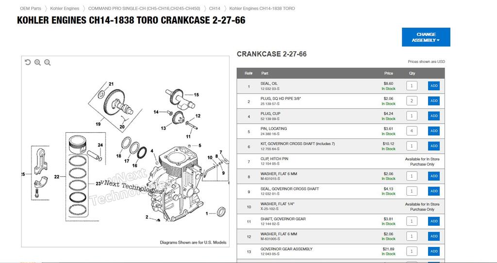

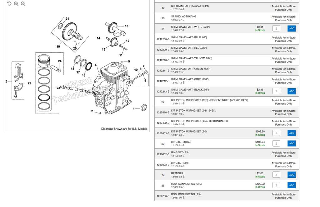

pfrederi 21,303 #12 Posted December 17, 2022 Looks like parts for it are already getting more limited. Use the part numbers and look to see what is available before you make any decisions Getting pricey also $100 for just rings??? Share this post Link to post Share on other sites

Achto 32,923 #16 Posted December 17, 2022 Sad to see that parts for the CH14, which is a newer engine are getting limited. On the other hand a K321 14hp, which is an older engine has parts readily available. With after market rebuild kits at a very reasonable price. If the price to fix your engine gets out of budget or you have parts availability issues. Then you might consider looking for a K321 with a bendix style starter to replace your engine. Should be a fairly easy swap. 1 Share this post Link to post Share on other sites
Wild Bill 633 943 #17 Posted December 17, 2022 @jeff laryIf you were to rebuild the engine I would recommend the following parts, piston kit (0.050 over), rod (0..25 under), intake and exhaust valves, valve guide seals, valve springs, valve keepers, lifters, cylinder head bolts and gasket set. The machine shop to clean all parts, grind crank, bore & hone cylinder, valve guides, valve job, deck block and mill head and check ring end gap. Cost is approximately $450 in parts and $400 to machine. 1 Share this post Link to post Share on other sites
pfrederi 21,303 #18 Posted December 17, 2022 38 minutes ago, Wild Bill 633 said: @jeff laryIf you were to rebuild the engine I would recommend the following parts, piston kit (0.050 over), rod (0..25 under), intake and exhaust valves, valve guide seals, valve springs, valve keepers, lifters, cylinder head bolts and gasket set. The machine shop to clean all parts, grind crank, bore & hone cylinder, valve guides, valve job, deck block and mill head and check ring end gap. Cost is approximately $450 in parts and $400 to machine. I am not familiar with these new engines. Going .050 over seems like a lot? and the .025 under on the crank seem like a lot also. Curious as to why the parts Kohler offers are such a big adjustment.. 1 Share this post Link to post Share on other sites
Wild Bill 633 943 #19 Posted December 17, 2022 1 hour ago, pfrederi said: Going .050 over seems like a lot? and the .025 under on the crank seem like a lot also. Metric engine. 0.050mm = 0.0196 in. and 0.025mm = 0.0098 in. 2 Share this post Link to post Share on other sites
pfrederi 21,303 #20 Posted December 17, 2022 28 minutes ago, Wild Bill 633 said: Metric engine. 0.050mm = 0.0196 in. and 0.025mm = 0.0098 in. Thank you... Way too new for me 1 1 Share this post Link to post Share on other sites
